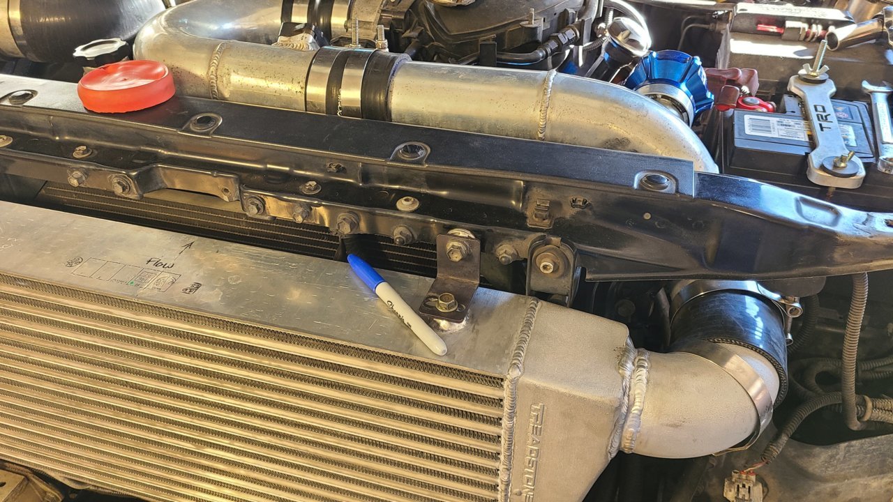

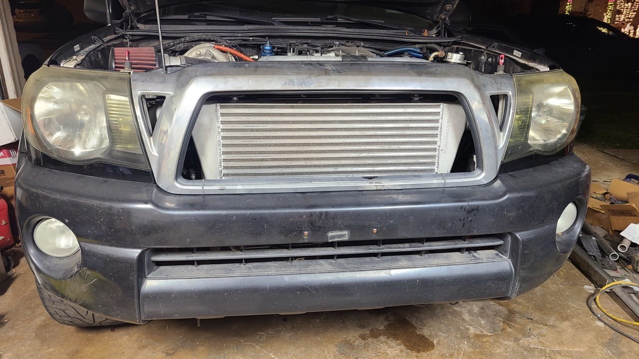

    All finished, with the intercooler project. It has been rewarding to me to do some involved modding and fabricating on my truck. Not glorious by any means, but good to be finished. It also showed me how much more TLC the truck needs. Like a new grill, headlights, rust protection, welded gussets to the frame, and boxing of the frame. Sometimes, I really want to go Mad Max on the truck, with Armor and bumpers. Well see how the future plays out. ;)
    This used to be a silicone 90°. Being this way, there will be less chance of blowing the coupling. By having the silicone connector as a straight.
    Needs a good scrub down. As well a a mesh for the grill. Actually, just needs a new grill. This one is delaminating.

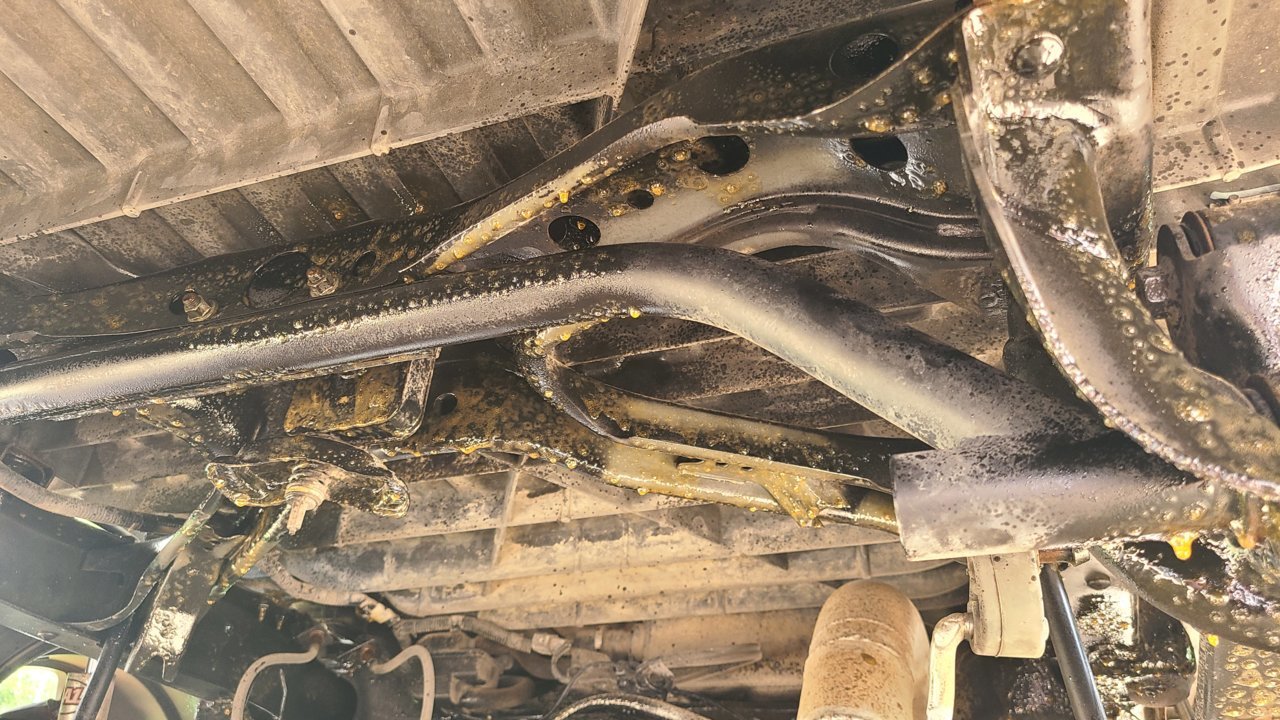

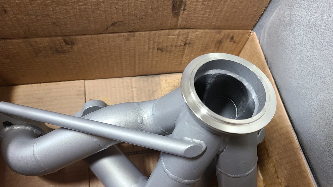

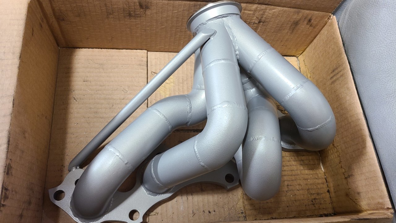

    The ceramic coating is compliments of Polydyn, in Houston. This is their "titanium" color, which was recommended as their best for keeping the heat in for turbo headers. I have used their black in the past with great success.

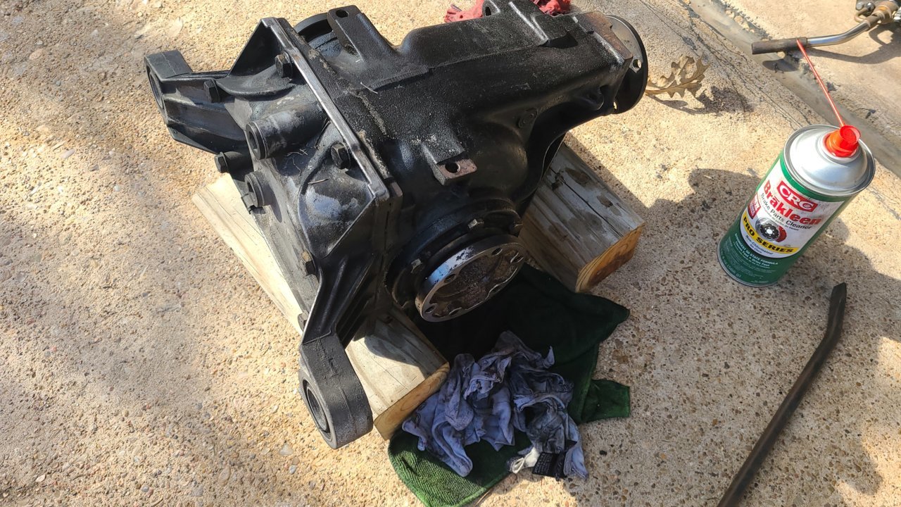

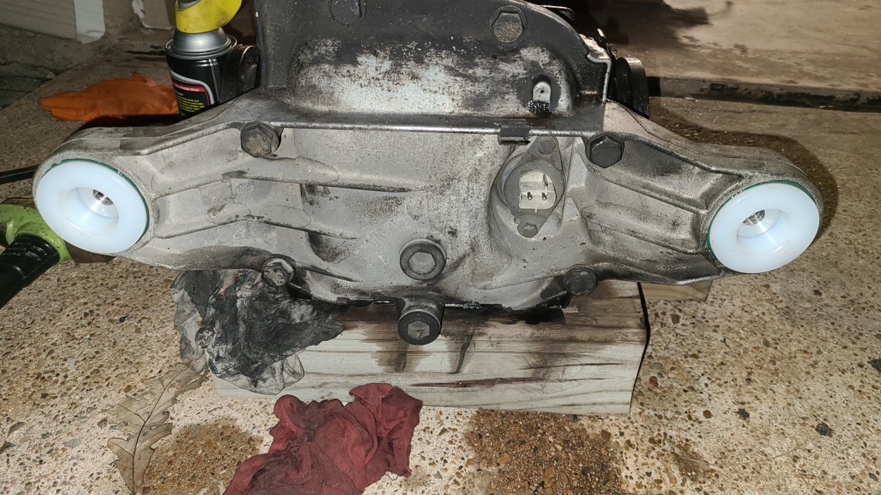

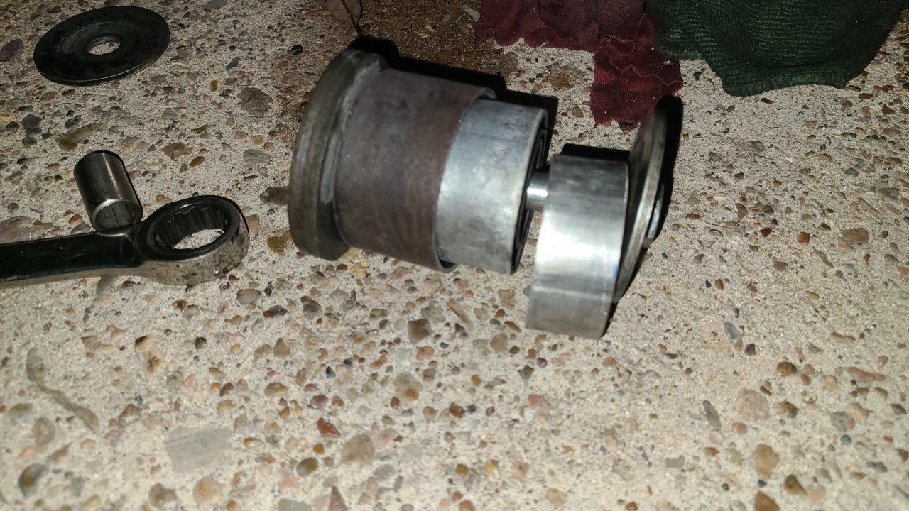

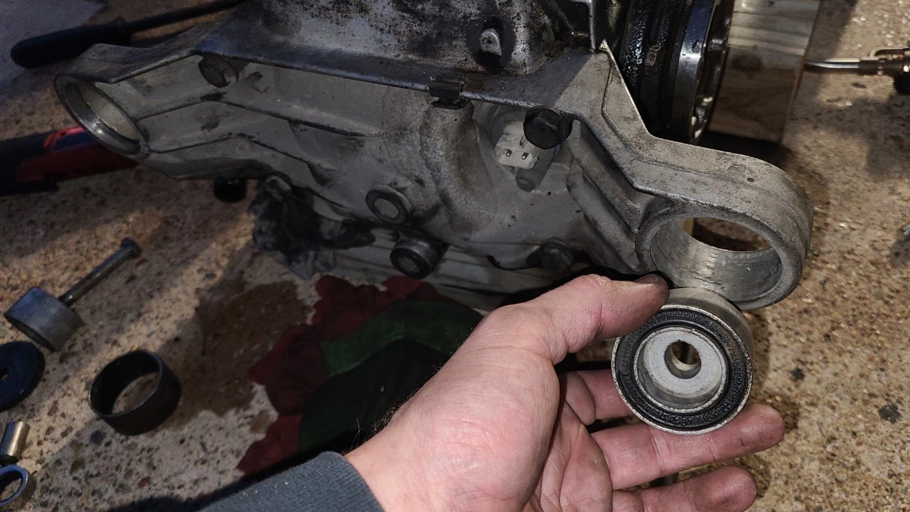

    Most recently, I was able to give some TLC to the Bimmer. I have a lot of rear subframe and differential bushings waiting an appointment. I was able to see two delrin bushings into the diff, but the third was tool blocked due to needing a 14mm x 1.5 pitch tap, open up some threads for a larger bolt upgrade. I wish the axle seals on the Tacoma were as easy as the diff axle seals on the Bimmer.....seriously.
    Had to cobble together a homemade press to get the rear bushings out. Thankfully I had some 2" diameter tubing scrap to help. It was a little too perfect a match but worked.

    Good work, that press in stuff can be a real battle at times. A little ingenuity though and anything’s possible.

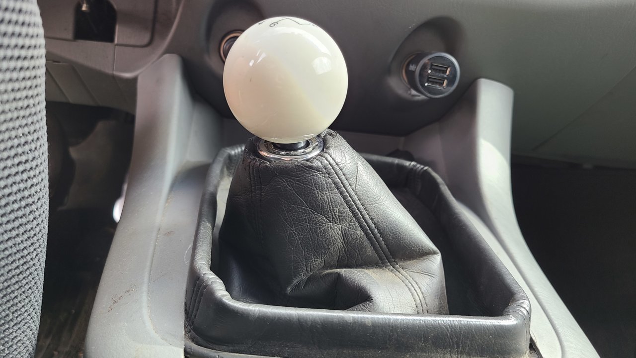

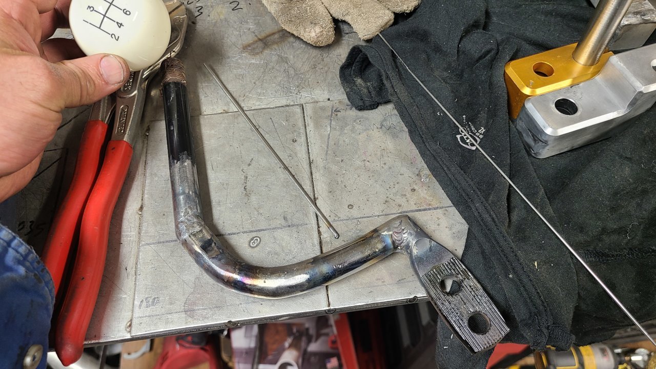

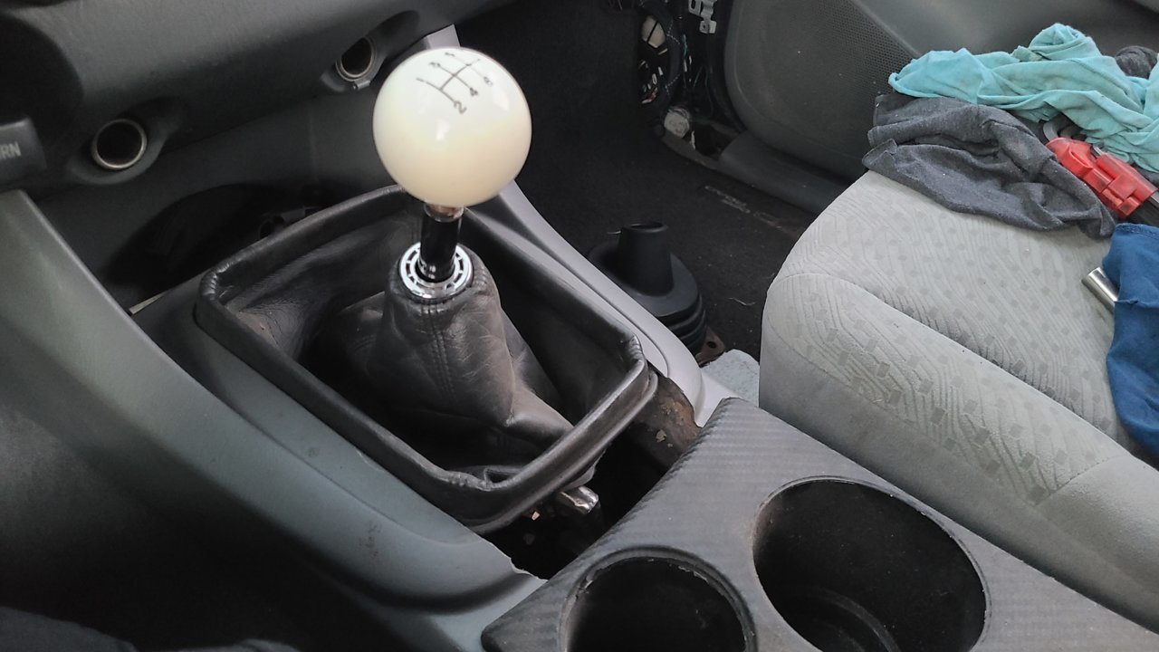

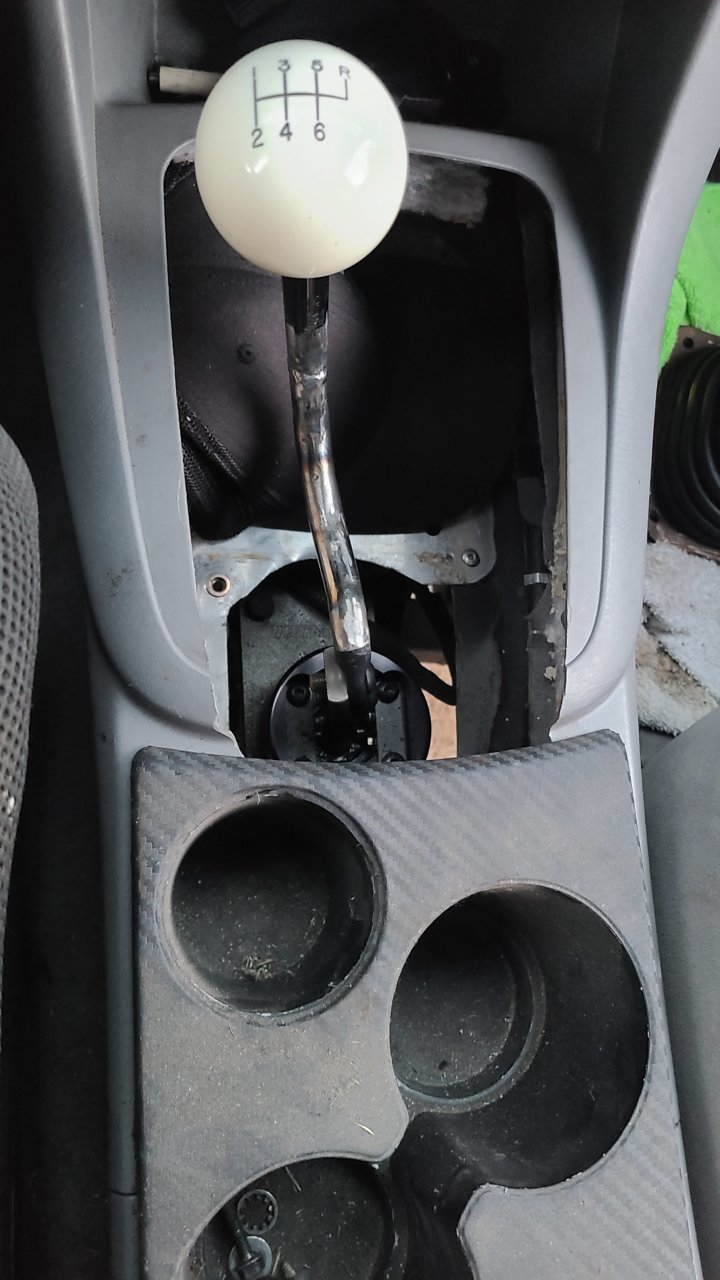

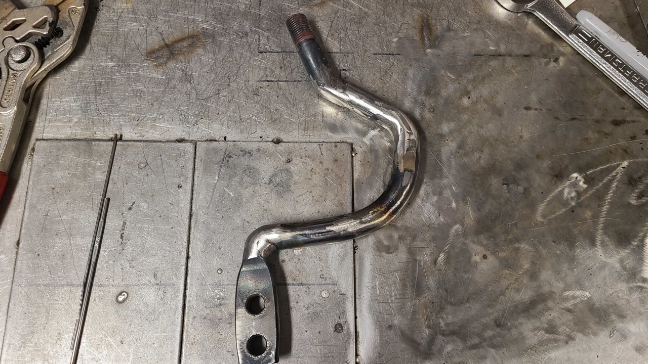

    Have not purchased that Haltech WB2 yet, but did make a new shifter for the truck. Years ago, on the way home from work, I had to pull off of the freeway due to a scare. The shifter was in my hand, the bottom no longer attached to the transmission. I was able to get it working well enough to make it home.
    The design was a bolt through the top of an aluminum adapter, which then the shifter arm was attached to. That bolt sheared off deep below acces. Luckily I had a spare but different brand/style of shifter for the T56.
    I was able to use it to get driving again, but at the sacrifice of the shifter boots, and cup holder. Until this past weekend.
    Looks funky, but works flawlessly. The first iteration. (The gold and silver blocks to the top right, are the adapters of the other shifter.)
    Test the fit an throw, then made a height and angle adjustment.
    This was the final design, prior to paint.
    I have now idea why I waited so long to fix that, so I could have a cup holder again.....

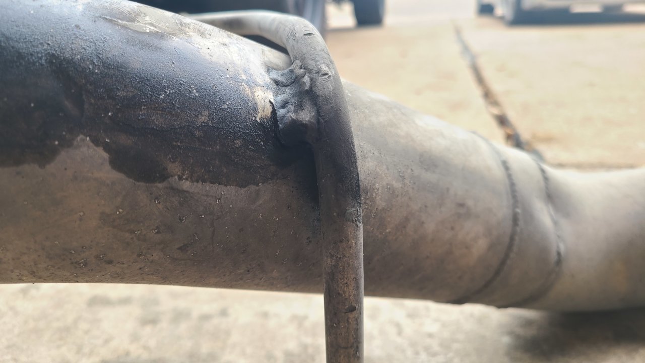

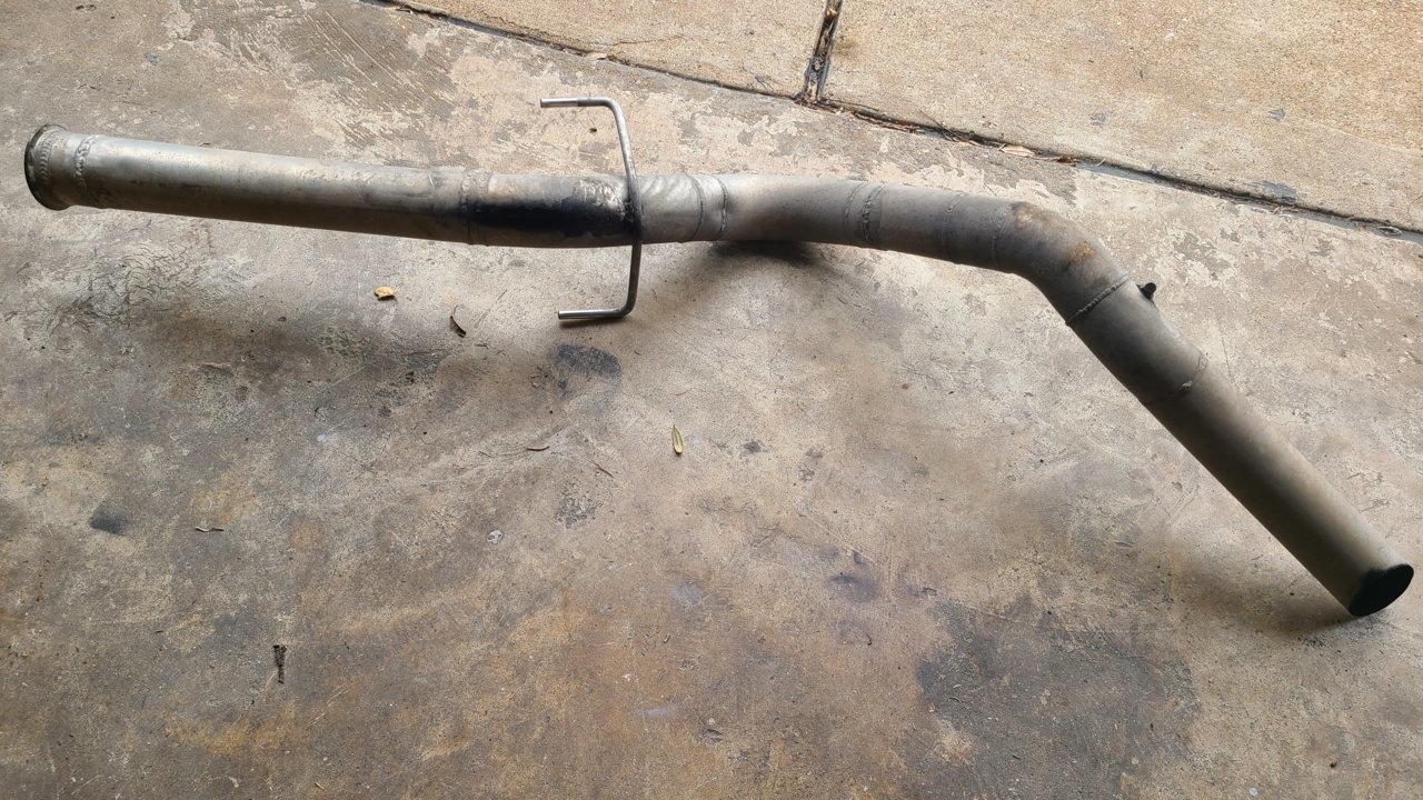

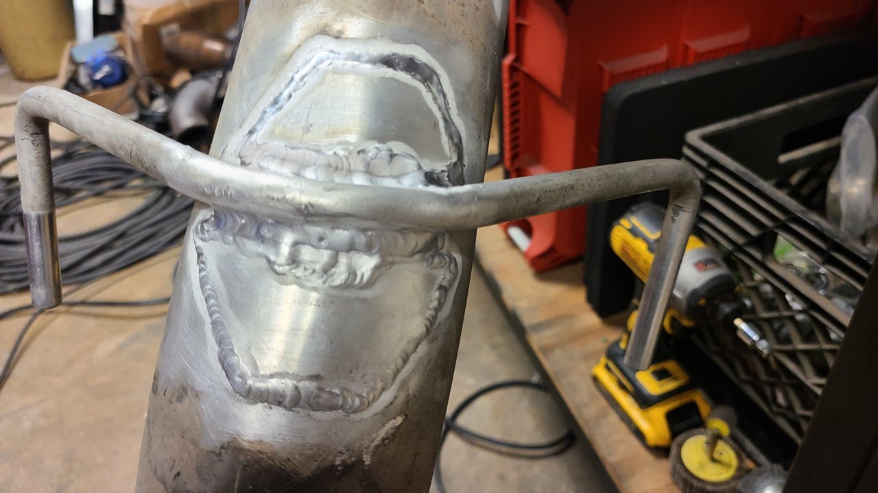

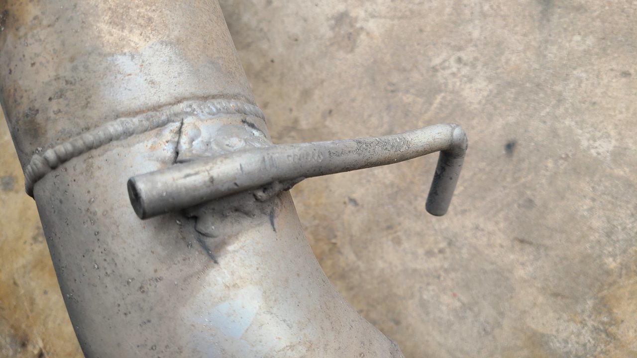

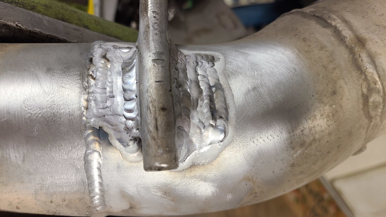

    I also added up some gussets on the aluminum portion of my exhaust. Certain areas are prone to additional stresses and kept cracking. Just need to bite the bullet and make it out of titanium. :D
    This was late February. Used the opportunity to play with my new ESAB 205ic welder. Just get a feel of it with its AC control for aluminum.
    Ha. That reminds me. Still need to add a support rod to the single one.

    Shortened the shifter arm, and man it is nice having this back to a state or "normal".
    Need to figure out a solution for rescuing the plastic that is missing from the photo. As in keeping it removable. A necessity, a in it allows easier access to the T56 shifter hardware.

    Got some turbo exhaust work to do on my truck. Making a little change in the near future. Also need to make another 2TR turbo header. ;)
