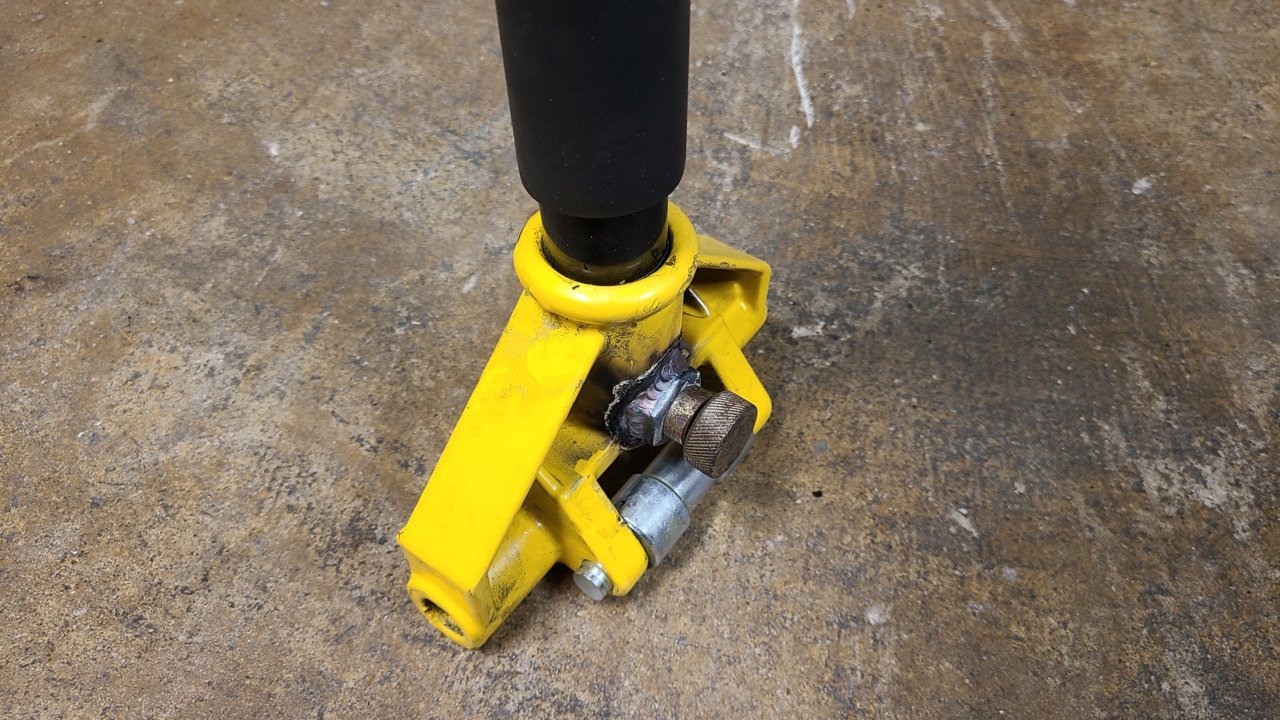

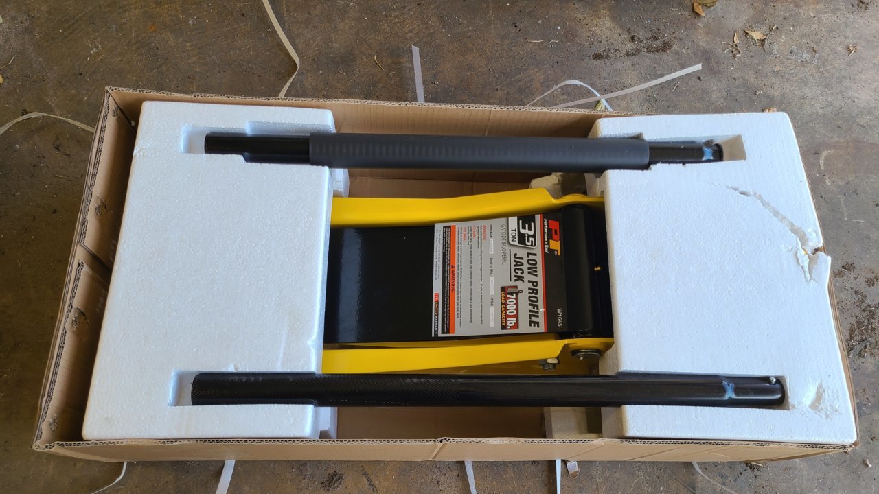

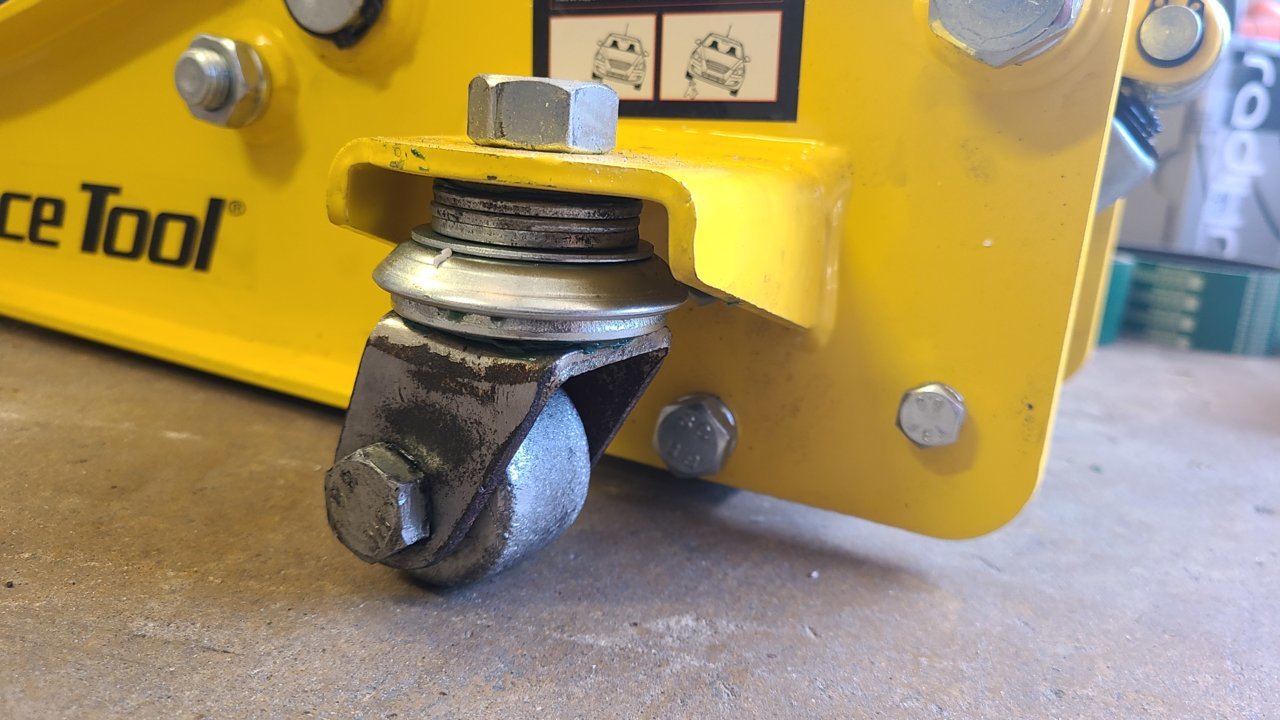

    My old Craftsman jack died a few weeks ago. Ordered one from Summit Racing that was in the budget and of a weight rating I wanted. Should have done more research, but I did not and this is what followed.

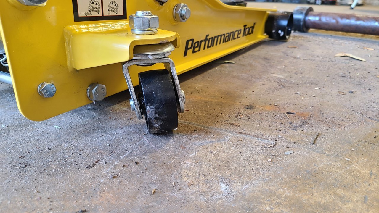

    Received the jack in a near unusable form. Bent castor uprights.
    As well as missing the bolt for locking in the jack handle.
    Needed it to work for an upcoming job, so thankfully I had disassembled the old Craftsman and kept most everything that could be reused. I modified the casters to fit the hardware of the PT brand jack.
    Had to sandwich stack the washers just to have enough clearance to roll the jack. Good enough to get by for the job, but wasn't meant to last.

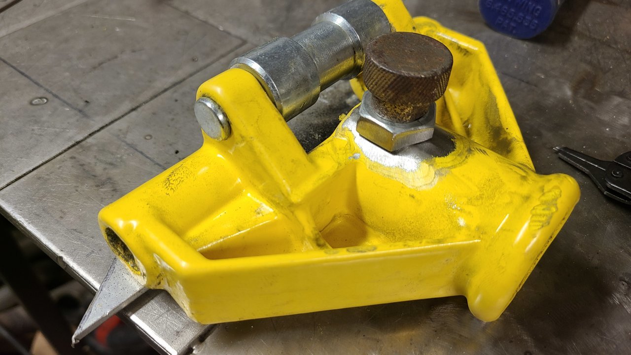

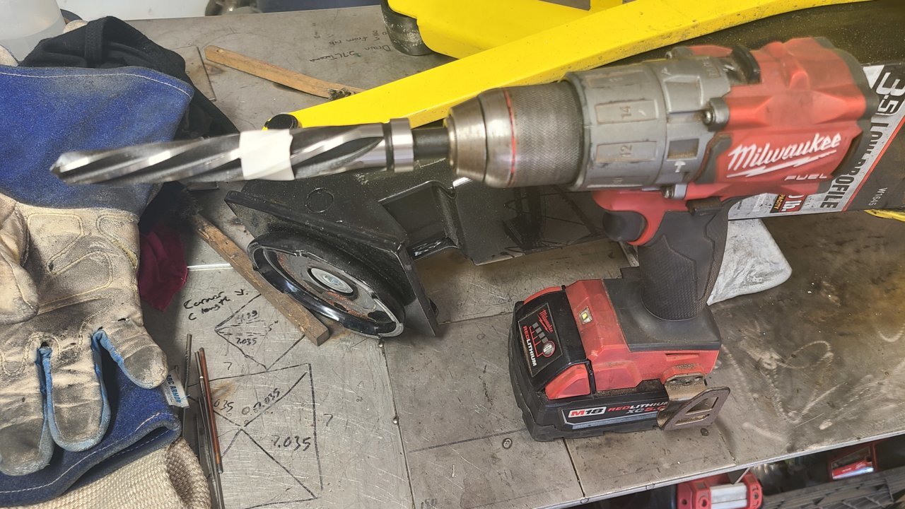

    The original bolt was just a tighten down style. Didn't like it. Didn't have it anyway. So adapted the Craftsman one. Spring loaded, for quick release.

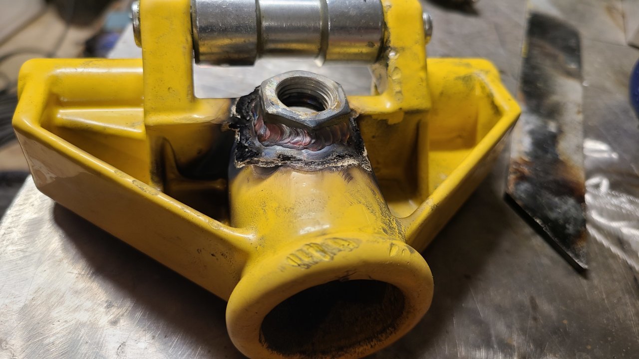

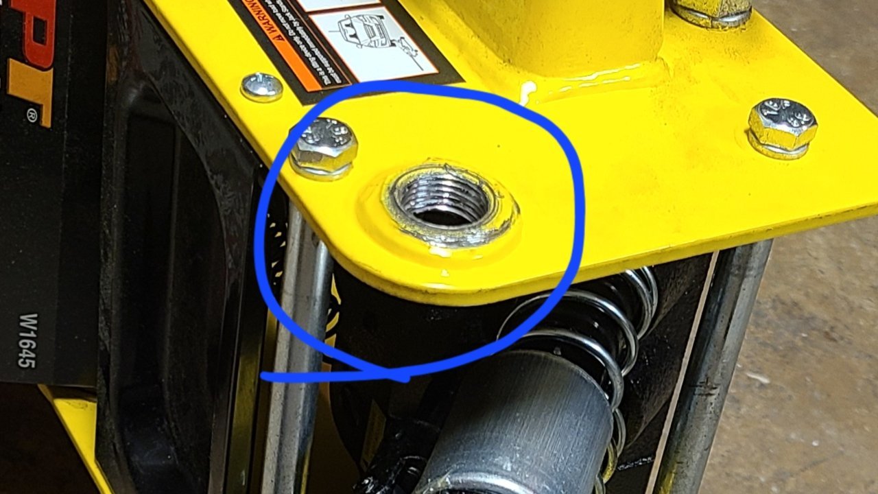

    Much to the nature of this jack's essence, removing that handle assembly created another issue.... one of the bolts on the side decided that it was time to shed its threads...
    Fortunately again. I had kept those similar bolts from the Craftsman, and the shoulder portion was the same as these. However, the thread diameter was larger. So needed a 20mm tap, and purchased a Century Drill Co. reamer. Man that reamer is the shiz!
    Still a little more to do on the Performance (Wanted) Tool jack. Which should be finished up by tonight.
    The moral of this adventure with this brand, in my one and only experience, is that they are junk.
    I would have been better off buying a Daytona from Harbor Freight. Or a much nicer and costly aluminum jack from somewhere else.
    BassAckwards and Athlaos like this.

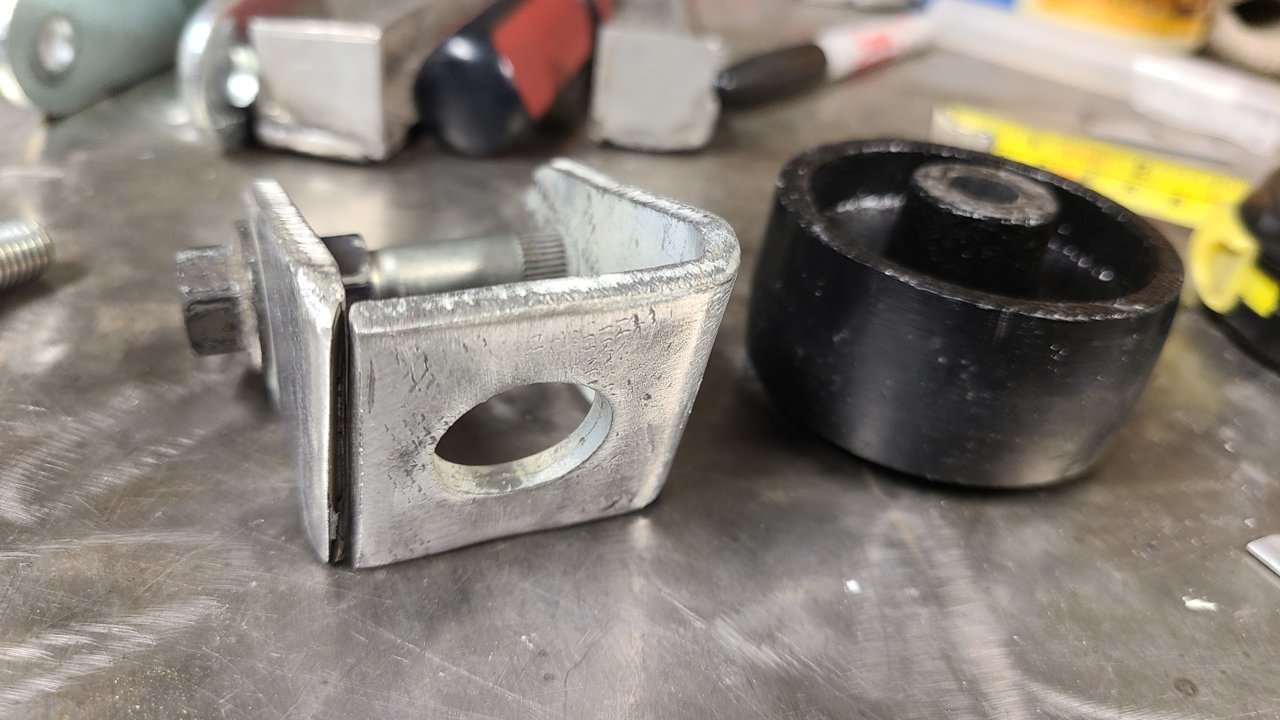

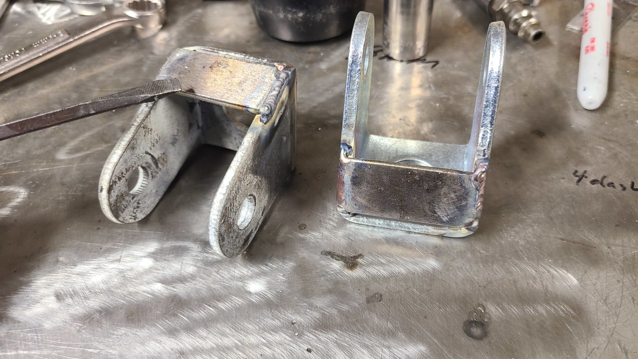

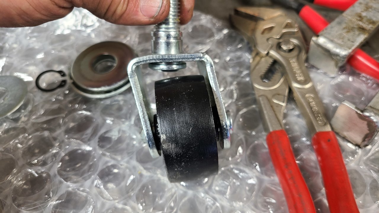

    Bending the caster material back straight was being a pain in the arse. Cut it off and then it bent to my will. Muwahahaha.
    When trying to figure out how to keep it properly spaced, I came across these knurled bolts. Which were from when I did the disk brake kit upgrade on two trucks. Couldn't have found a better bolt for the project. Slight press in required, and solid position.
    Added on some gussets to them both, then back on they went. Better than new.
    Practically a build thread for a jack. Sheesh.
