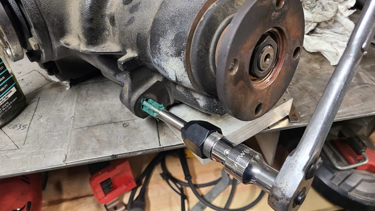

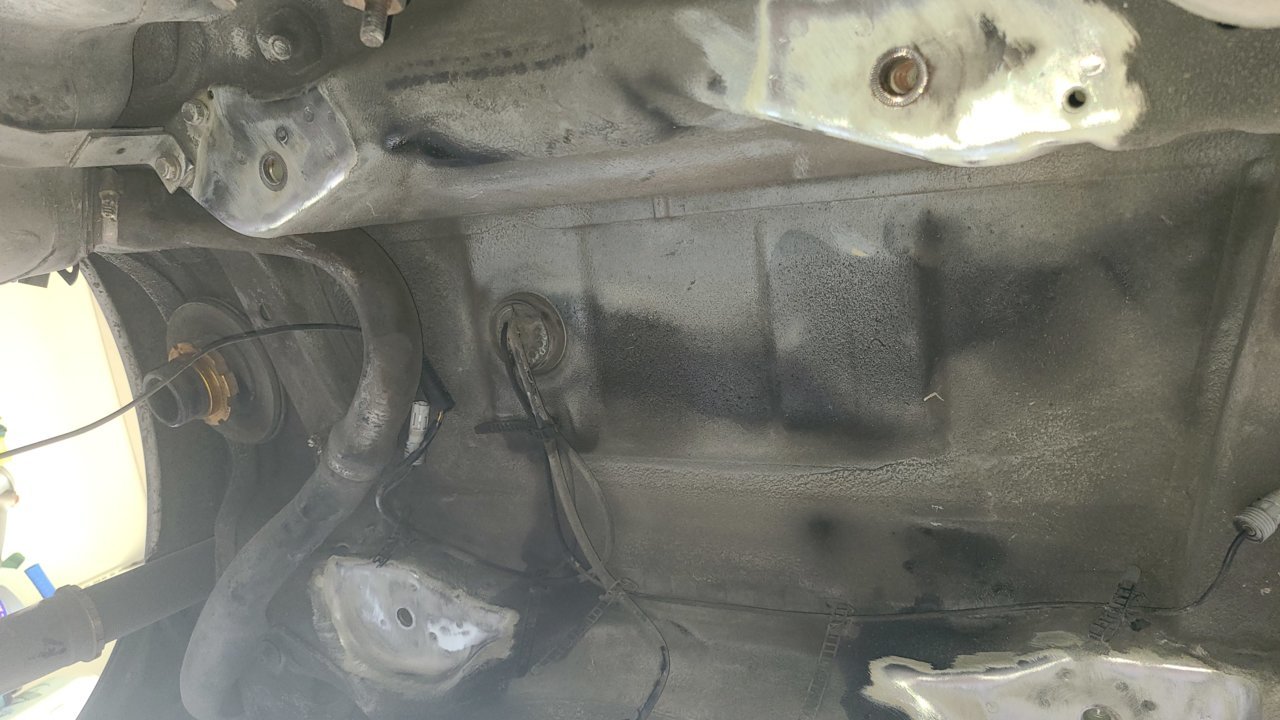

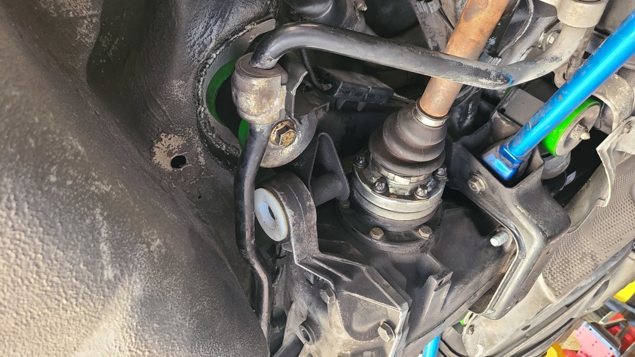

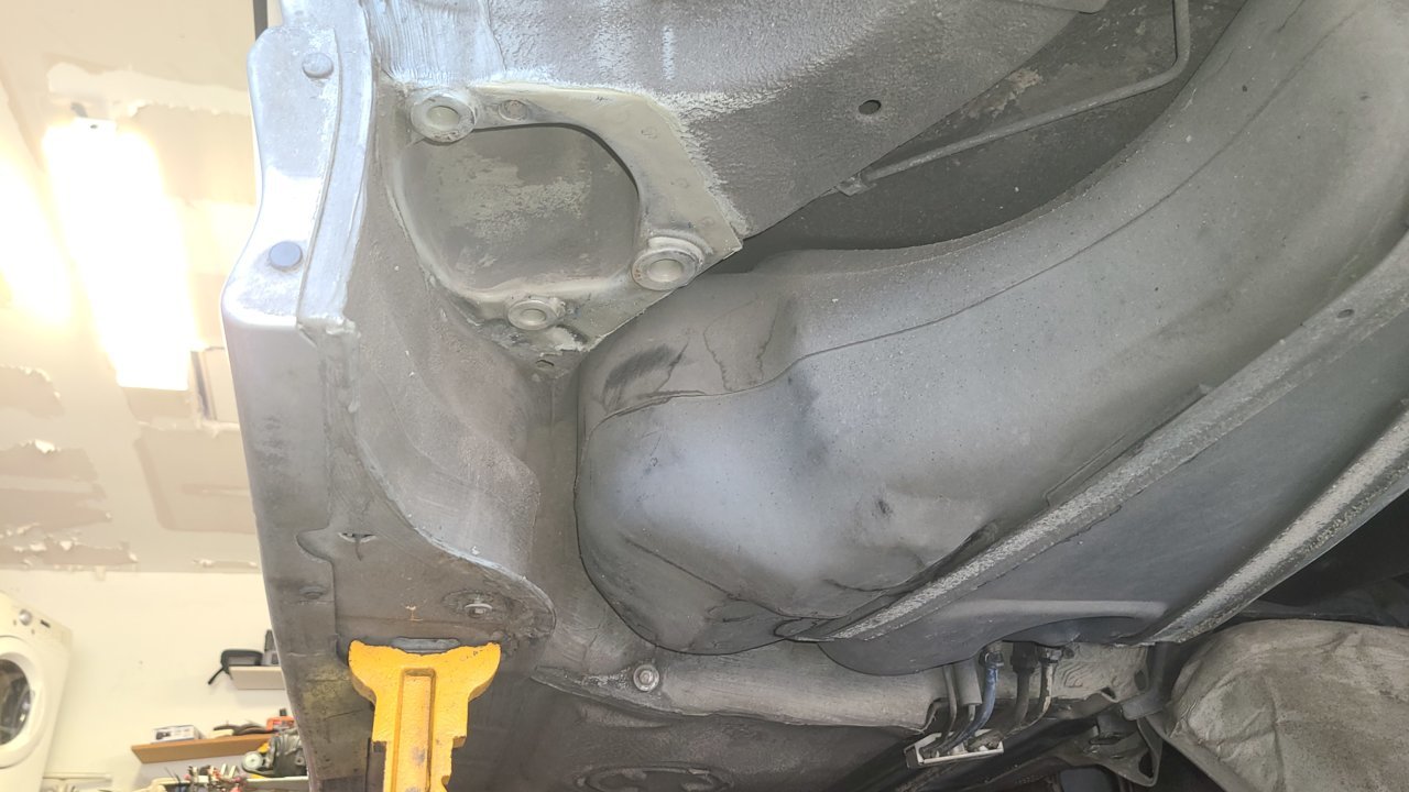

    June gusset month. Welded in chassis gussets on the E36 Bimmer in the beginning of the month. What a chore that was. One part of that project that I really enjoyed was tapping the treads in the rear diff. My Gear Wrench tap set had the perfect adapter to 3/8" ratchet. Super handy! Drill the tapped to an M14x1.5 size.
    Welded in plates in these 6 areas. Then added in poly bushings in the subframe.

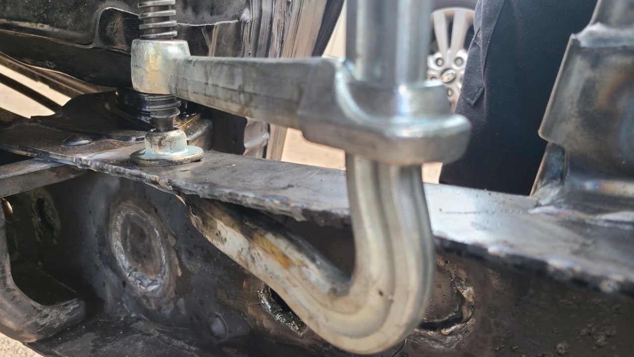

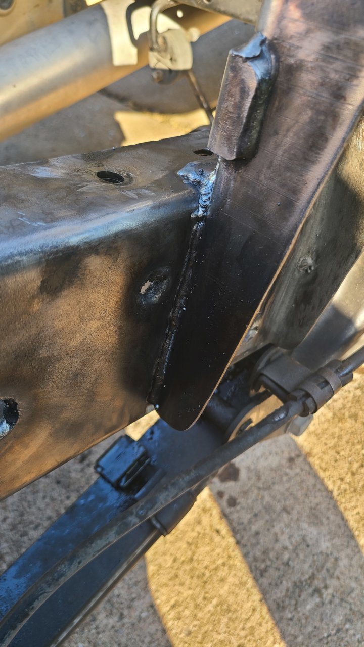

    Still getting my bearings on wire feed welding, but it is getting better. Startin the DMZ kit. Great opportunity to get the flame cleaned up. Removed the upper and lower rivets, then pried the layers apart. Cleaned out the junk built up, sprayed in some CorrosionX HD, clamped it back together and got to fusing things together.
    Primed with Seymour weldable primer, then coated with Steelit weldbale paint. We'll see how that works with welding that gusset on, this afternoon.

    In my opinion, weldable paint is a joke. Clean metal is what you want, always
