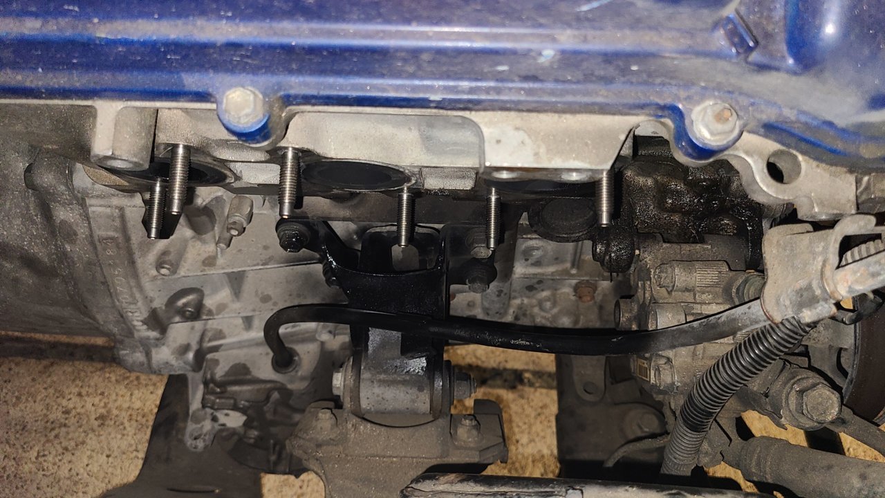

    Cannot even remember how long ago that I had purchased these ARP head-to-header studs. Being in there, it was just finally time. Probably close to 10 years have they been sitting on the shelf. Quick chase of the threads in the head and done. The Gear Wrench ratchet tool for their tap kit helped to make quick work of the process.
    Nothing fancy, but the OEM ones were just far too corroded and needed to be upgraded. The environment next to years of turbo heat, certainly aided in that corrosion.

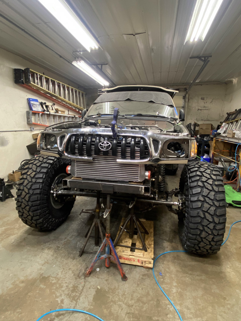

    What is the overall width and height of that IC?

    Torspd Custom Turbo kit [] Borg Warner 9180EFR Turbo [] Haltech Elite 2500 [] TiAL Q BOV [] TiAL V44 Wastegate @ 15psi [] CP Pistons [] CP Carrillo Rods [] ARP Head studs [] ARP Main Studs [] ARP Header - Head Studs [] Ported Heads w/ 1mm oversized valves intake/exhaust [] Brian Crower Forged Stroker Crank [] Darton M.I.D. Sleeved Block [] Kelford Camshafts [] Torspd 160* T-stat mod [] APR Large Fuel Rail [] Walbro 460 LPH E85 Fuel Pump [] FueLab FPR [] APR T56 Conversion Kit [] KP RACING Built T56 [] McLeod Racing Custom Twin Disk Clutch [] One Piece Aluminum Driveshaft [] MGW Shifter [] Custom lowering kit [] Ohlins Front Coilovers [] QA1rear shocks [] Custom Ron Davis Radiator [] Dual SPAL Electric Fans []
    This all should be what you need.
    24W x 12H x 3.5 thick
    Part# 703520-6005. 925 supported power. That should be the proper Garrett Turbo part number. Be thorough though.

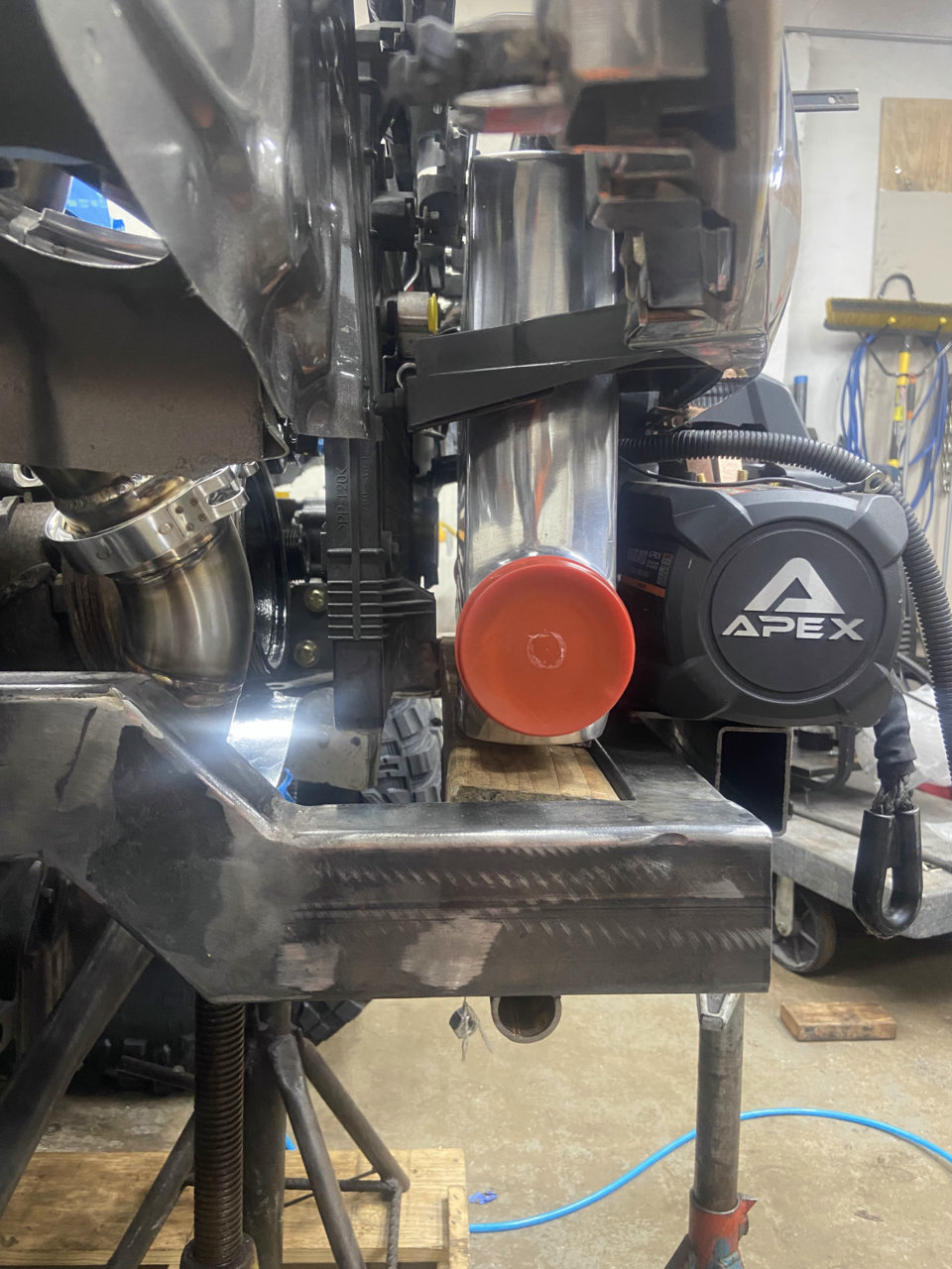

    Im prob gonna switch to a custom made core. Garrett makes nice shit. I got a mushimoto or some shit like that. If I have issues ill prob address with something bigger or w2a. Just wanted to know the size you were able to fit. My steering gear fucks the whole ic thing up bad. This is the biggest I could fit. I 27" overall wide and 12 or 15 high.

    Dayum dude! You need to post up more details in the Turbo BS thread. You've got a heck of a build going on.
    Obvious difference, is that my truck is a wider body. My choice of end tanks were Treadstone Performance. They came with a diverter welded in already, and had the outlets the size that I needed. They added a good few inches to the overall length. Thus requiring me to weld on tight radius cast bends.

    Sweet. Yeah, W a core you have options though. I need a pass side low inlet and a driver high to mid outlet. That is like $1000 for that combo so I’m gonna make when I have time to fine tune things.

    If you have the tools to cut the sheet metal to make your own end tanks, more money saved. I feel like you have the tools.
