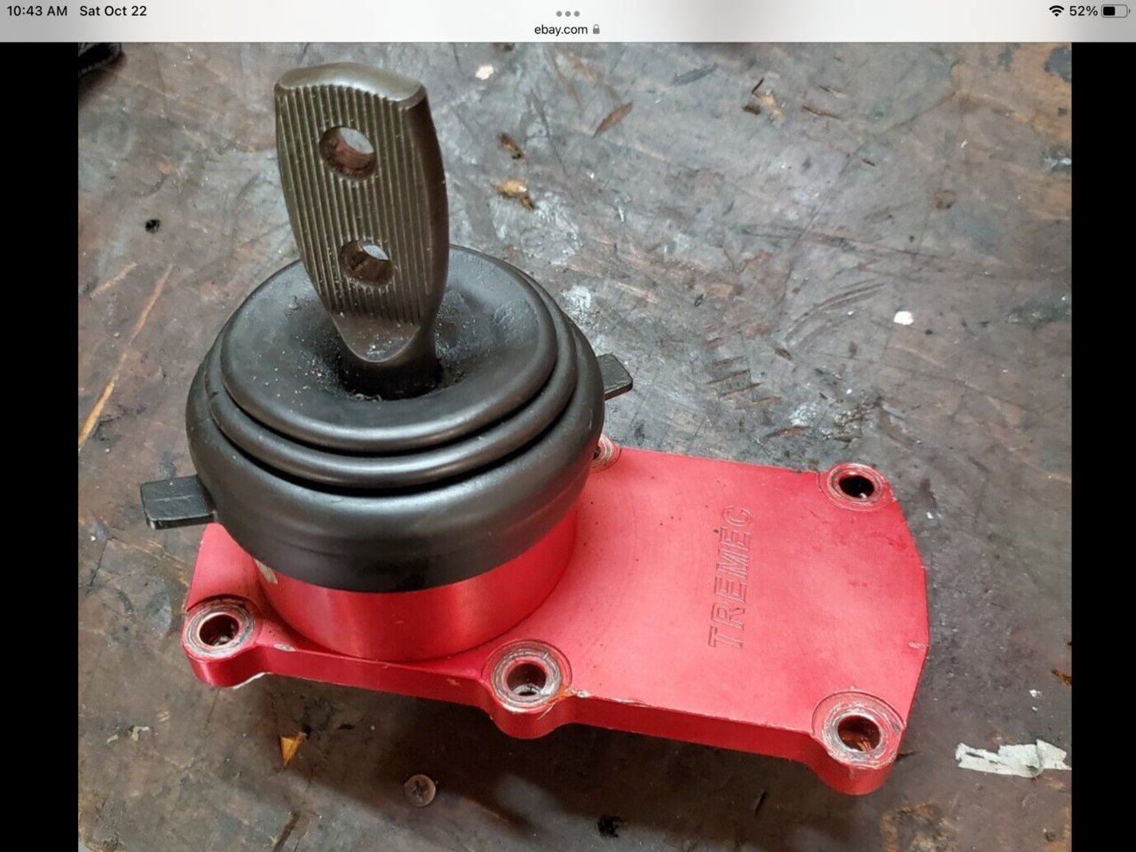

    Tor sir,
    The trans I purchased is a direct fit for a 2nd. Gen. Corvette so that’s why the shifter is offset. The rear most shifter is easily purchased & replaced and from what I understand. Here’s one for $70.
    But I was wondering if shifter for the center location would fit better? :notsure:

    It has to be in the center. Unless you're really good at making linkages. And it fits in the tunnel being offset to the side.

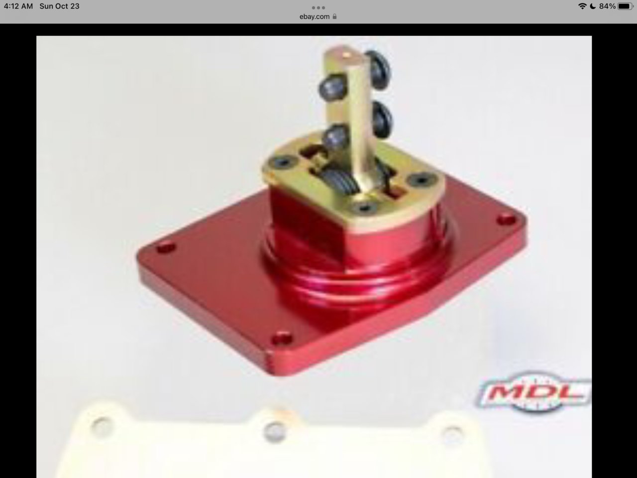

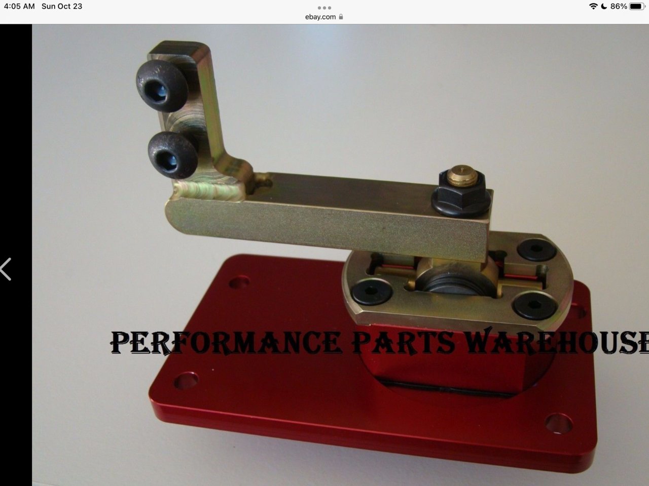

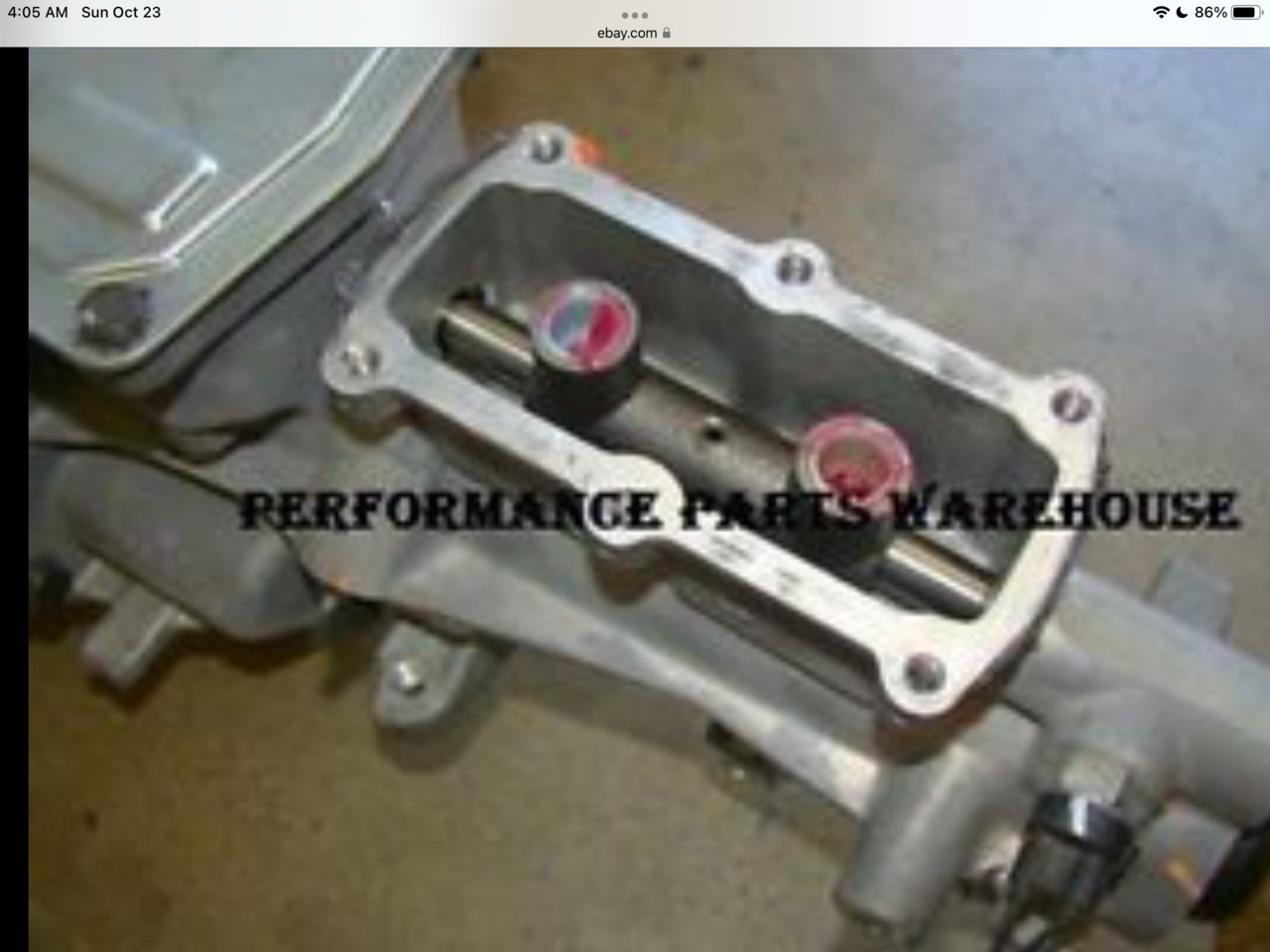

    Here’s a photo of the two rear locations on the trans.
    Then other shifters that can be purchased.
    Then one for the middle location.
  10. Oct 23, 2022 at 11:08 AM
    #8830
    Torspd
    Torspd [OP] Tor-nication
    Sep 18, 2009
    #22958
    26,320
    Tor
    The Great America!
    MMVI 4.4L 4x4 Access Cab
    Torspd Custom Turbo kit [] Borg Warner 9180EFR Turbo [] Haltech Elite 2500 [] TiAL Q BOV [] TiAL V44 Wastegate @ 15psi [] CP Pistons [] CP Carrillo Rods [] ARP Head studs [] ARP Main Studs [] ARP Header - Head Studs [] Ported Heads w/ 1mm oversized valves intake/exhaust [] Brian Crower Forged Stroker Crank [] Darton M.I.D. Sleeved Block [] Kelford Camshafts [] Torspd 160* T-stat mod [] APR Large Fuel Rail [] Walbro 460 LPH E85 Fuel Pump [] FueLab FPR [] APR T56 Conversion Kit [] KP RACING Built T56 [] McLeod Racing Custom Twin Disk Clutch [] One Piece Aluminum Driveshaft [] MGW Shifter [] Custom lowering kit [] Ohlins Front Coilovers [] QA1rear shocks [] Custom Ron Davis Radiator [] Dual SPAL Electric Fans []
    This one would most likely be the needed one.

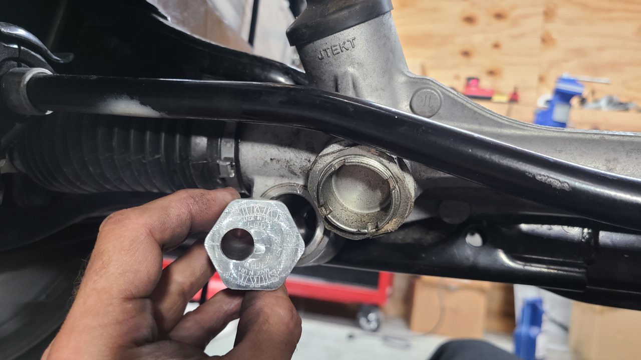

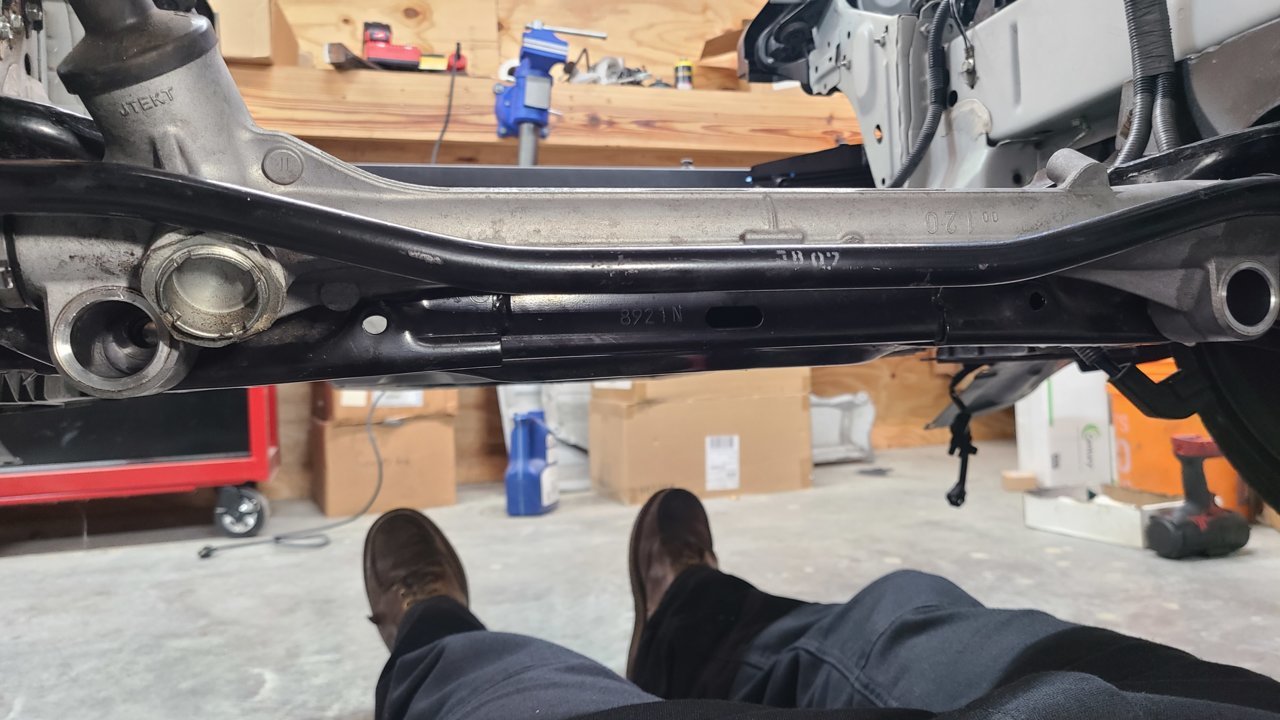

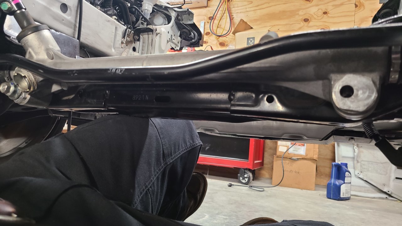

    Made a tad bit of progress on the BRZ swap. Every day has been super busy.
    The headers from SIKKY, were designed to fit this car with this kit. Others may, but I have no knowledge on that point.
    For them to fit however, due to such tight space constraints, the steering rack needs to be shifted to the right. To simplify this task, they include with their headers some machined eccentric bushings, made out of aluminum. Very nice pieces.
    Used a large C-clamp and a 36mm socket, to press out the OEM steering bushings. Piece of cake. Some light tapping with a dead blow, and ghe new bushings went right in.
