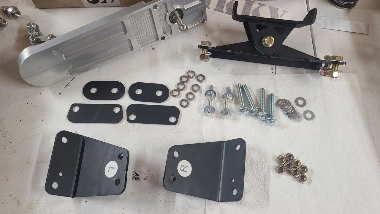

    Getting back into the BRZ LS3 build. Assembling parts for the transmisison cross-member, and about to mount the brackets to the chassis. More photos to come.

    Mmmmm. CNC...

    Yeah, that shifter adapter is a fine piece of CNC craftsmanship. Mmm

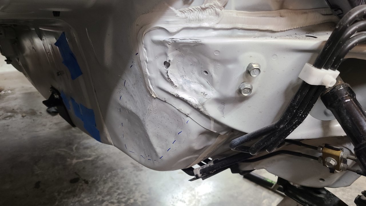

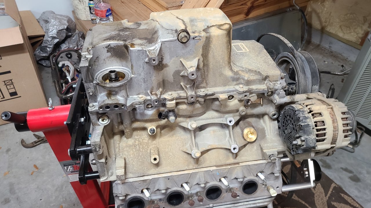

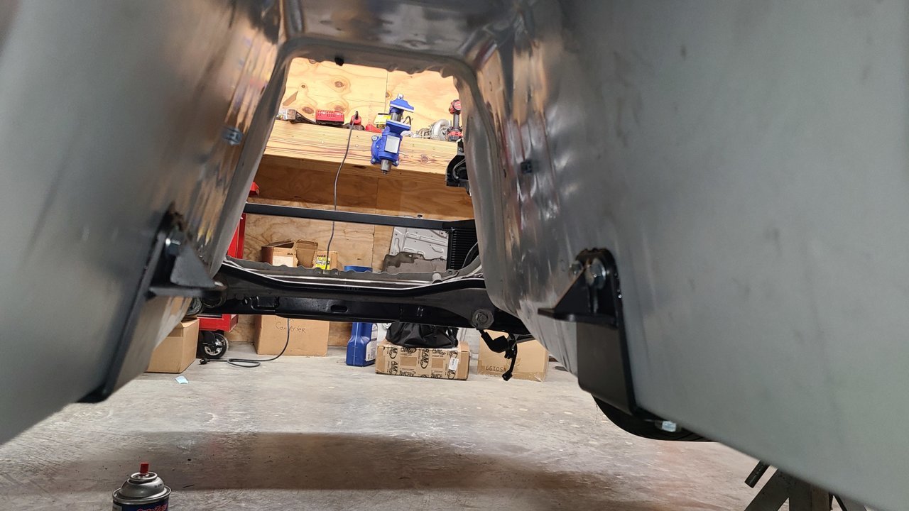

    Going a little extra length with the transmission brackets. Holes drilled, and silicone on both sides of the chassis to prevent water intrusion "as much as possible."
    Because street car.

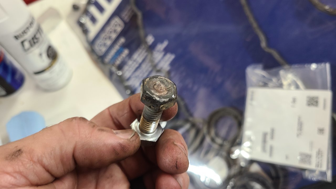

    Removed the OEM oil cooler and installed an ICT Billet plug on the side of the block. Had to "make" a 17mm allen socket.
    Need to tack it together so I can get a tad more torque, but otherwise money saved from not having to buy a new tool.

    If you know anyone with an old aircooled VW they probably would have a proper male 17mm socket

    Unfortunately I don't. This only took a sec to get together though, and since it doesn't require much torque, it does the job good enough.

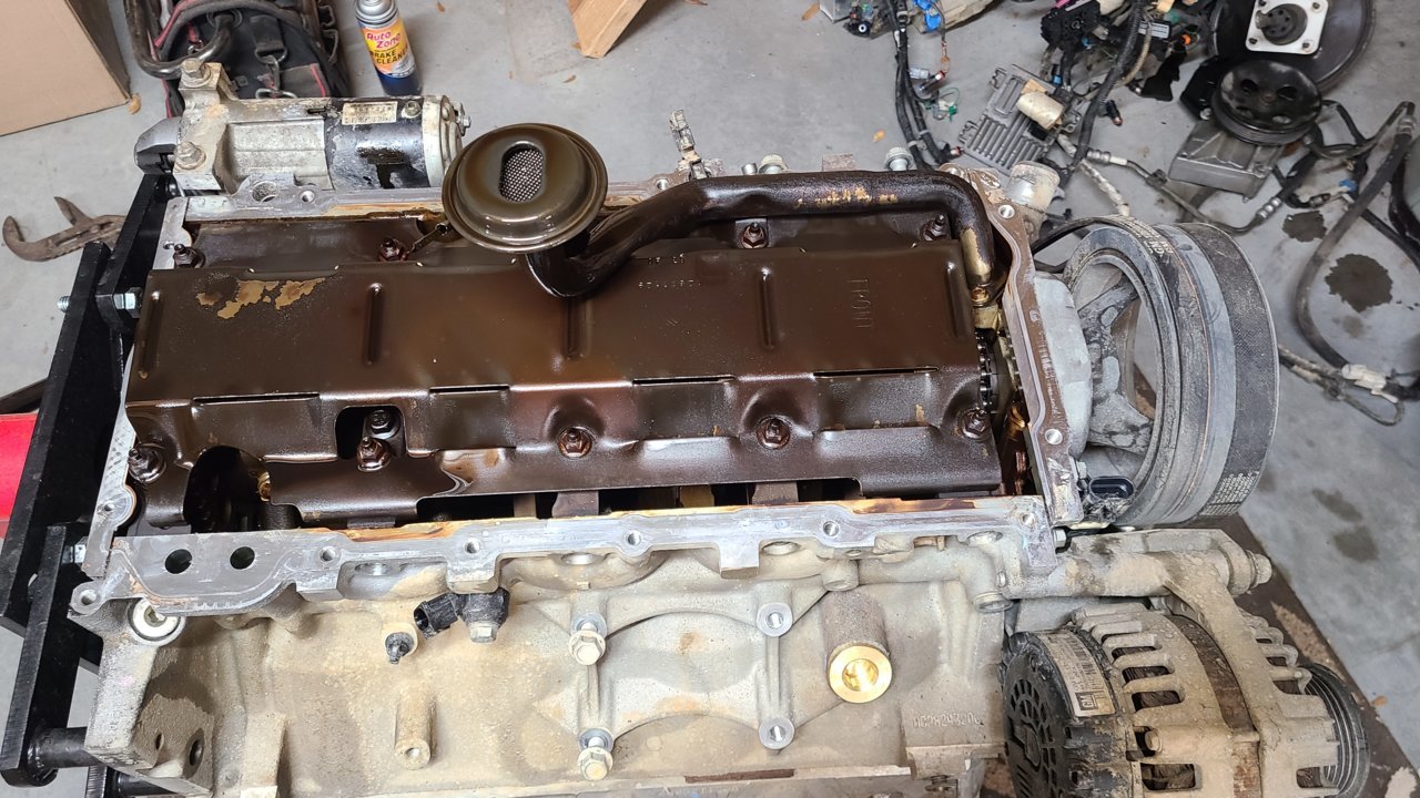

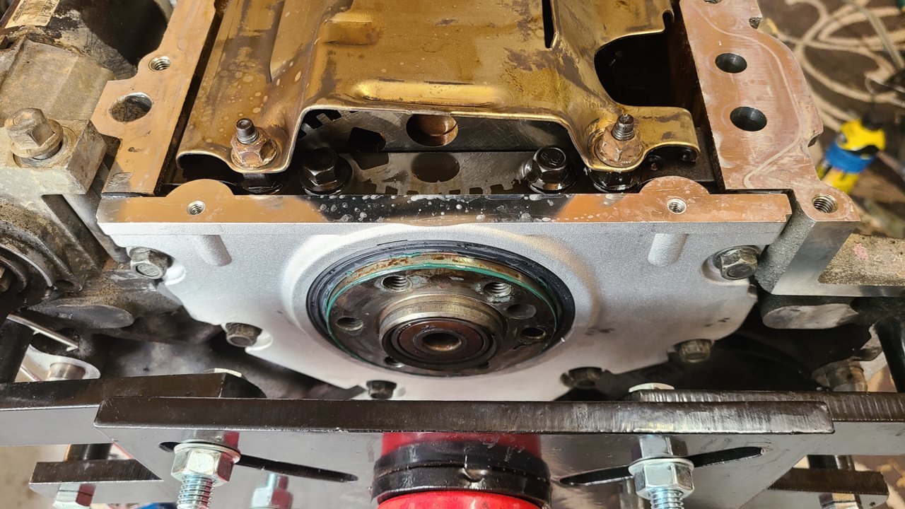

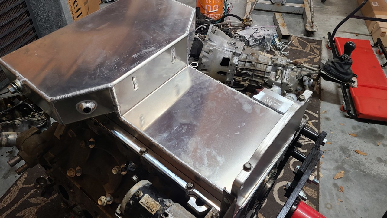

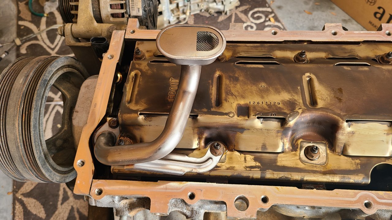

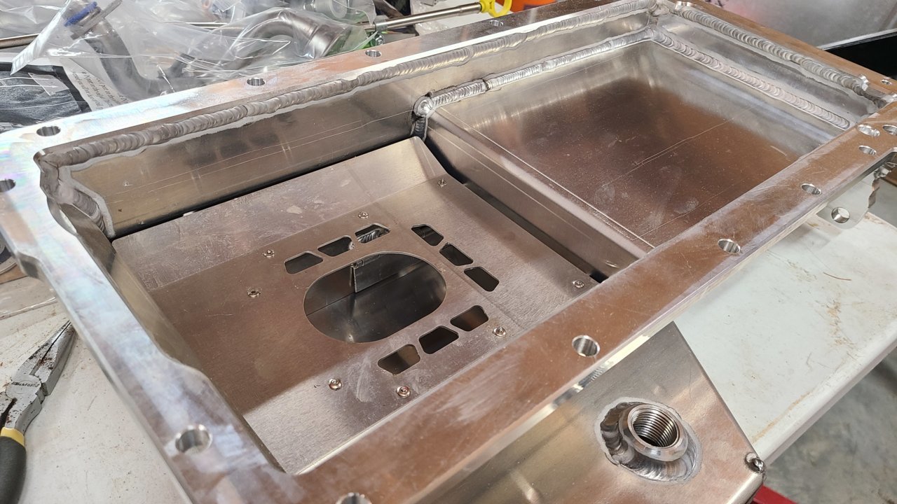

    Got some tedious basic checks done, on the engine. A few more parts ordered. Rear main seal plate w/seal replaced. New oil pan installed, with the oil filter relocation adapter mounted.
    Out with the old...
    In with the new...
    Hinged baffles. Mmm
    Basically gave everything a light oiling, and rotated the engine to lube things up. Put the pan on because I didn't want all of that oil to spill out.
    Hoping to do the compression test on it come Tuesday.

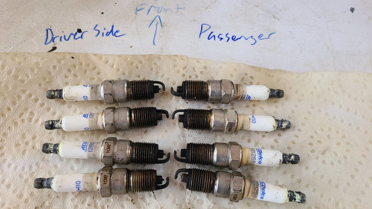

    Forgot to add this photo. Had to give the ole lady a deep tissue massage.
    Also, after seeing the sparks plugs, it was a shock to have seen that the engine ran so well, prior to being pulled for the transplant. Prior owner wasn't much for maintenance, as it shows.

    Love the plugs.

    Loved them long time.

    Hell they look Ok to me. :rolleyes: What a few still have the electrodes when they all are missing then it’s time to change them. :rofl:
