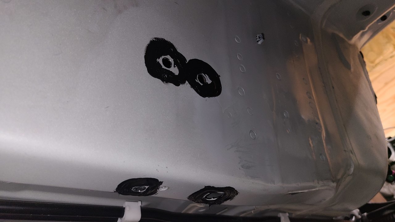

    Yes
    Just an fyi amigo but silicone is not used in automotive applications because it traps and sweats moisture which actually causes rust. Urethane ie: auto seam sealer or auto glass adhesive is the is the better sealant to use because it does not do that & it is paintable etc. The one down side to urethane like automotive seam sealer is that you have to dry tool it vs being able to use the old wet finger or wet rag trick.

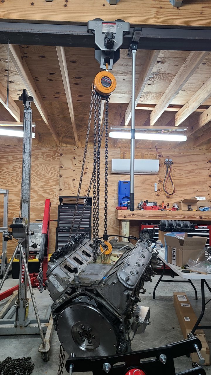

    On the chain fall for the compression test. Handy garage.
    Considering it only has the oil in it that I poured on it from the underside, these numbers are GTG.

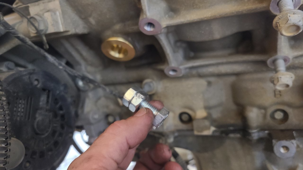

    Not much to report on the BRZ swap. Encountered a few hurdles.
    1: How to plug the original oil dip stick hole.
    2: Needed a new TOB feed line adapter fitting. The one that came with the kit, wouldn't fit with the o-rings on. Come to find out that the O-ring grooves were not machined down enough. New one on order. That prevents the transmission from being bolted to the engine.
