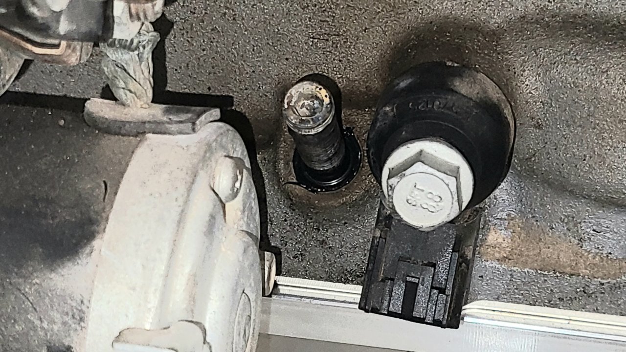

    pfft…one easy answer for all three = JB Weld

    Honestly, that is not out of the question. My hope was to have it able to be returnable-to-stock. That has proved not to be an option now. I could weld it. JB weld would be even easier than threading in the 1/8 NPT plug. Orrrrr, I could double up and JB weld in the 1/8 NPT plug. I wonder......

    I'll find out tomorrow what the best course is. I am a huge JB fan.

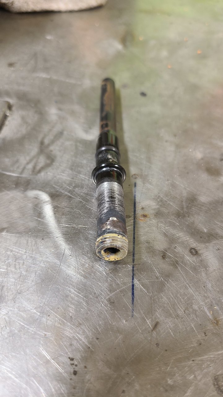

    Solved the dip stick problem. Easy peezy.
    Cut the OEM dipstick tube, and welded the NPT plug onto it. All around the best solution.

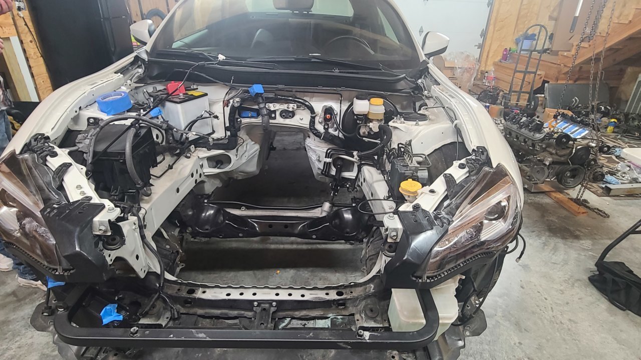

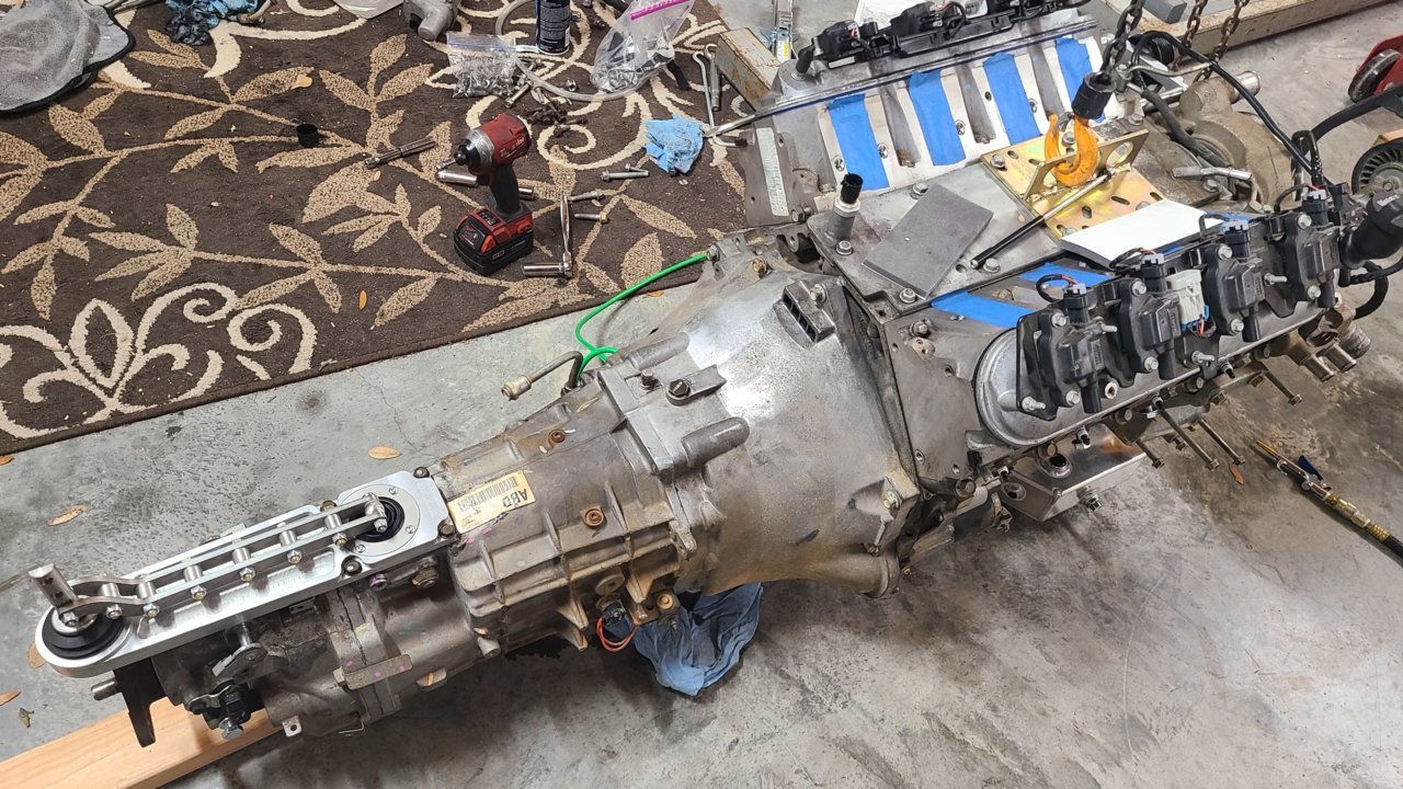

    @Lucario Runner 's built engine swap was a success. A refinement of his tune for the camshafts, and it should really be nice and powerful!
    That being completed means that I am back to the LS BRZ swap.

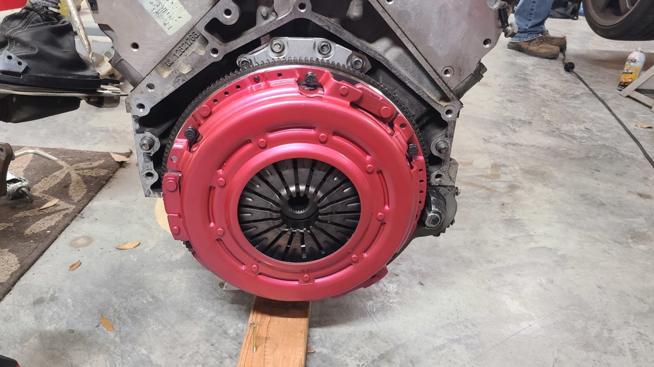

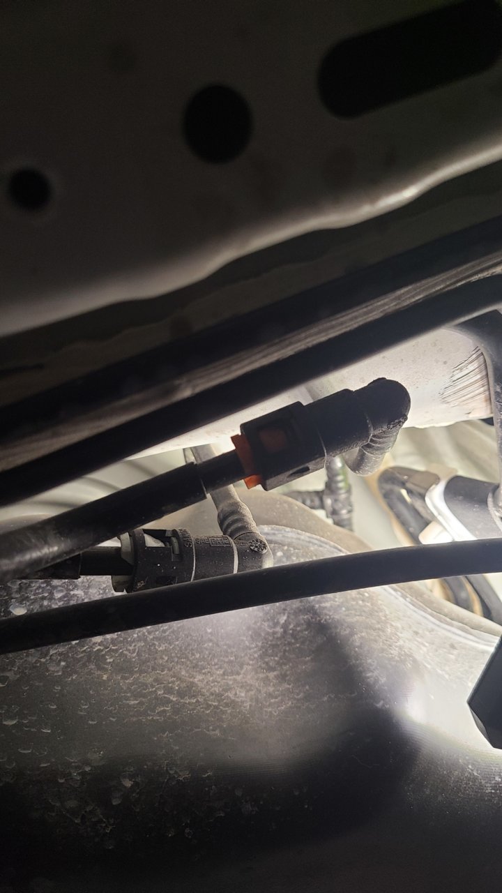

    Mated the engine to the transmission. Then shifted to the fuel system. It will be easier to run the new fuel line, which replaces the dual lines, if I do that before the transmission is in place. The OEM pump splits into a "Y" right out of the tank. Then two fuel lines head to the engine bay.

    20221208_175918.jpg The owner is going to order a drop in fuel pump upgrade from 86Speed. That will handle the larger fuel requirements of the LS.

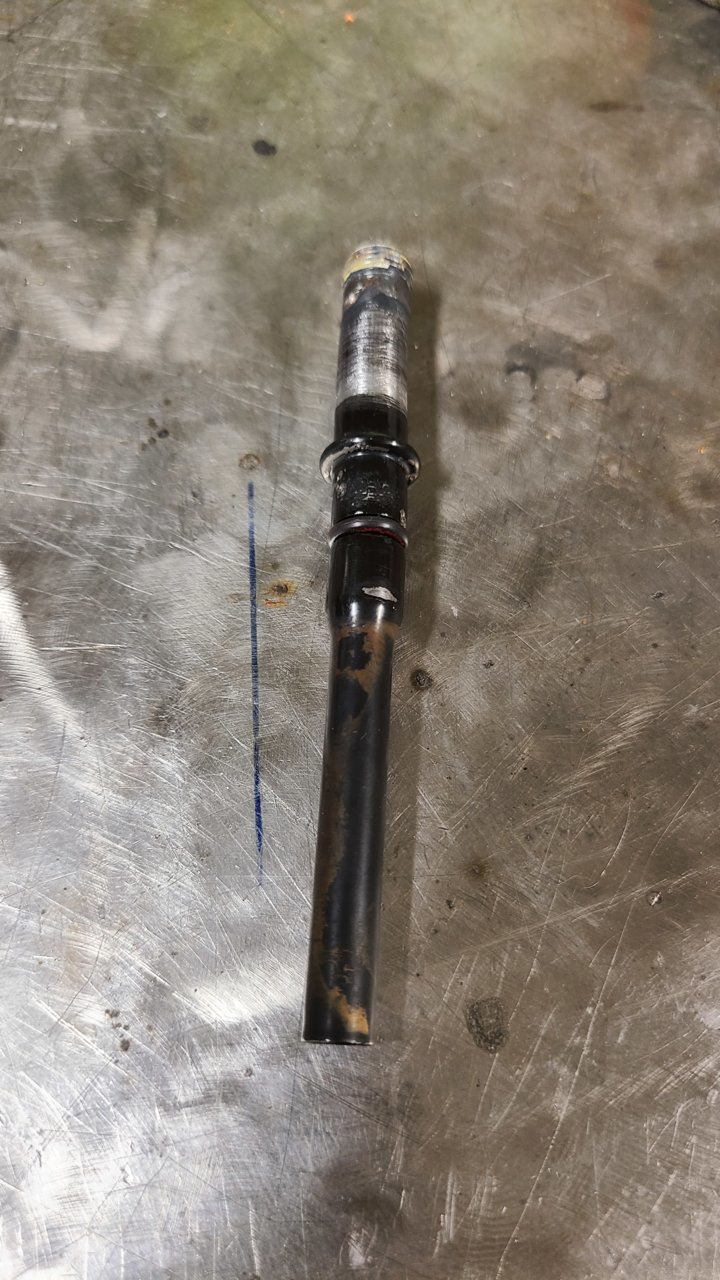

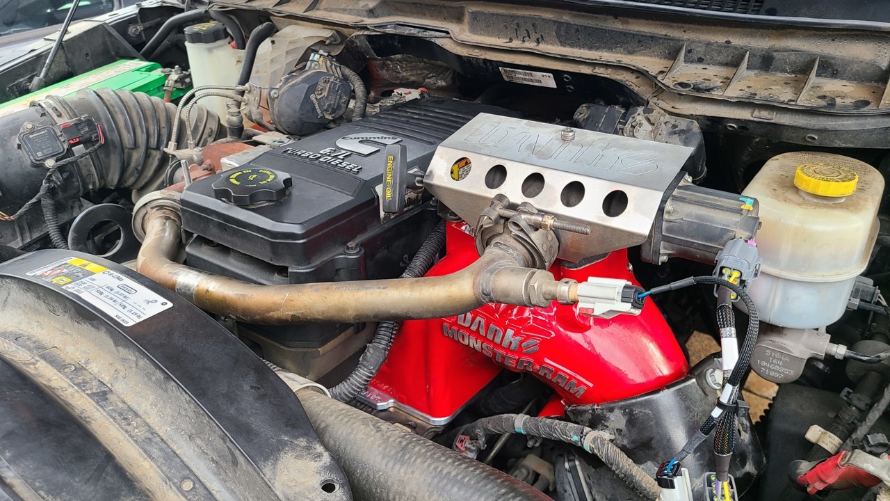

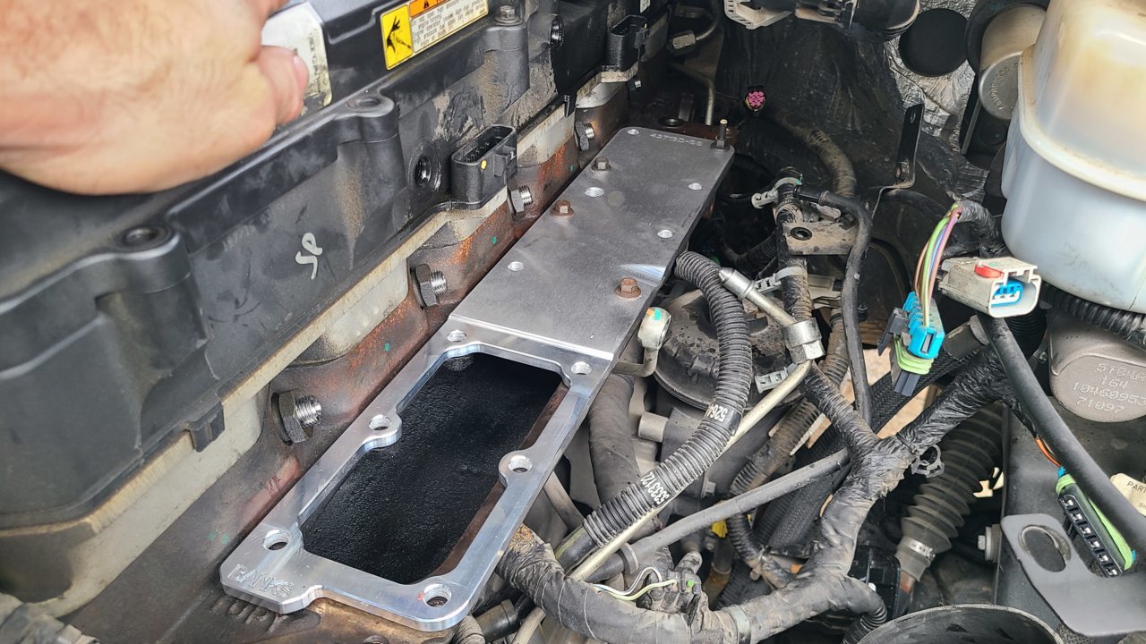

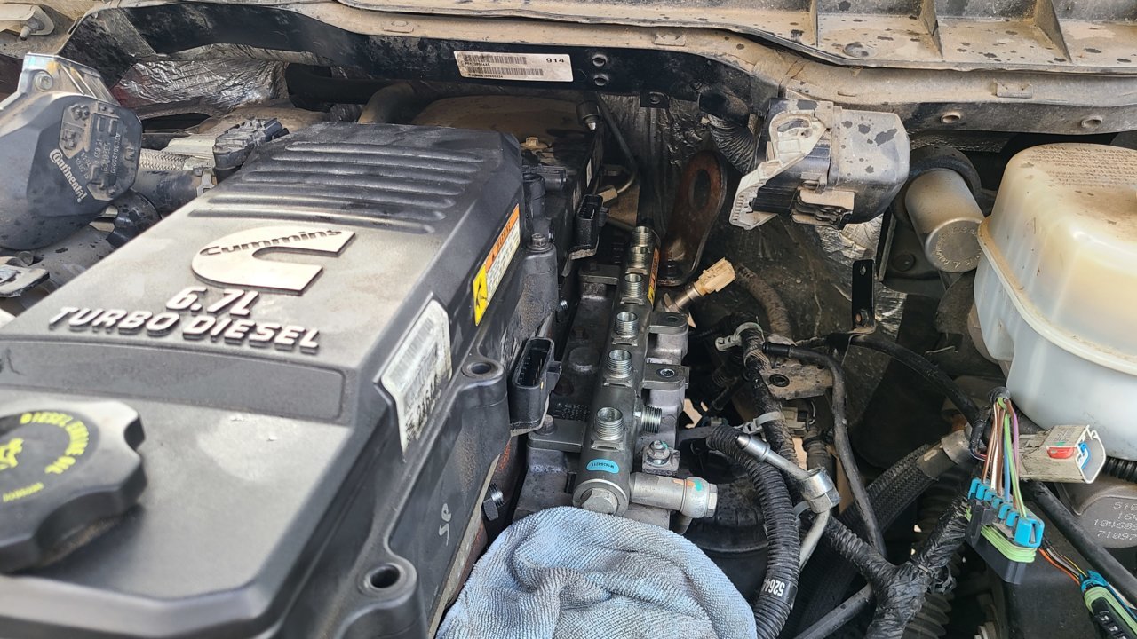

    Looks like a 6.7 l Cummings... Presumably in a newer ram 2500-3500... But I too, want more specifics

    installing a new intake manifold.

    needs some emissions delete yo...

    Just lost track between his Taco, the pictures of the LS and now the Cummins

    I've a knack for being confusing. Lol. I am LS swapping a friend's 2019 Subaru BRZ.
