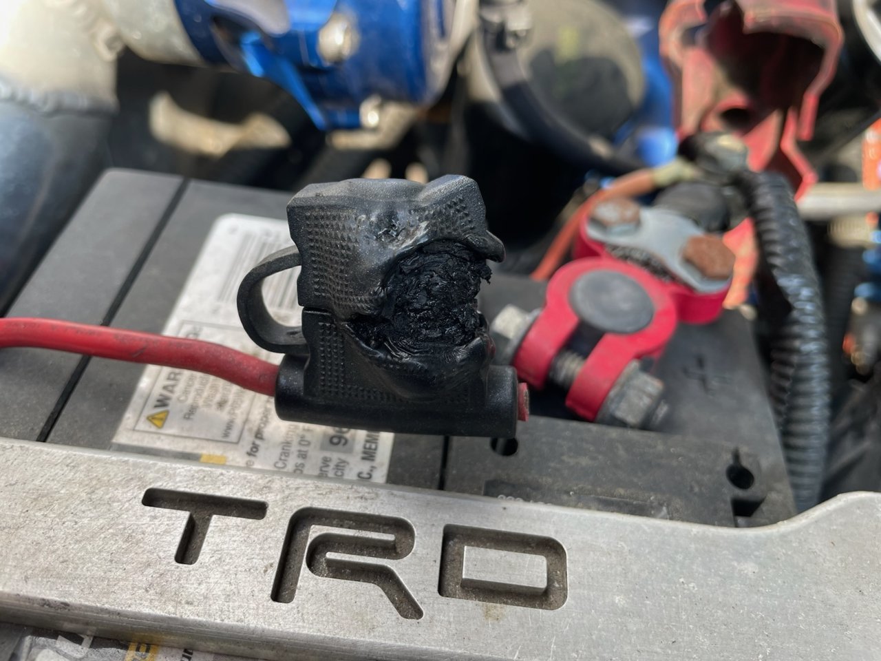

    I melted a few of those when I had efans.

    Ever find your reason? It is weird. The 30 amp fuse didn't blow. Just melted the whole holder. It has slowly been deforming until the picture above. The other fuse holder I had already swapped. To a Littlefuse brand. Slightly smaller gauge, but has been holding up just fine for a couple of years already.

    Must be an under hood heat issue. The connections must have too high resistance, melting before the fuse pops. Only did it when it was triple digits outside.

    What size is that wire? It might just be the photo, but it looks small for 30 amps.
    Either way I would suspect that fuse holder is not rated for 30 amps, unless you think that fuse holder was touching something else that was hot.

    The wiring was 12 or 10 gauge. The one next to it is of 14 gauge, which came with the 30 amp fuse in it. Without looking at a chart, I would think that 30 amps would require minimum 12 gauge? Regardless, the new fuse holder has been holding up just fine. Time will tell.

    When I tried Googling it, the first response said 10 ga. The next was a chart that said 8 ga. In my experience though the wire size charts for 12V stuff are all over the place and don't agree with each other...
    DC is very dependent on the length of the run though and I suspect your run is 5 ft or less so it should be pretty forgiving with a smaller gauge wire.

    I used 12ga wire for my e-fan a while back. Let's just say that was a bad engineering decision.
