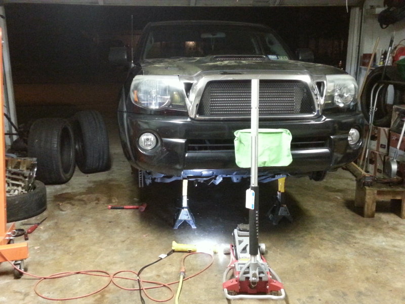

    Got a couple of things done that I wanted to, prior to Cars & Coffee tomorrow morning. Basically make sure my wheels were properly centered (long story), and drill/installed rear bump stops. They were needed!

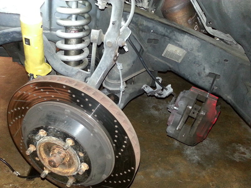

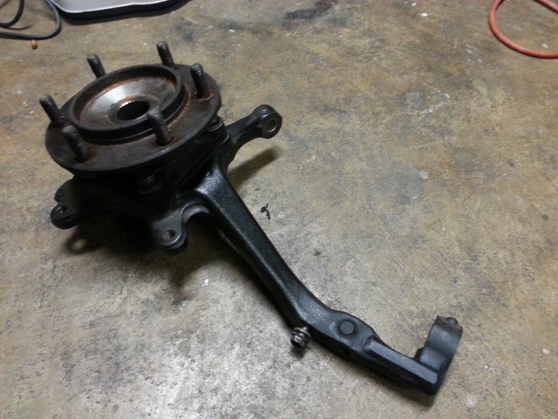

    Also, I just finished from working on the truck. Installed my modded steering knuckles. While in the process, I found a couple of problems.
    Passenger side bearing is howling at the moon. And somehow the rotors aren't firmly attached to their hats. There is noticeable play in them. Not good.*
    The purpose of tonight's (today's) modding, is because I have to weigh the unsprung mass of the front suspension. As well as take a lot of measurements to get the motion ratio. Had to install the new knuckles first though.
    I'll be able to get the measurments tomorrow, but doesn't look like I'll be driving the truck for a little while again.*

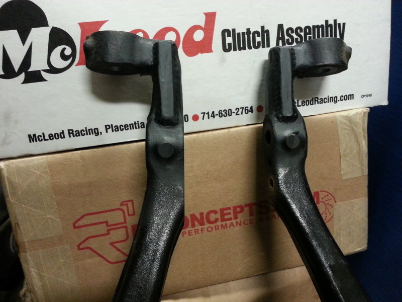

    Here is what was done to the knuckles, which I picked up from another member here on TW. I had the UCA mount lowere 1".
    Having the top mount lowered will aid in the angle of the UCA, help correct the camber a little, and allow me to be able to get a hair more up travel by trimming the bump stop.
    Now that I learned that I have that bad bearing, it is now time to install the ARP wheel studs. I just don't feel safe in these factory ones. My wheels are a bit thicker than stock, and the lug nuts just don't get enough bite for me.
