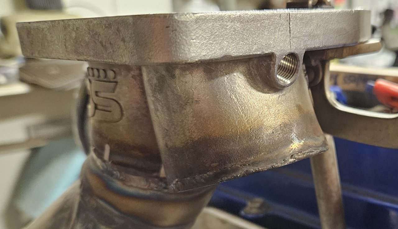

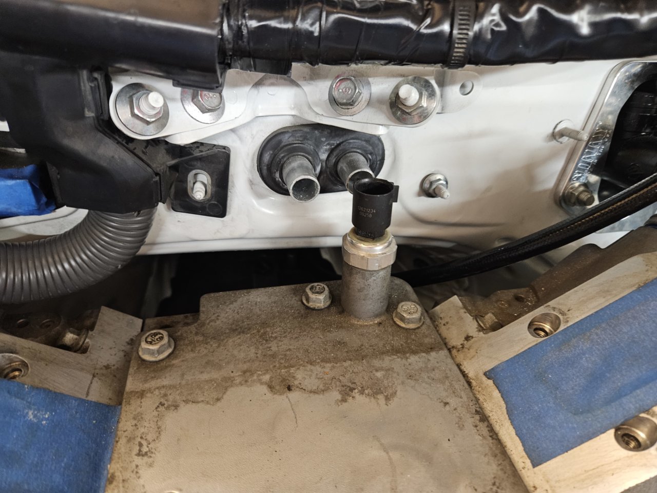

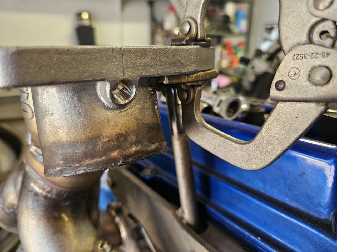

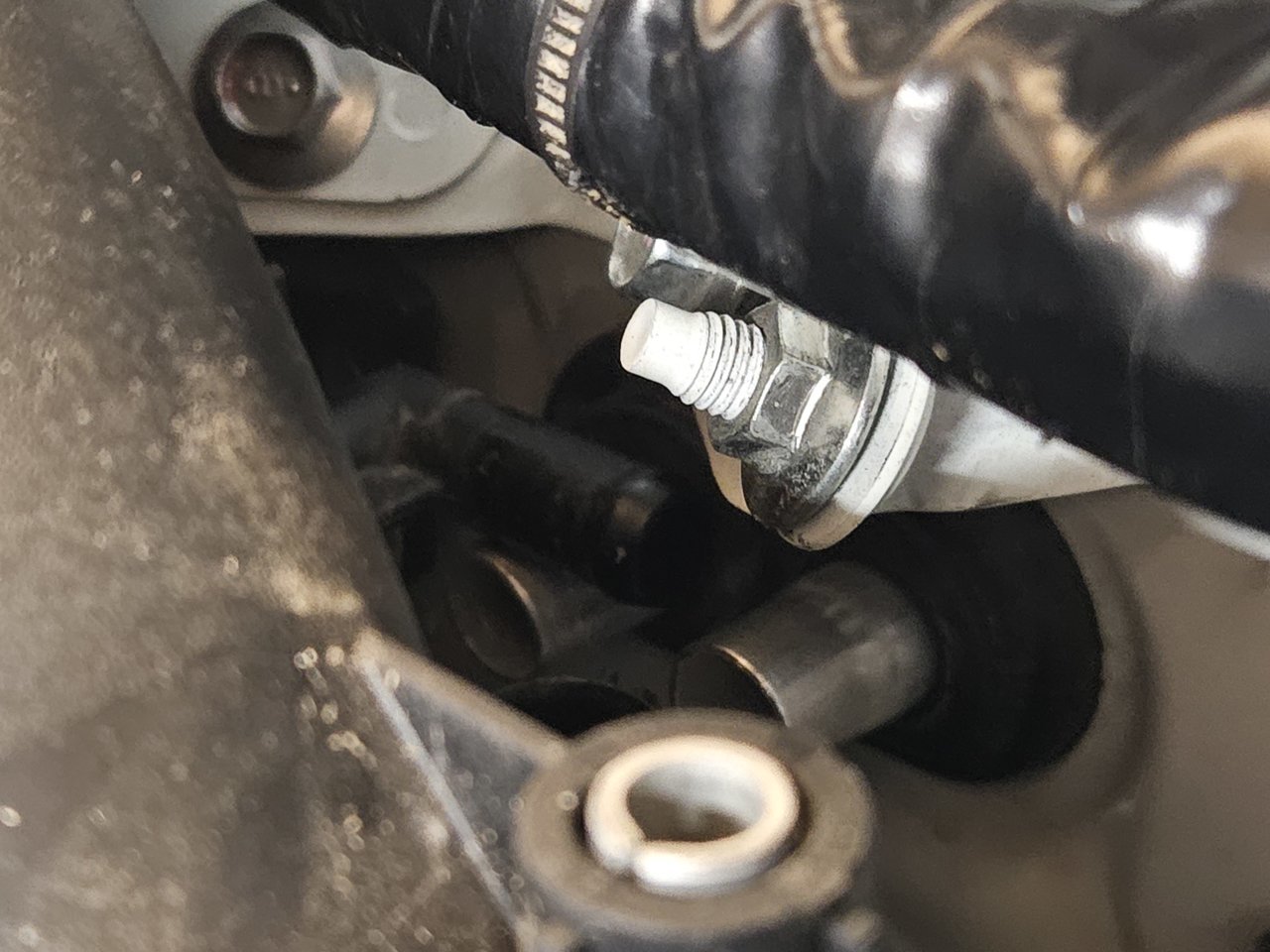

    Progress on my turbo header is slow. Have to adjust the last weld that I did to match the bracket that I made for the prior exhaust. The jig worked perfectly, but apparently the jig is slightly off from my down-pipe. So rather than re-work the down-pipe, I'll re‐work the manifold. Grr. I'll get some photos tomorrow.
    On the BRZ, it is a very tight fit. The location of the oil pressure sensor in this photo explains enough. No worky. Which lead to a cut and reweld. Which in turn became its own hurdle....
    Those are the heater core outlets. I figure a quick angled cut, weld, and done. Nooope. That did happen, but the level of porosity, casting trash, and oil in those pores was so bad, that it made me question it I was working with something other than aluminum. I even test pieces to see if it was magnesium. With vinegar. The oil fumes and oil kept turning the weld area black and all bubbly. Had to spend about 5-10 minutes cooking the two parts with a torch to get the most of the junk out of the pores.
    It certainly isn't pretty, but it will clear and hold pressure.

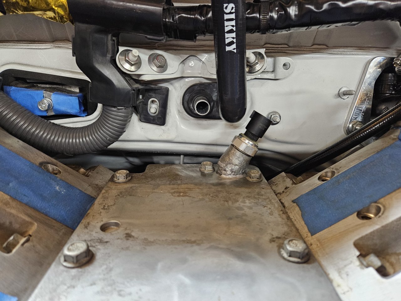

    Next to figure out is what to do with the PCV port on the back of the intake manifold. Since it is resting on the other heater pipe.
    Hopefully the engine/transmission combo will only have to come in/out no more than a couple more times. It gets a little closer each time though.

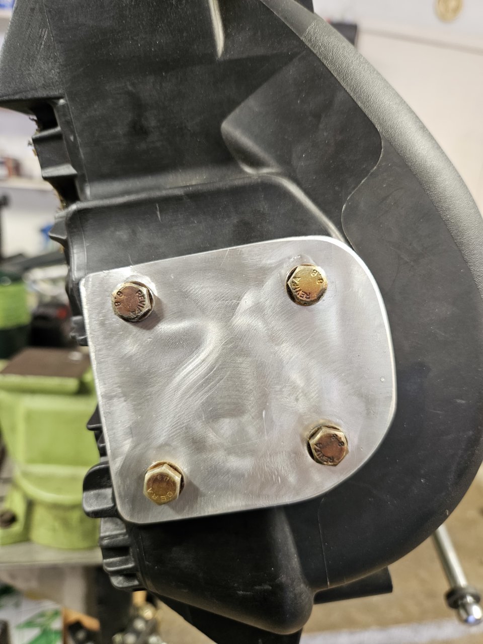

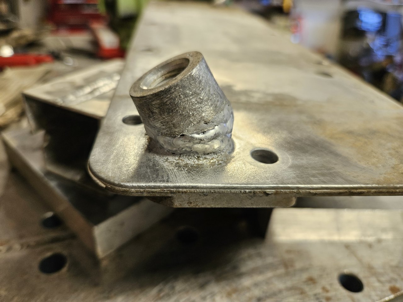

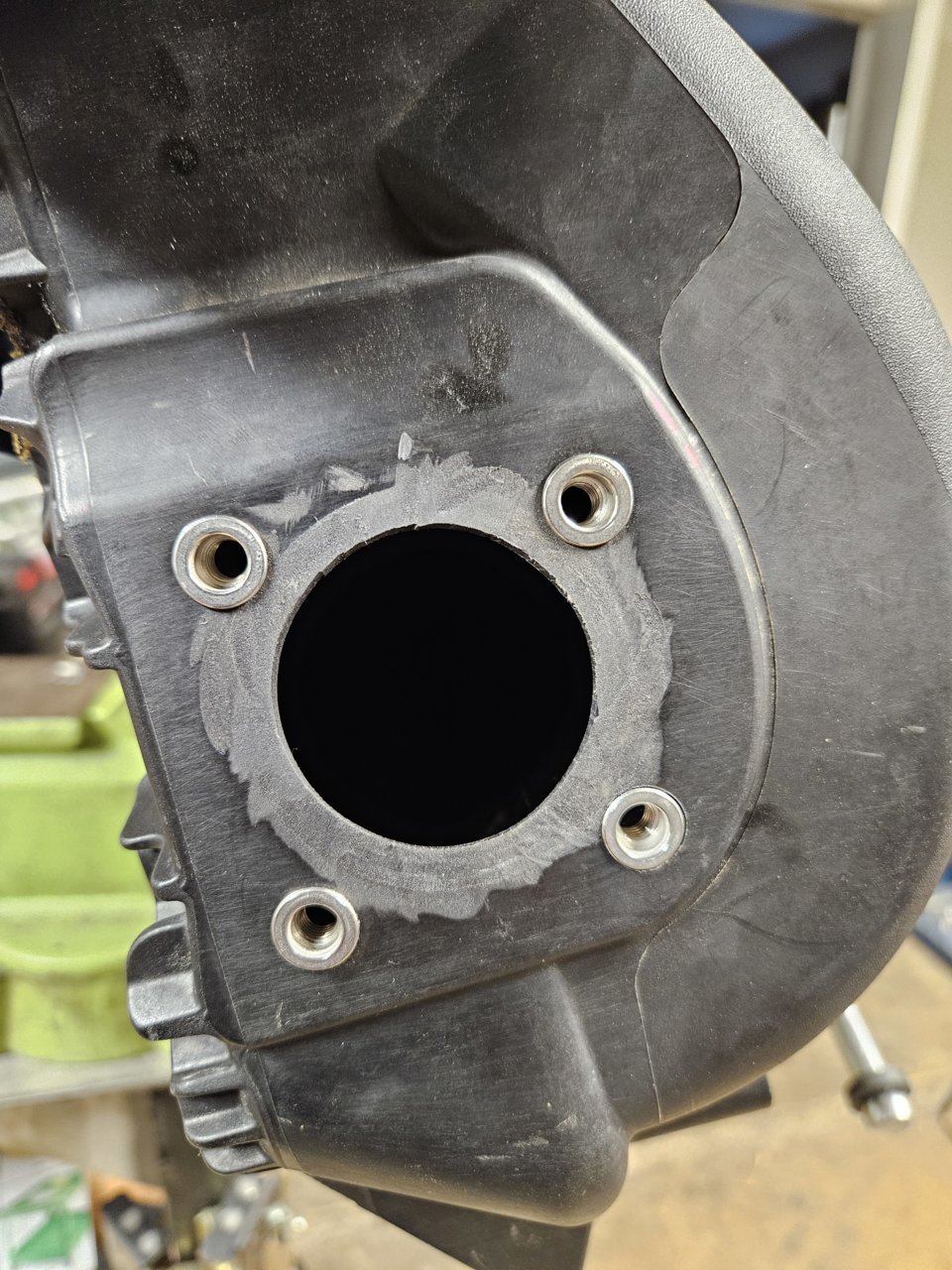

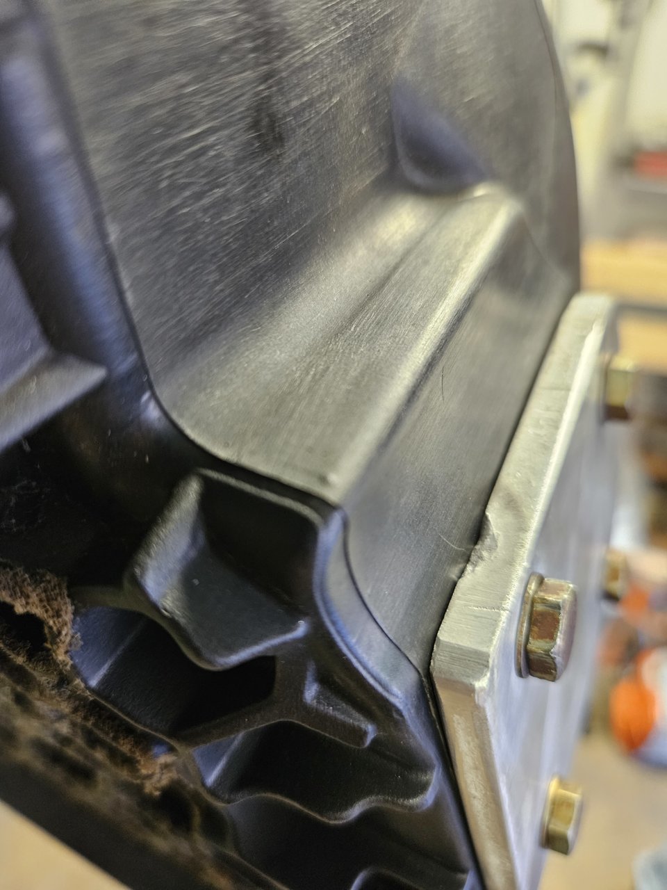

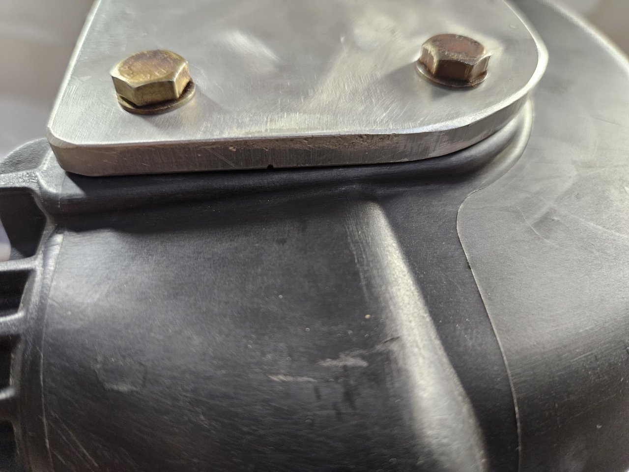

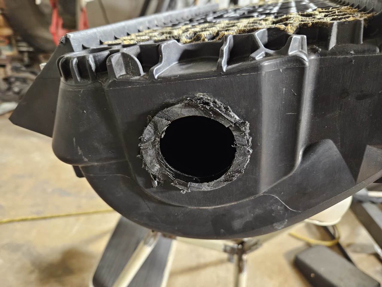

    From this:
    To this:
    Worked on clearancing the intake manifold. As a test because if it can be reused, rather than purchasing a FAST manifold, that will save around $1300.
    Trimmed off the rear area flat, in preparation for a plate.
    The plate will get recessed holes in the mating side, so that it will rest flush against the plastic. Silicone will do the sealing. Including on the bolts' threads.
    Then lastly, my truck's manifold. This prototype has been very time consuming and will not be used for future styles. The focus in this photo is that it is clamped to the support bracket of the previous manifold's flange. To match its angle. Meaning no change to the down-pipe.
    The finished weld is there. Now to finally work on the cross-over portion.

    Plate finished and ready for silicone.

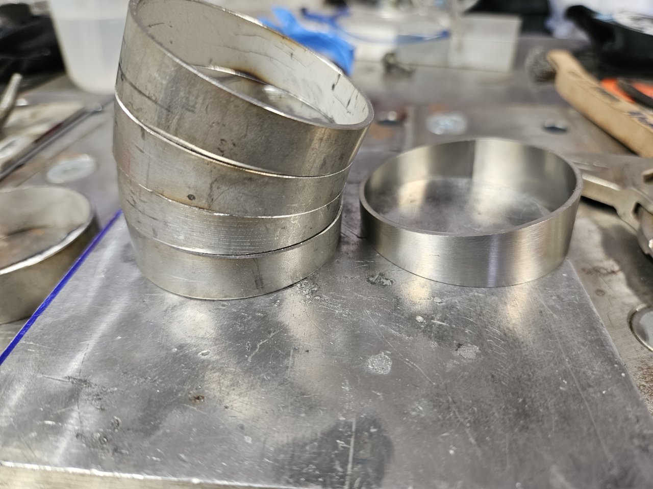

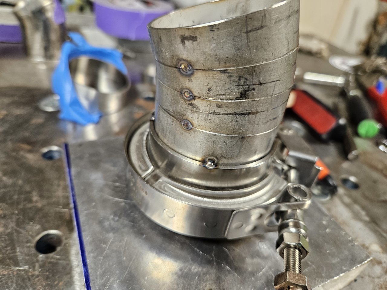

    Been busy with work to make any good progress on these projects. I did however try my hand at some 321 stainless pie cuts. They turned out good enough. I'll refine the angle more on any future ones that I make.
    The 321 SS are on the left. Compared to one from www.StainlessBros.com on the right. Which is 304 SS.
    Already mocked-up, so ready for welding.

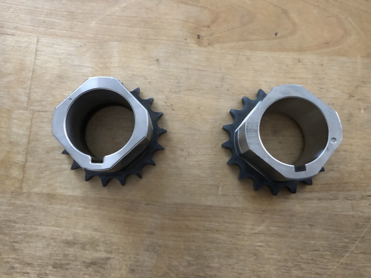

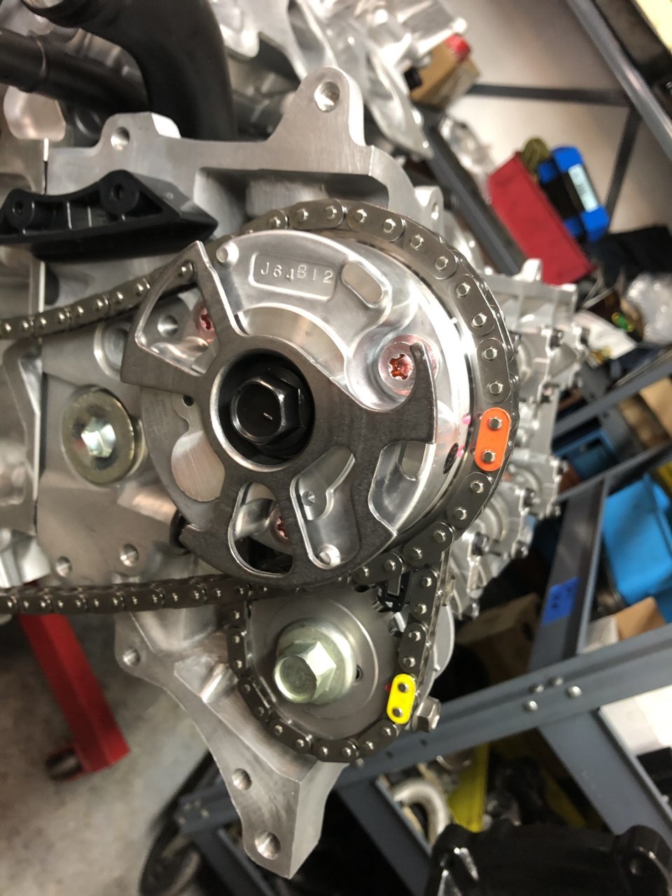

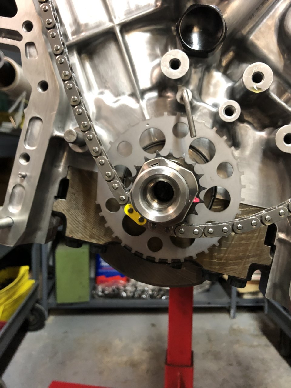

    They finally received the correct thrust bearings last week. Third times a charm. The ACL’s did not fit, Toyota 11011-31071 did not fit but last but not least Toyota part 11011-31040 did fit. Apparently the wall thickness ID to OD on the ACL and the first Toyota part were too thick. However the VIN number said 31071 should have worked.
    I would have picked it up today but yesterday the timing marks were not lining up on the crank sprocket. I definitely ordered the correct part number but it was not right the only possibility is that it was mis-packaged. They reordered another crank sprocket and now everything lines up. I received a text from Motoiq today saying I can pick up next Friday:D.
    here is a pic of the sprockets, the correct one is on the right
    Pics of the timing with the wrong sprocket
