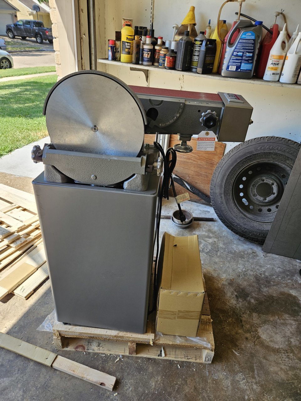

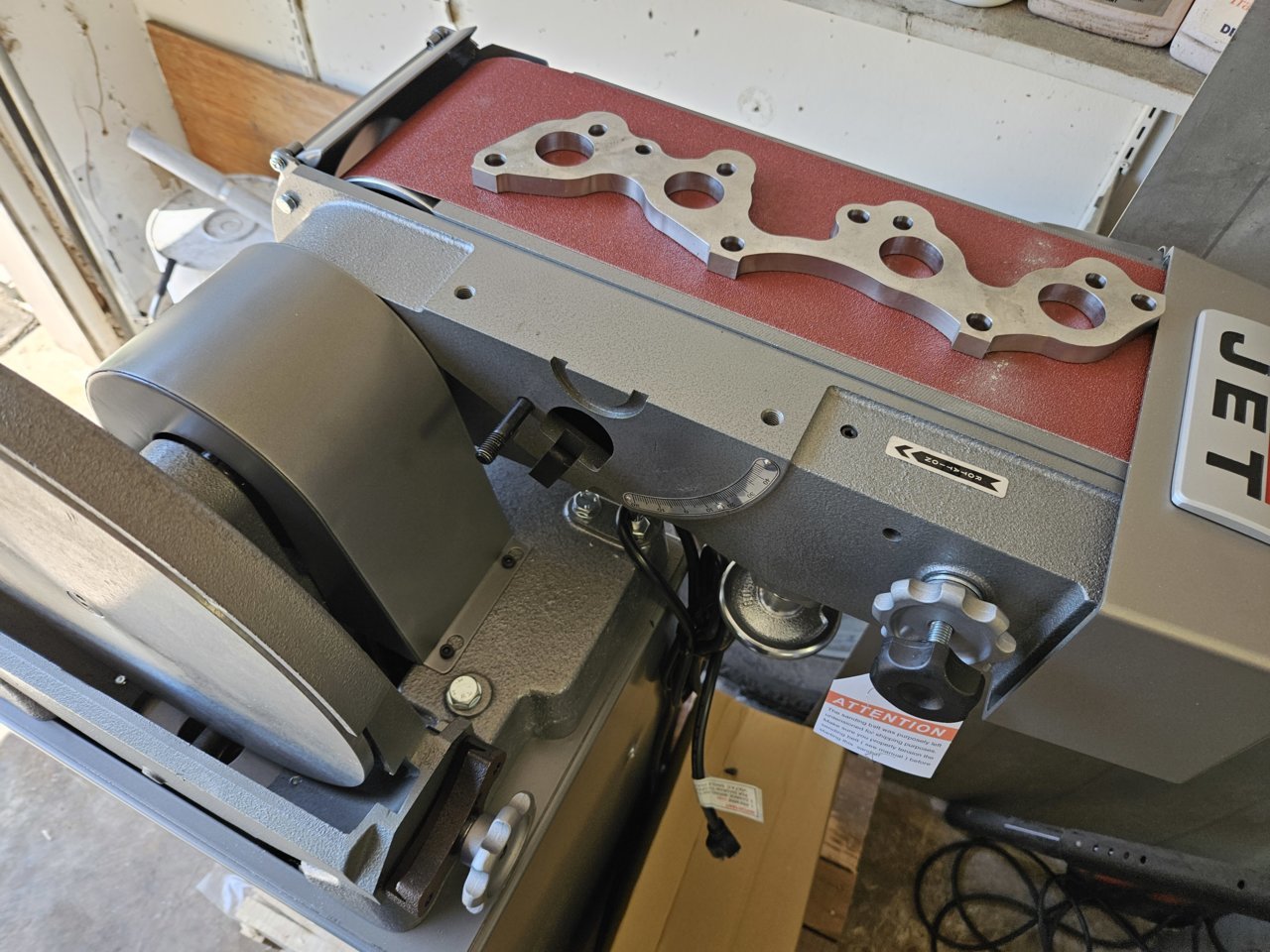

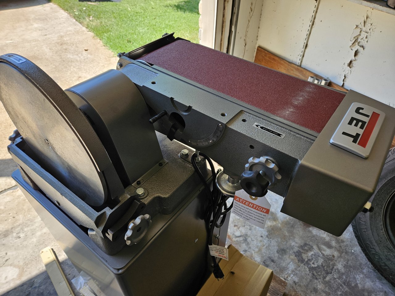

    New goodie.

    To be able to do a whole 4 port flange has me most excited. The smaller Ryobi, I had to keep moving the flange back and forth because of it overhanging the end.

    Hmmm… Doesn’t look like a $199.99 Harbor Freight machine!
    Tools start adding up and some really start adding up. I’ve been trying to talk my better half into moving into a one bedroom w/ den, 2.5 bathroom with a large kitchen for her awesome cooking and a large 3 to 4 car plus garage new casa but they are hard to find on a retirement budget.

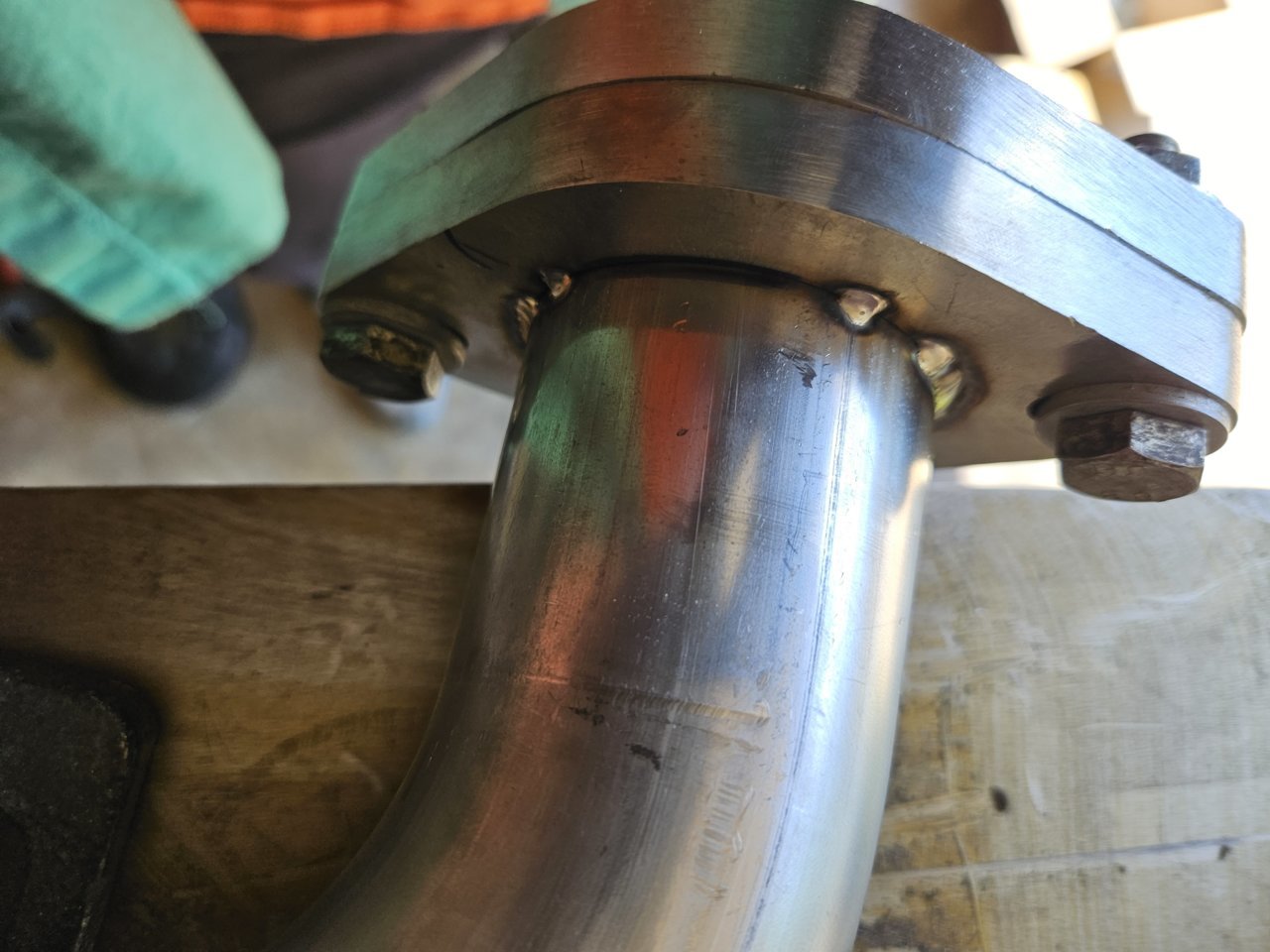

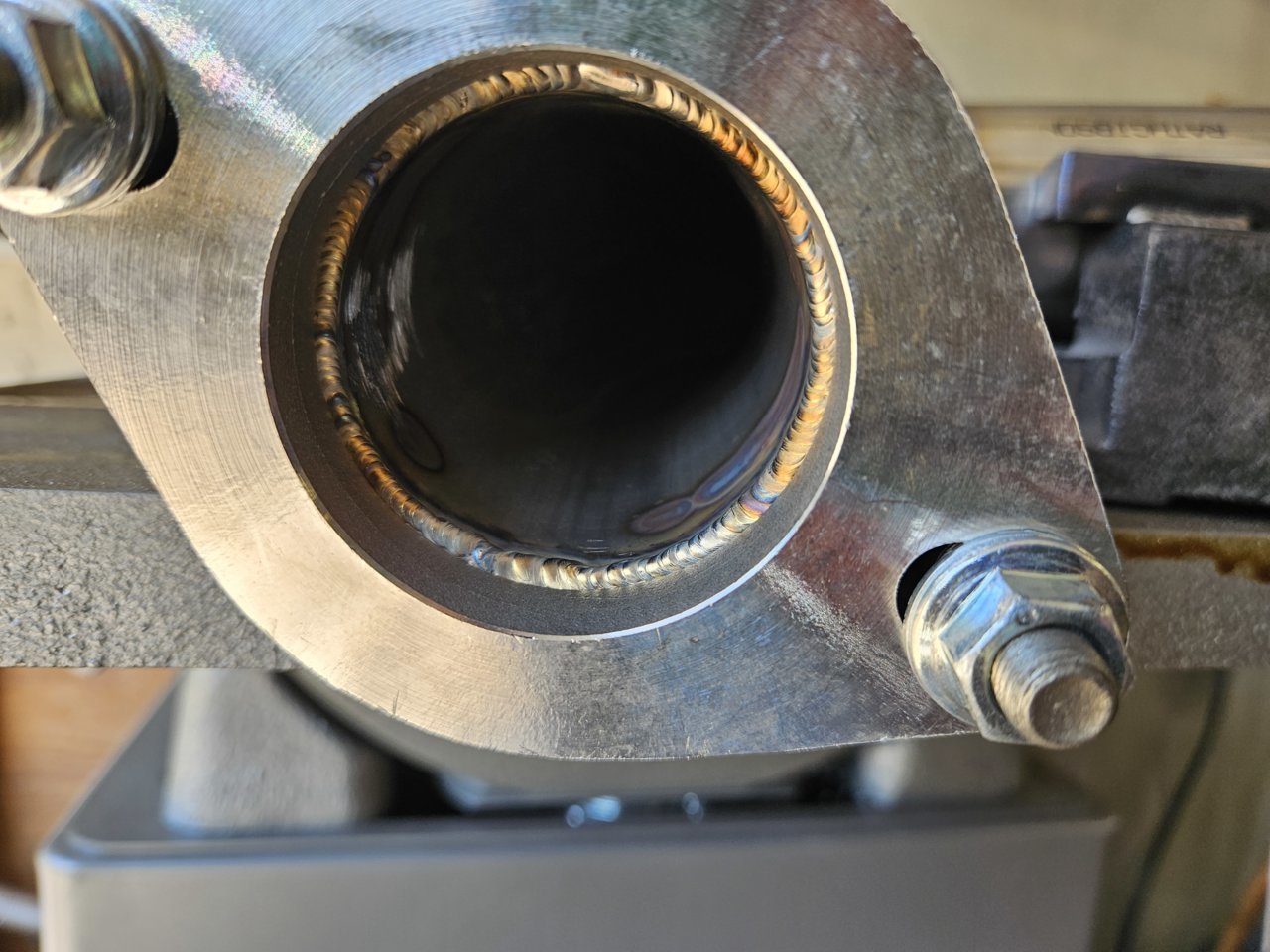

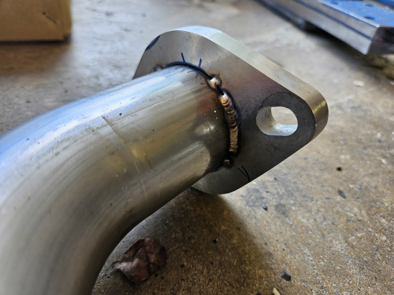

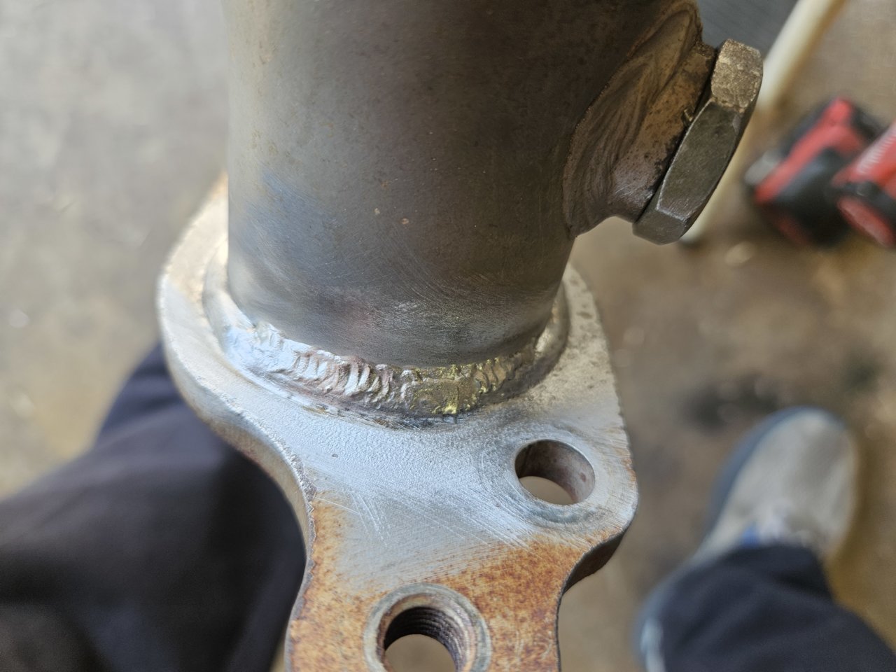

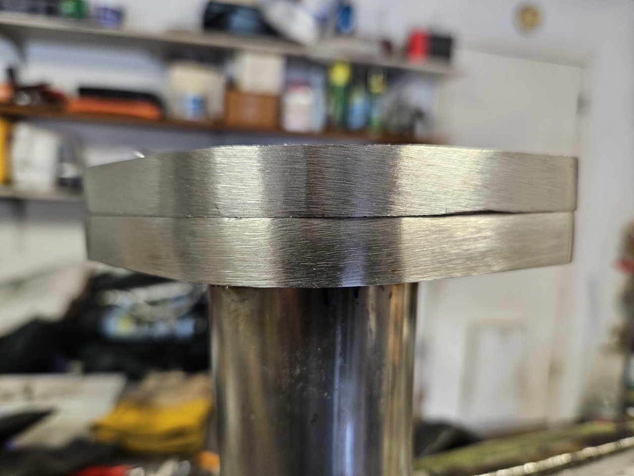

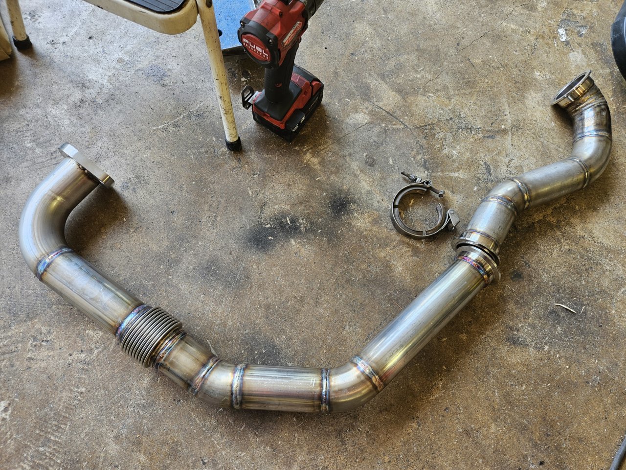

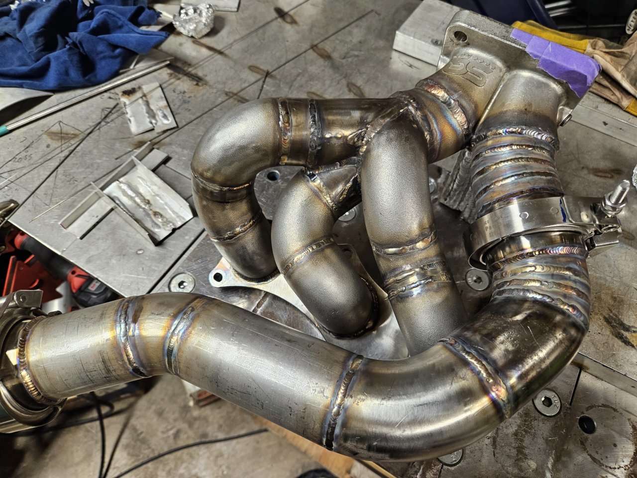

    Moving forward from this time quote, I was able to wrap up welding the long cross-over today. Just as the tank was running out of Argon. Phew!
    Fully welded the inside of the inlet, from the driver side header.
    Then welded the two bolt hole ends.
    Flange looks just right.
    This is the final product. Low gas, and heat were pressuring me to work quickly.
    The header had a crack. Cleaned it up and fixed that too. Although I didn't get a before photo.

    Yes. Except for one v-band quick disconnect clamp. Due to a failed t-bolt. The regular nut galled up, and froze. Had to cut that one off, then use an old Reid Washbon clamp. Got fortunate there.

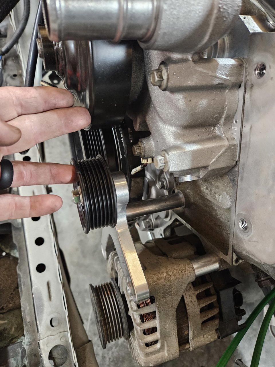

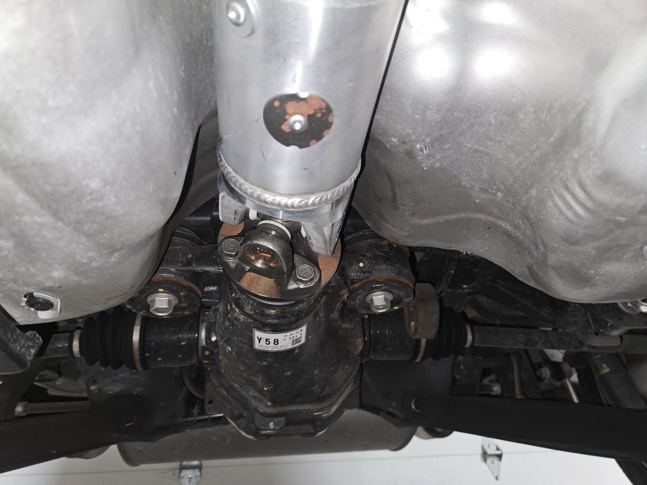

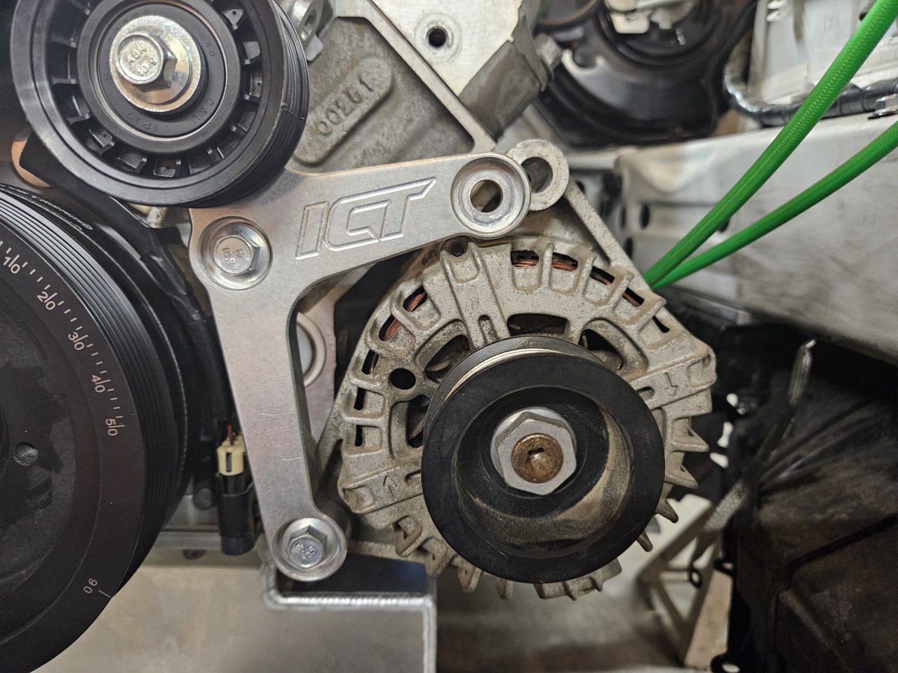

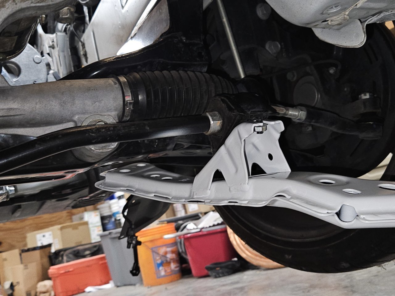

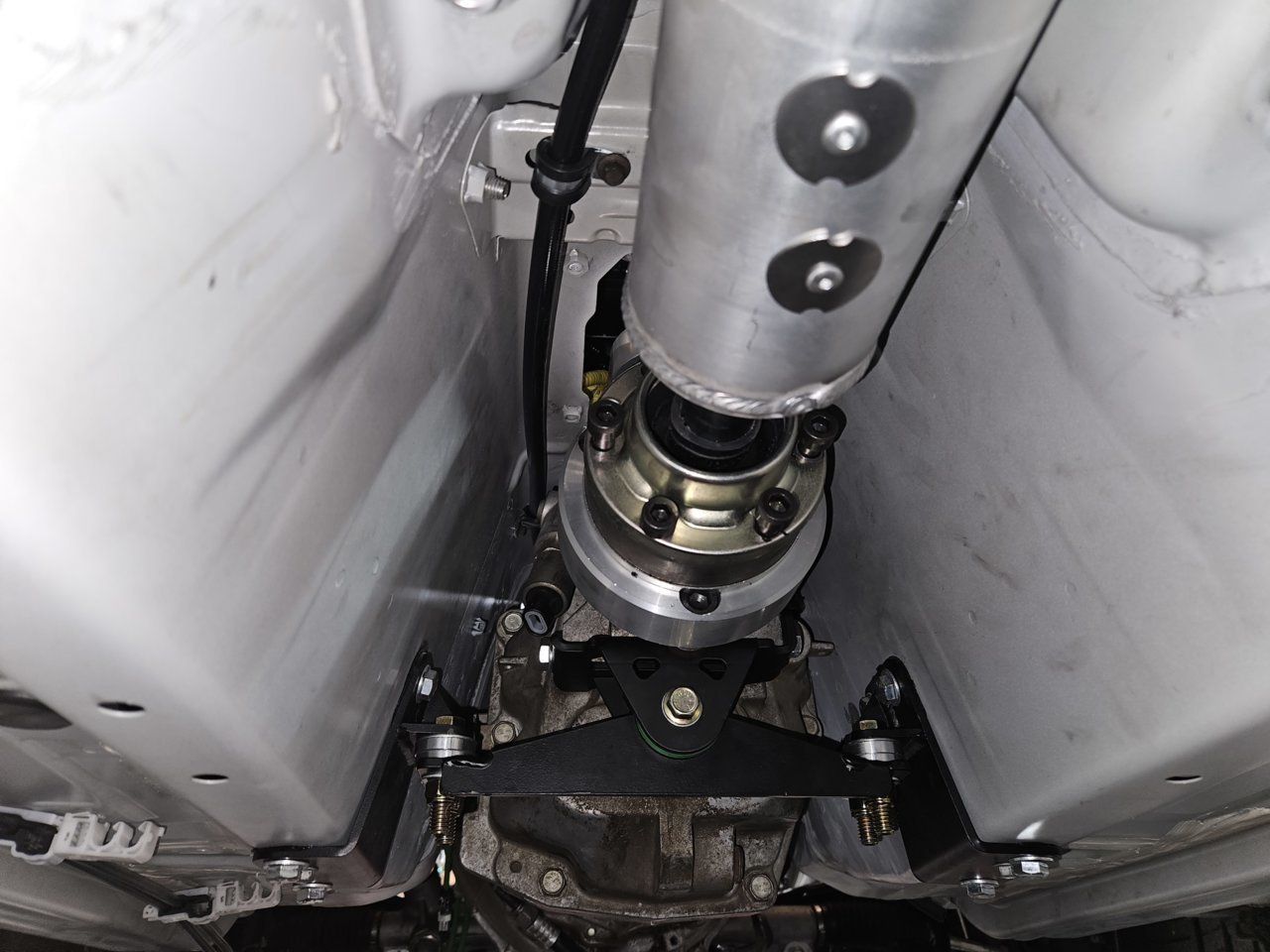

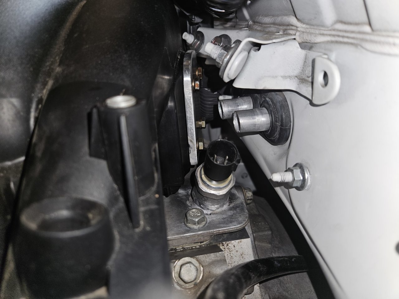

    Hopping back into the BRZ build.
    The drive line angles are GTG. Driveshaft is torqued down. Which then meant back to the engine bay to test fit the alternator and ICT Billet adapter. Well, I learned of two issues. The spacing didn't match the belt alignment for the Corvette accessories, and the alternator could not bolt up. A quick call ICT Billet, and merely the spacers needed to be trimmed down. I do like dealing with ICT Billet very much. :thumbsup:
    We also contacted them for the part number for the proper alternator. No photo yet, but it is installed and in. Perfect fitment.
    With the new one in place, I can route the large gauge alternator wire around the block to the starter.

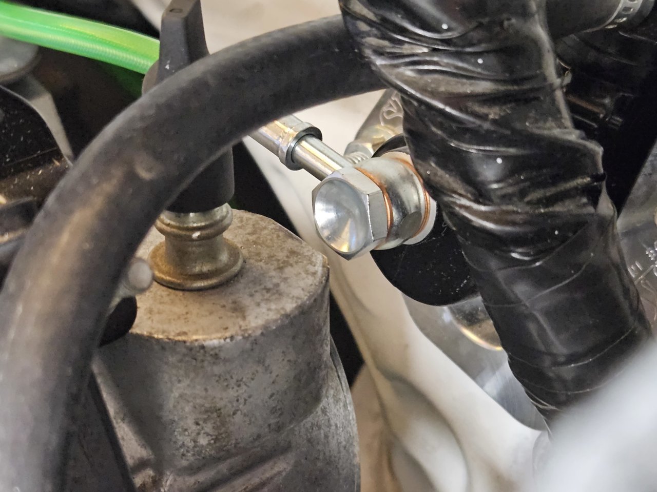

    Torspd Custom Turbo kit [] Borg Warner 9180EFR Turbo [] Haltech Elite 2500 [] TiAL Q BOV [] TiAL V44 Wastegate @ 15psi [] CP Pistons [] CP Carrillo Rods [] ARP Head studs [] ARP Main Studs [] ARP Header - Head Studs [] Ported Heads w/ 1mm oversized valves intake/exhaust [] Brian Crower Forged Stroker Crank [] Darton M.I.D. Sleeved Block [] Kelford Camshafts [] Torspd 160* T-stat mod [] APR Large Fuel Rail [] Walbro 460 LPH E85 Fuel Pump [] FueLab FPR [] APR T56 Conversion Kit [] KP RACING Built T56 [] McLeod Racing Custom Twin Disk Clutch [] One Piece Aluminum Driveshaft [] MGW Shifter [] Custom lowering kit [] Ohlins Front Coilovers [] QA1rear shocks [] Custom Ron Davis Radiator [] Dual SPAL Electric Fans []

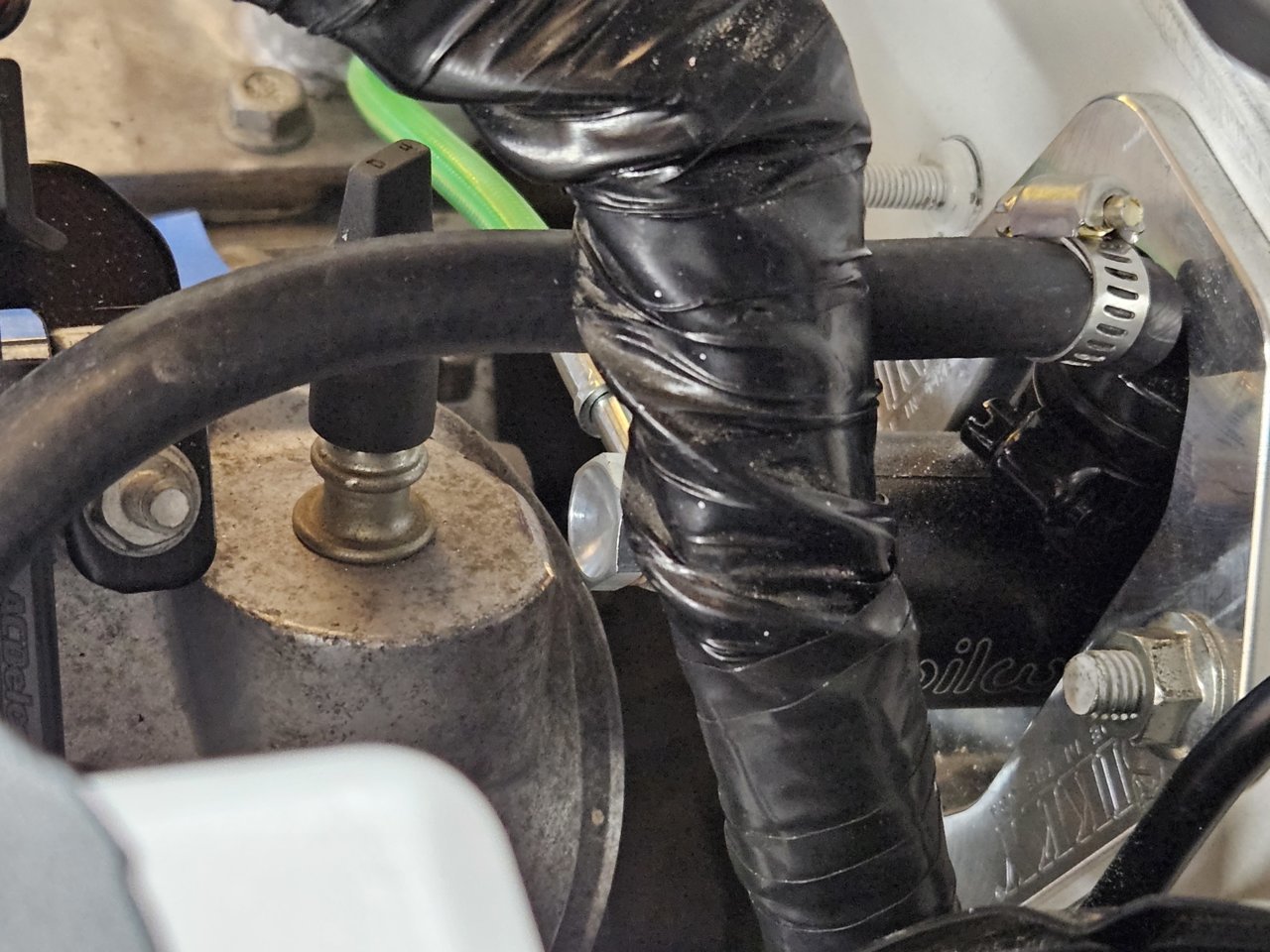

    Some massaging with a die grinder was needed to add some clearance between the valve cover and banjo bolt of the clutch cylinder. Got about an 1/8" of wiggles room now.

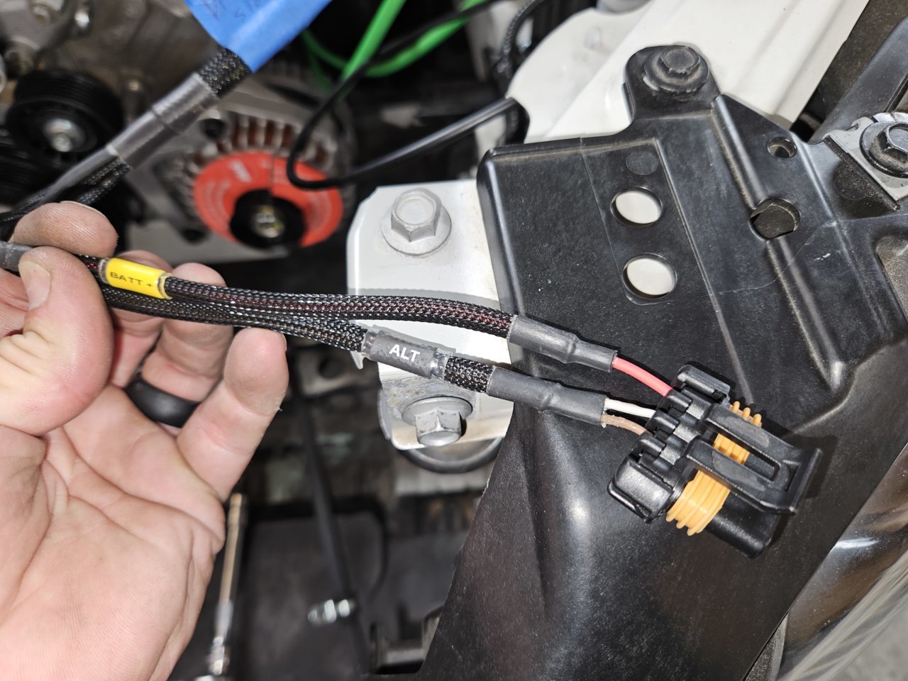

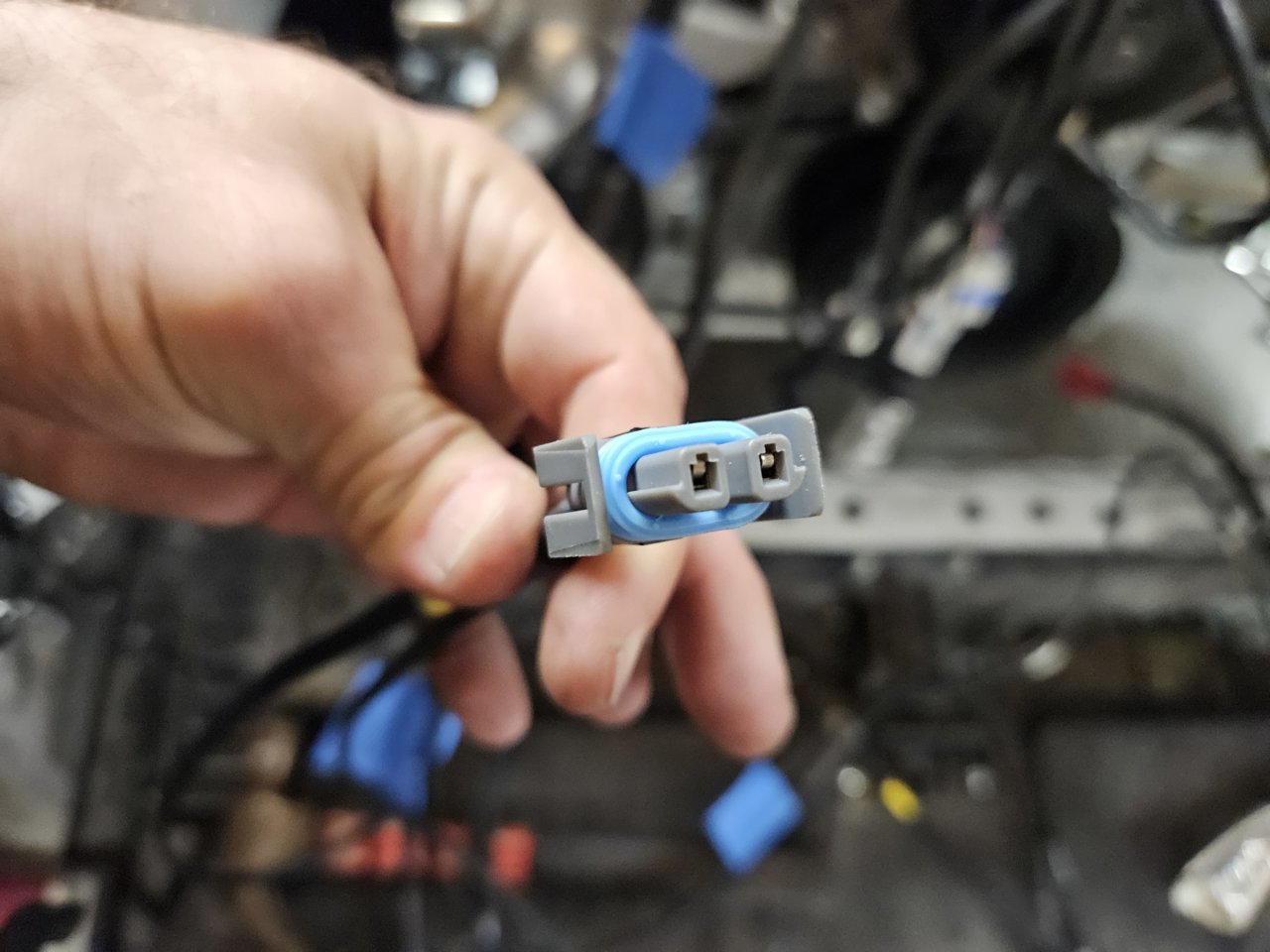

    At this point, the lower half of the dash has been pulled out to allow access for the Wiring Specialties harness to be routed through. It feels a whole heck of a lot closer to start-up now.

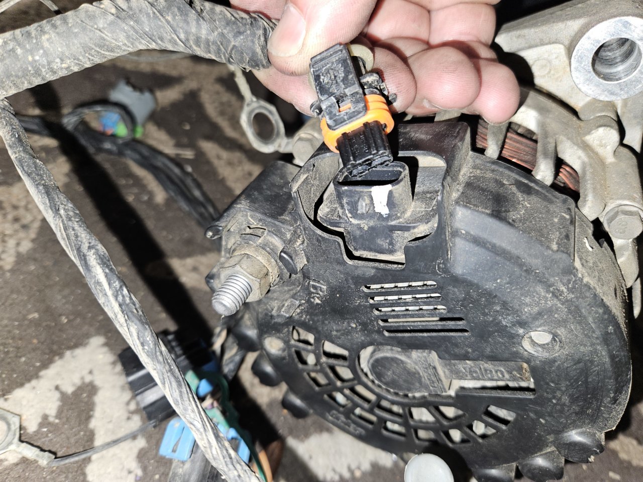

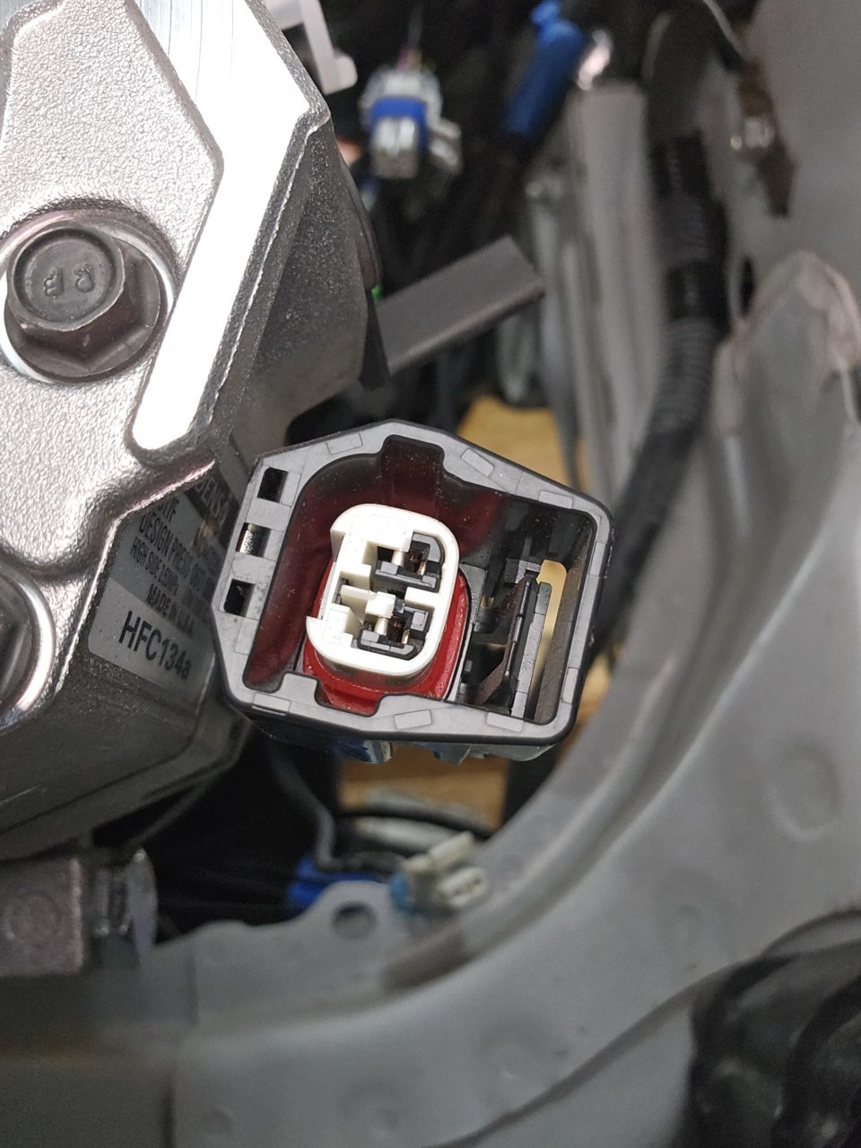

    I've run into a few issues with the plugs on the harness matching the plugs on the accessories. Which is not their fault. They've been helping me with those hiccups. Their harness is top notch.
    The A/C compressor part number was supplied by SIKKY. The kit swap manufacturer. Well that plug is different from the Corvetter A/C compressor plug. Not a big deal. A simple re-pin or splice and done.
    Then the last plug to overcome is the alternator.
    If I read the tag properly, this should be the plug for the alternator. Waiting to hear back from Wiring Specialties about that.
    Once those are sorted, then I can route the harness out, and bolt down the grounds. Then it'll be a heck of a lot closer to fluids and start-up. It's getting close now!
