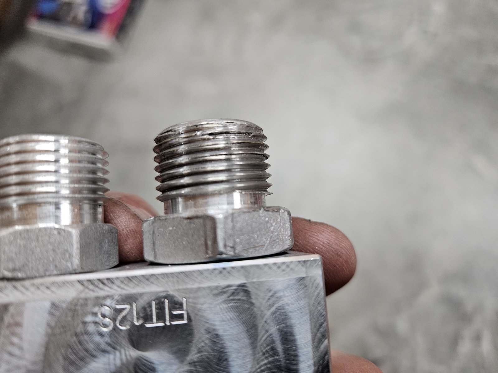

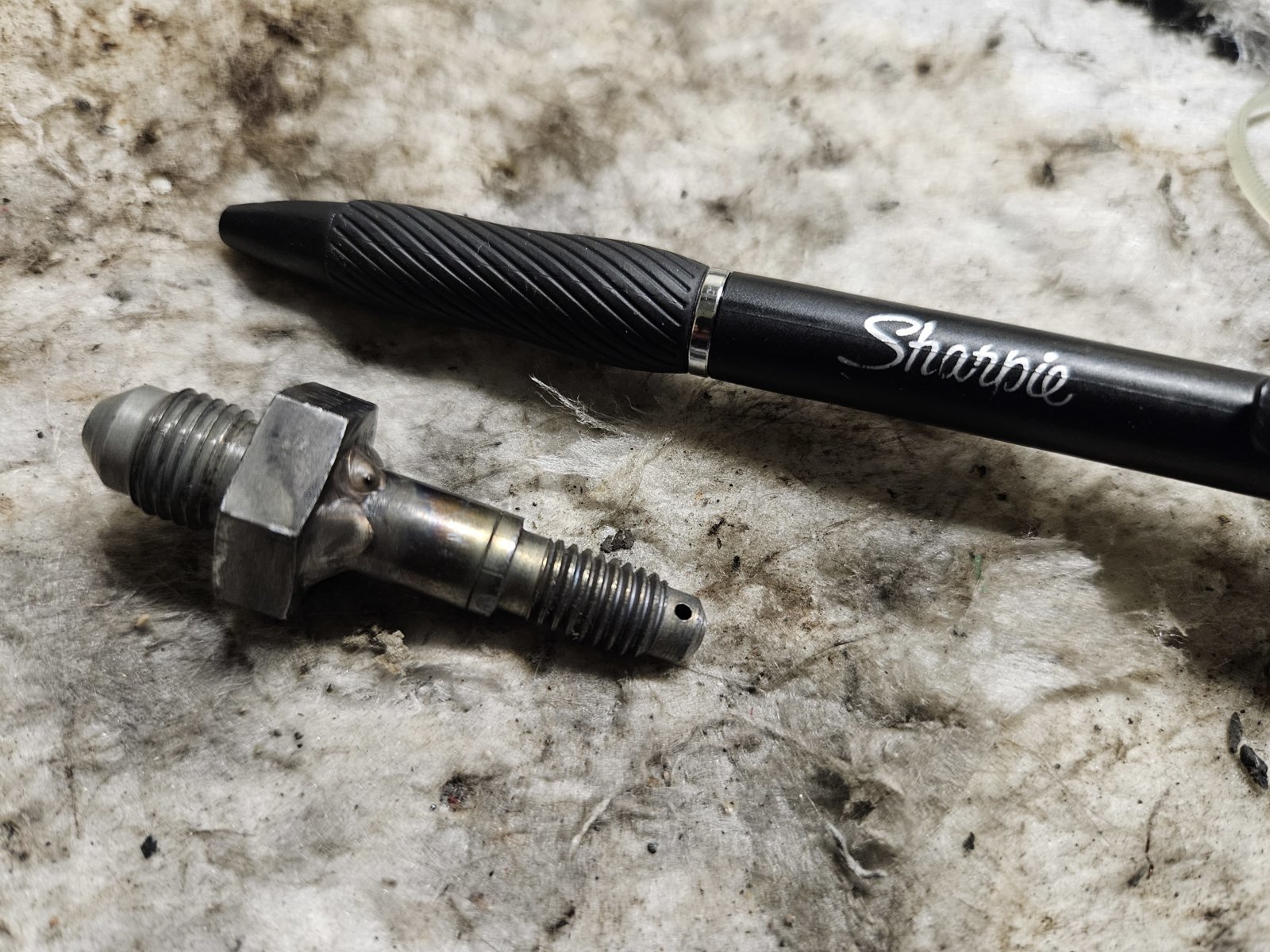

    That's correct. However, typical GM you cannot easily access the bleed screw. Couple that with a swap, and the only way you'd access it without an remote line, is by cutting a hole in the trans tunnel. Not a bad idea with an access door, now that I think about it. :drevil:

    This is the teeny tiny hole that needs to he weld filled.

    lookin good! That should do the trick.

    Getting back to these fittings. The new ones arrived and are installed. They worked properly. No pictures of any of the new parts. I was in a mad dash to get this car back together and get is started.

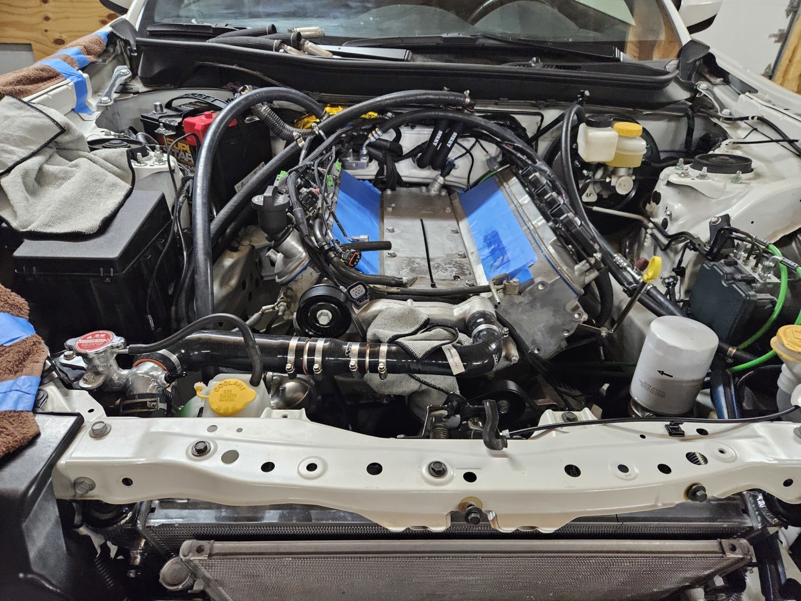

    Bolted up the steering rack and everything else last night. Steering rack, drive shaft, passenger header, and intake.
    Then swapped in the updated ecu. To verify if the throttle body would work. I had faith it would, and sure enough it did! 2nd problem fixed.
    It was time for startup. I pulled the fuel pump relay, and cranked it over a good amount to get some oil circulation. Popped the fuel pump relay back in, expecting a short crank session to get fuel back to the rail. Turned into a long cranking session. Too long. No fuel was getting to the engine. WTH?! Check a couple of things, and no change...what now? Grrr.
    Owner goes to fill up 5 gallons, since the tank was really low. To prevent a Roadkill scenario where the troubleshoot a non starting car, but failed to realize they were just out of fuel.
    I disconnec the battery and reconnect, to see if that makes any changes. Nothing. Check plug for the electronics that I had just re-installed. Nothing. Two ground wires from the old OEM harness, tucked near and behind the battery called to me in modders whisper. Why not attach them loosely and see if anything changes. Now don't read this and think that "Well duh, that's obvious." I would have thought that too, except when we had it running before, those weren't needed. So yes, yes, it is obvious reading this post wise, that they needed to be on. And yes, the engine started and ran.
    What's weird, is that they weren't needed to start the engine and have it run before, but now they were absolutely needed. What's also odd, is that the TB works without them attached. It has to be a programming change in the software.
    The tach-o will not work without them, and CEL will be illuminated.
    Either way, the engine sounds even better now that it can be revved. So I'll need to get a start-up and running video. Maybe even some drive-by vids, prior to having the exhaust made.

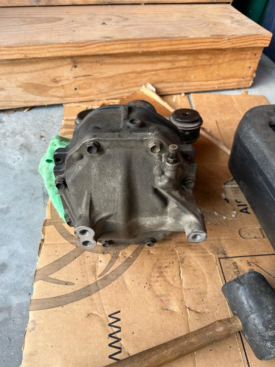

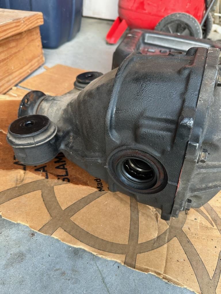

    Little updates on the BRZ. The owner purchased an M82 differential out of a Lexus IS300, that has a 3.73:1 ratio, but an open LSD. Took the two to Kozmic Motorsports for them to swap the gears out of it and into the BRZ diff with the BRZ LSD. That was yesterday, and he picks it up today. Very fast turn around!
    If it weren't for the open style, the whole thing would swap right in.

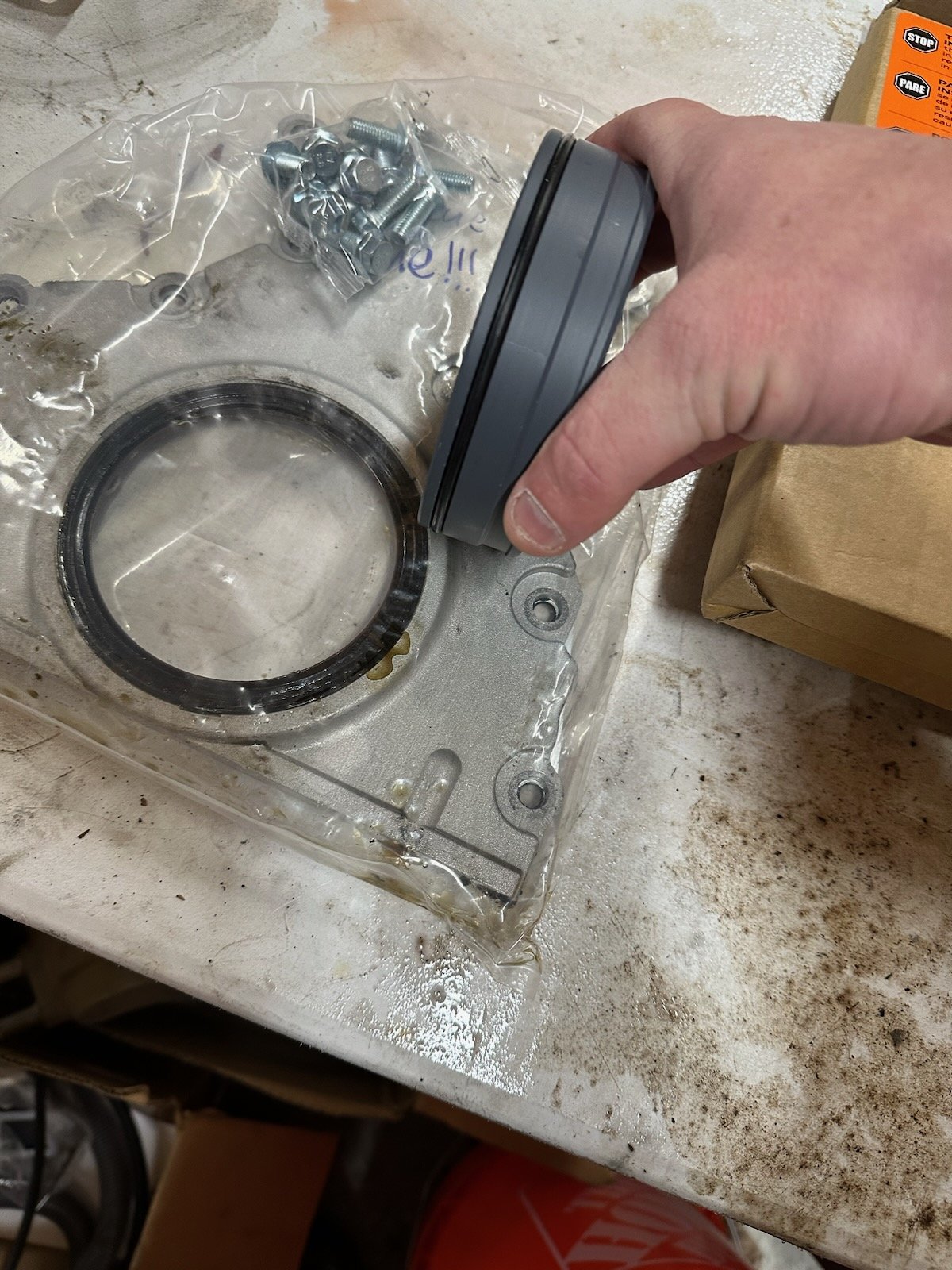

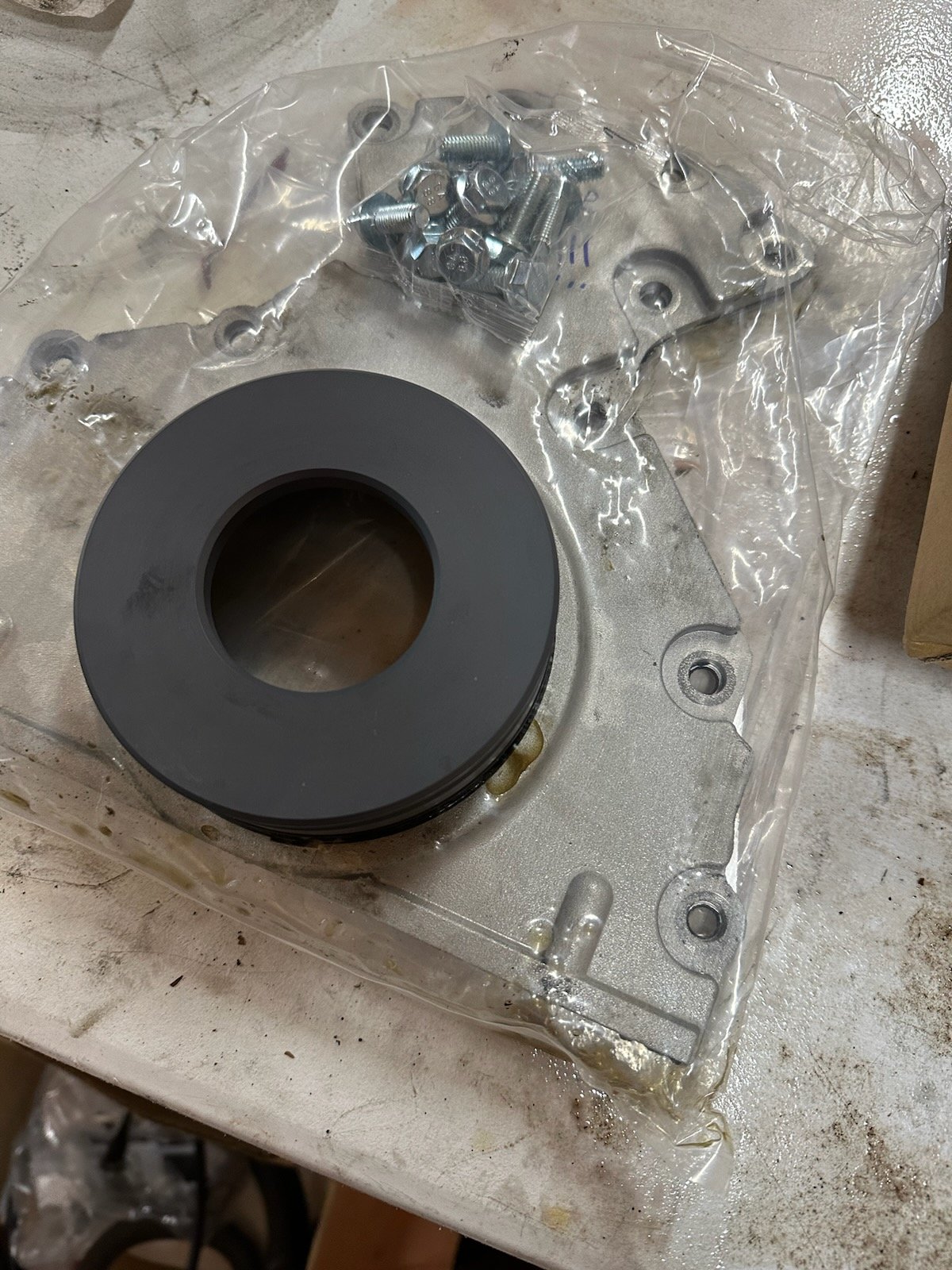

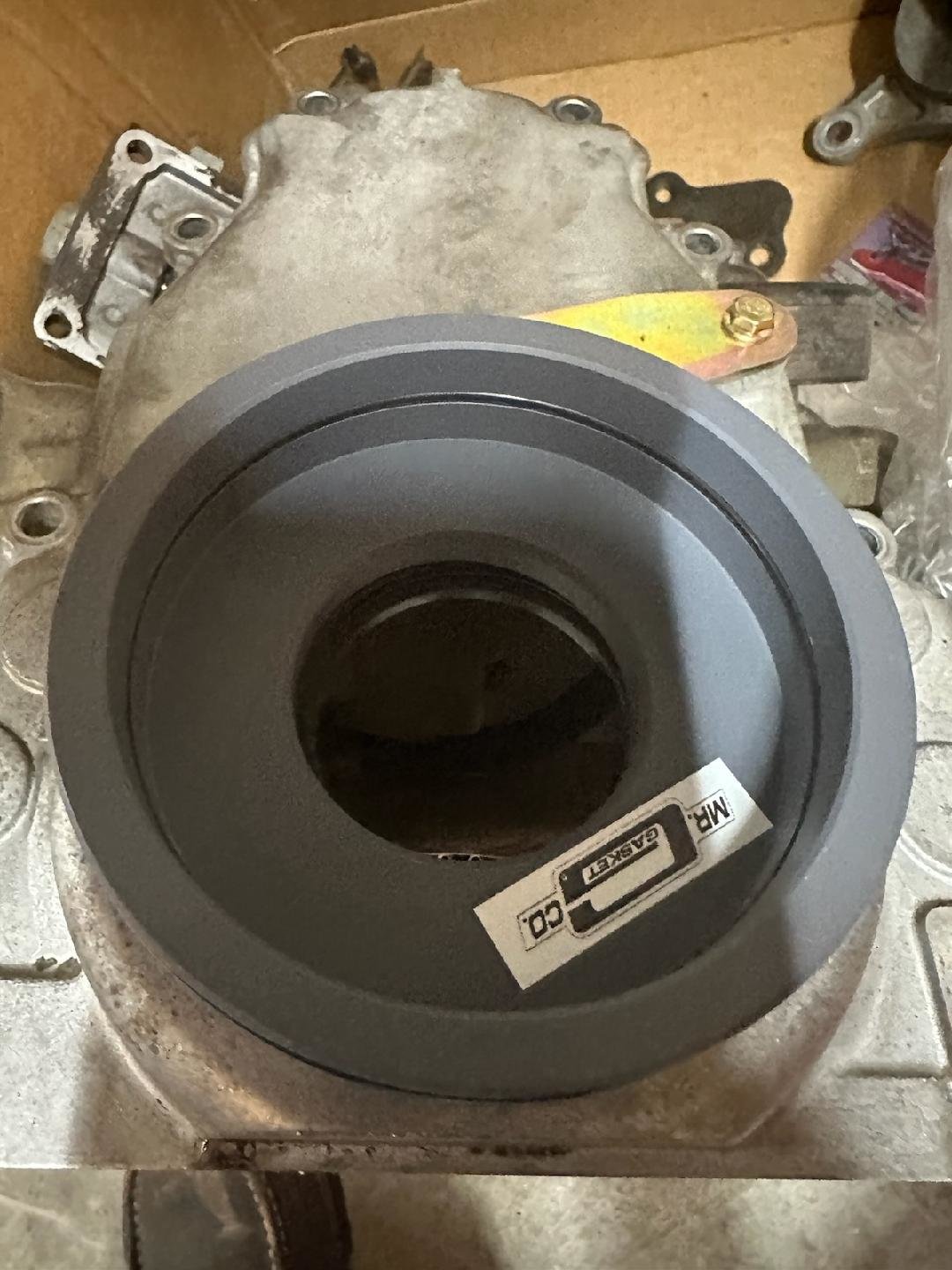

    While those are out, we'll properly align the rear main seal plate with the Mr. Gasket alignment tool.
