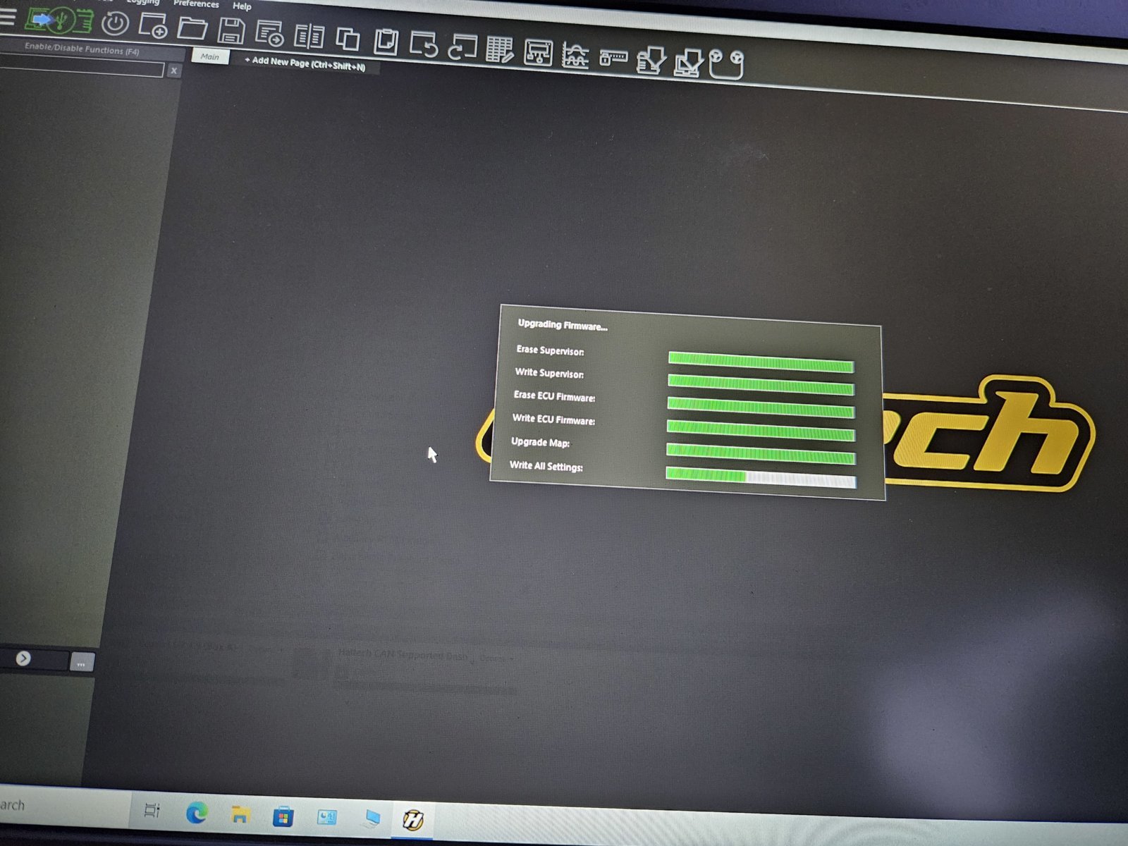

    Two much needed updates. Coolant lines on the turbo, and Nexus software update to the Haltech. :muscleflexing:
    Truck's starting to put in a lot more work. These updates will help keep it going strong.

    @Speedytech7 , well the time finally came to be able to update my Haltech software, so that I could do something that you shared some odd months ago. As of this past Wednesday, I updated the Nexus software to the latest version to be able to use the Map Prediction Fuel Film Model.
    Wholly smokes is the truck driving in a much smoother manner than ever before. Thanks to you, I learned about it, so just wanted to thank you.
    Still needs a other areas finessed, but this is the closest that the truck has ever felt to OEM.

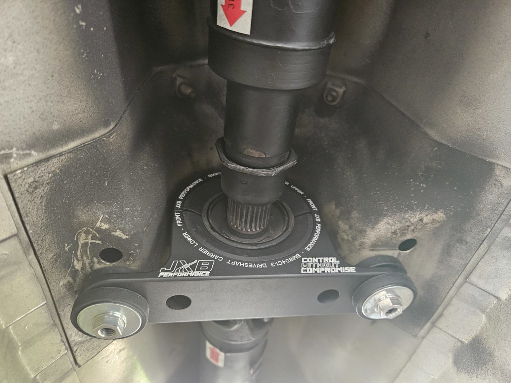

    This last weekend was an incredibly busy one. Glad to have the companionship and help of @Lucario Runner. We started off the weekend by making some Nuka Cola, from Fallout. It is quite good. Even better when made with some complementing Bumbu rum. Some slight modifications to the recipie, and I think it would be perfect. It's just plain fun to bring the imagination to life.
    This is the syrup.
    Three vehicles to work on, we had out work cut out for us. His truck and both of mine. The Bimmer was first on my list, as it had developed a heater hose coolant leak.

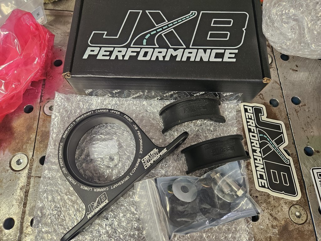

    Trying to take the intake manifold off of the E36, really makes me appreciate how simple it is to remove the same from the Tacoma. The BMW is a Driver's machine, Not a wrencher's machine.

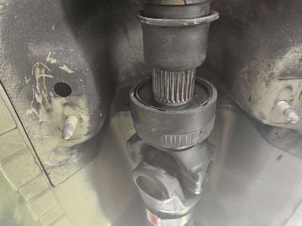

    I had purchased 3 of the 4 hoses ahead of time. One was on back-order. It must be noted the popularity of the vehicle because we were able to find an OE equivalent at an auto parts store, for a 27 year old Euro car.

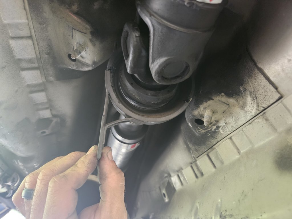

    All of those replaced and the car running well, the next mod was the carrier bearing support replacement. The car had a terrible driveline wobble under heavy acceleration. The support was split.
    Made a few cuts to take off the old housing, and free up the bearing. The new replacement clamps over. Ingenious design.

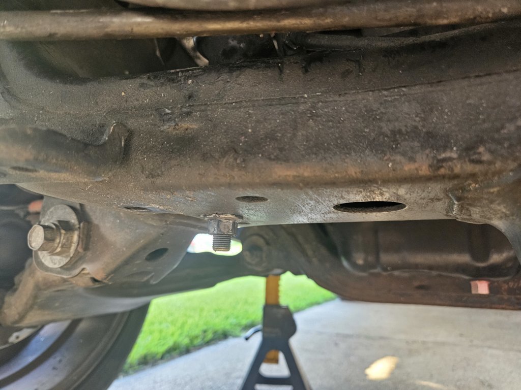

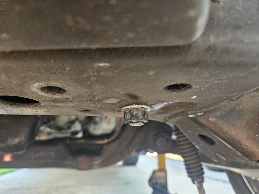

    Having that all finished, the next task was swapping in the steering rack bushings on the Tacoma, for the Energy Suspension bushings. That is not the easiest task even for us seasoned mechanics.
    I could do it much quicker a 2nd go around, but what a chore with was. If I still had the front drive train, it would have been a different and longer project. I didn't get a lot of photos because there are plenty on the forum.
    Thank goodness for the air hammer with chisel bits, die grinder with burr bits, and a heat gun. The heat gun made it absolutely a breeze to get the bushings out. Once those are out however, the outer sleeve that it pressed into the rack, has to come out. Air hammer made pretty eary work of those.
    To have room to move the rack around to work on, meant that the driver side bolt needed to be shorted. This is how far I cut it. Compared to the passenger side, which was left alone.
    I never removed the tie rod ends, so with my paint mark on the steering shaft, it was very easy to re-align in the proper orientation.

    What a great weekend. Reminds me of spending weekends with y'all, and of course Jeff.
    Willing to share the secret recipe to the nuka cola? Looks like cinnamon, star anise and coriander. Are those mini bay leaves?
    That's a slick looking carrier bearing. Solid, but more comfortable than a hard mounted pillow block bearing.

    I am super happy with the carrier bearing assembly. Splits in half, and has replaceable variable durometer inserts.
