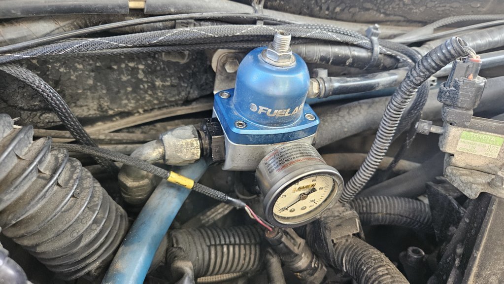

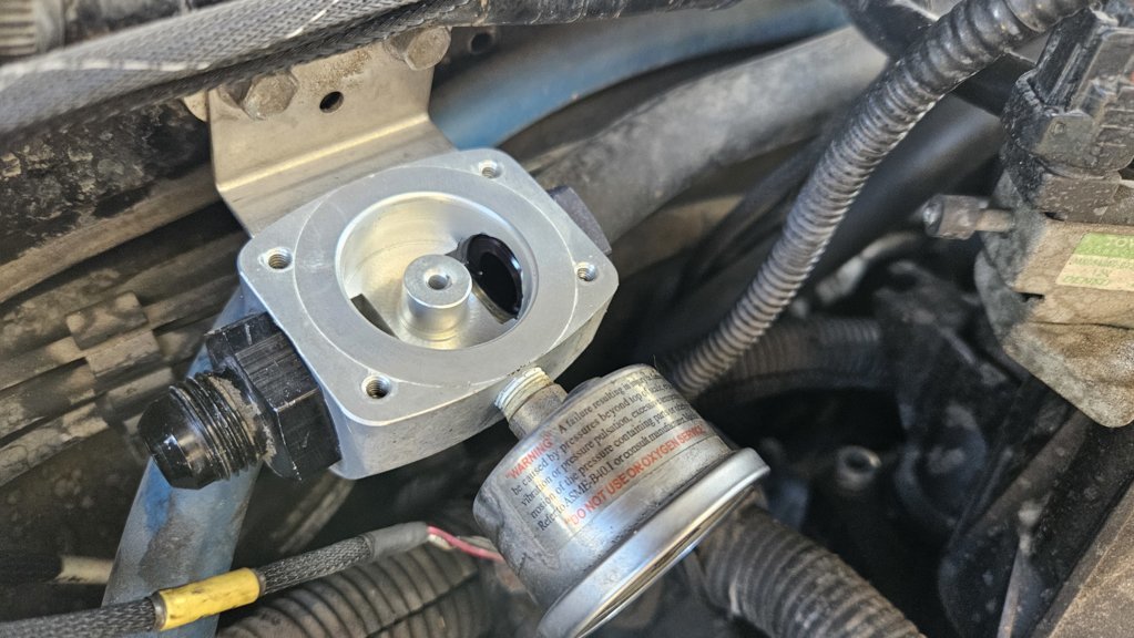

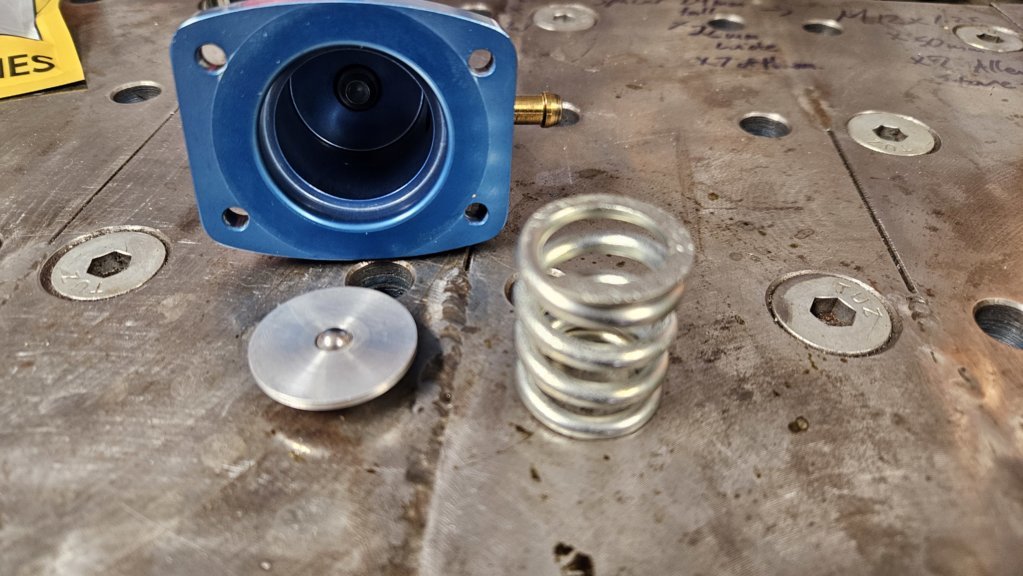

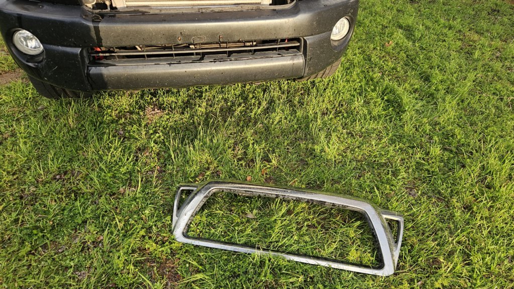

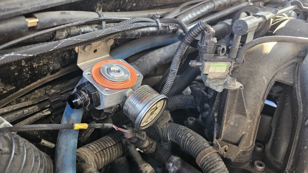

    Not much going on with my truck, to update. The grill finally however finally gave way last week. After a road trip, the wind had taken a toll on it, and it was hanging out in front of the passenger headlight.
    I had a fuel consumption issue. Been doing a lot of testing. Made a change to my fuel pressure regulator to up the base fuel pressure, and noticed the needle on the gauge start bouncing like crazy. Changed the diaphragm in there, and the next road trip, I was able to get ~23 mpg. That was a welcomed surprise.

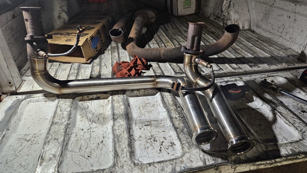

    I still have to figure out a driver side VVT issue, when I have a chance. That will take some time that current I don't have.

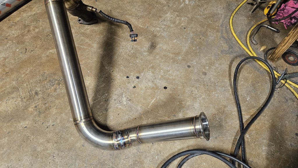

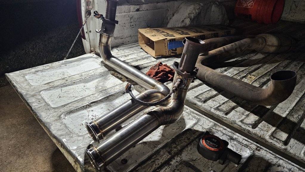

    In the mean, I worked on a custom exhaust for a 99 Chevy, 2500. Very simple and man does it sound good. Again though, long hours, and too tired to take a video. I'll need to get one. Here are the few photos that I took.
    Steves104x4, Brice, not_nick and 7 others like this.
