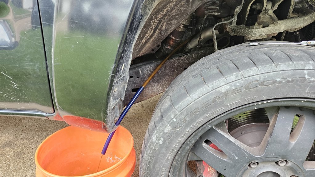

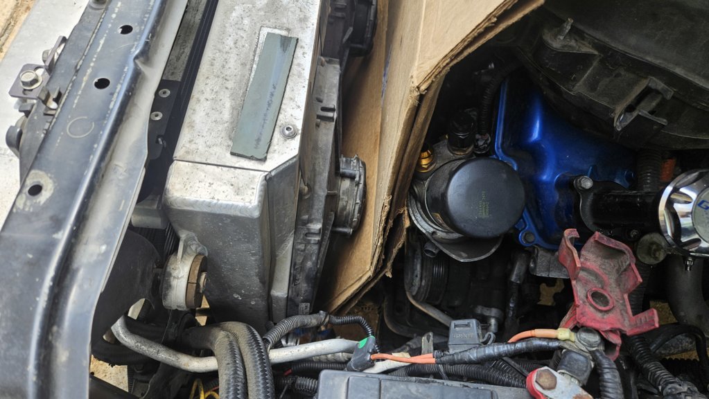

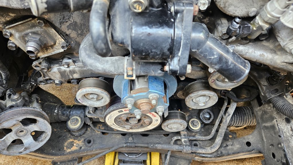

    Like normal Tacoma enthusiasts who love tearing off a timing just to watch the oil drip, I started the project promptly at 10:10 AM.
    Intake tubes off, then draining the sides of the block.

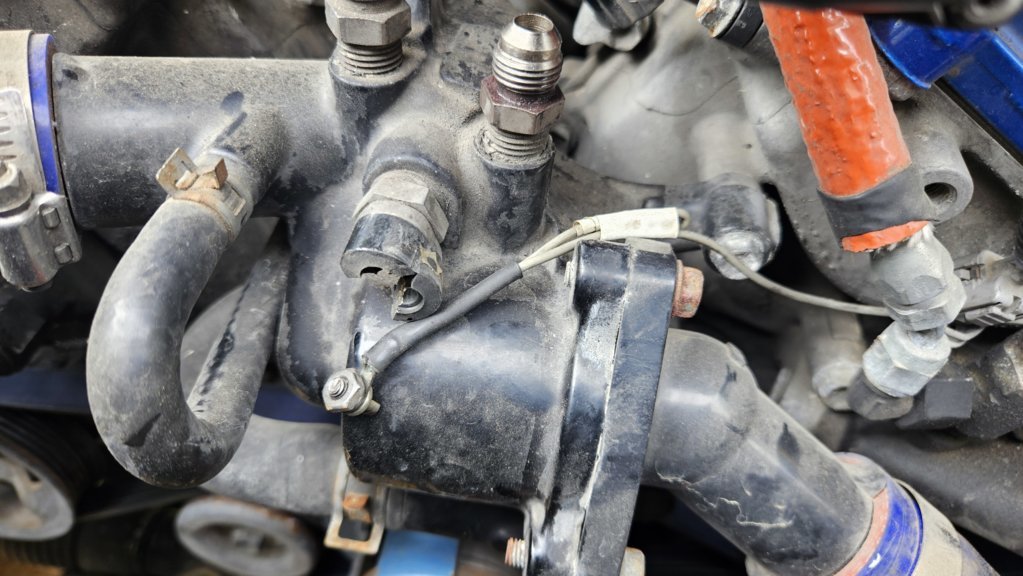

    Then this little switch for the radiator fan, desired to undress for me.
  4. May 17, 2025 at 3:43 PM
    #9284
    Torspd
    Torspd [OP] Tor-nication
    Sep 18, 2009
    #22958
    26,453
    Tor
    The Great America!
    MMVI 4.4L 4x4 Access Cab
    Torspd Custom Turbo kit [] Borg Warner 9180EFR Turbo [] Haltech Elite 2500 [] TiAL Q BOV [] TiAL V44 Wastegate @ 15psi [] CP Pistons [] CP Carrillo Rods [] ARP Head studs [] ARP Main Studs [] ARP Header - Head Studs [] Ported Heads w/ 1mm oversized valves intake/exhaust [] Brian Crower Forged Stroker Crank [] Darton M.I.D. Sleeved Block [] Kelford Camshafts [] Torspd 160* T-stat mod [] APR Large Fuel Rail [] Walbro 460 LPH E85 Fuel Pump [] FueLab FPR [] APR T56 Conversion Kit [] KP RACING Built T56 [] McLeod Racing Custom Twin Disk Clutch [] One Piece Aluminum Driveshaft [] MGW Shifter [] Custom lowering kit [] Ohlins Front Coilovers [] QA1rear shocks [] Custom Ron Davis Radiator [] Dual SPAL Electric Fans []

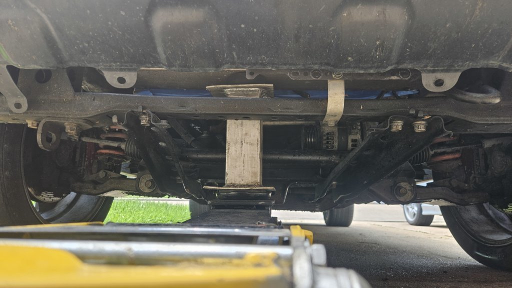

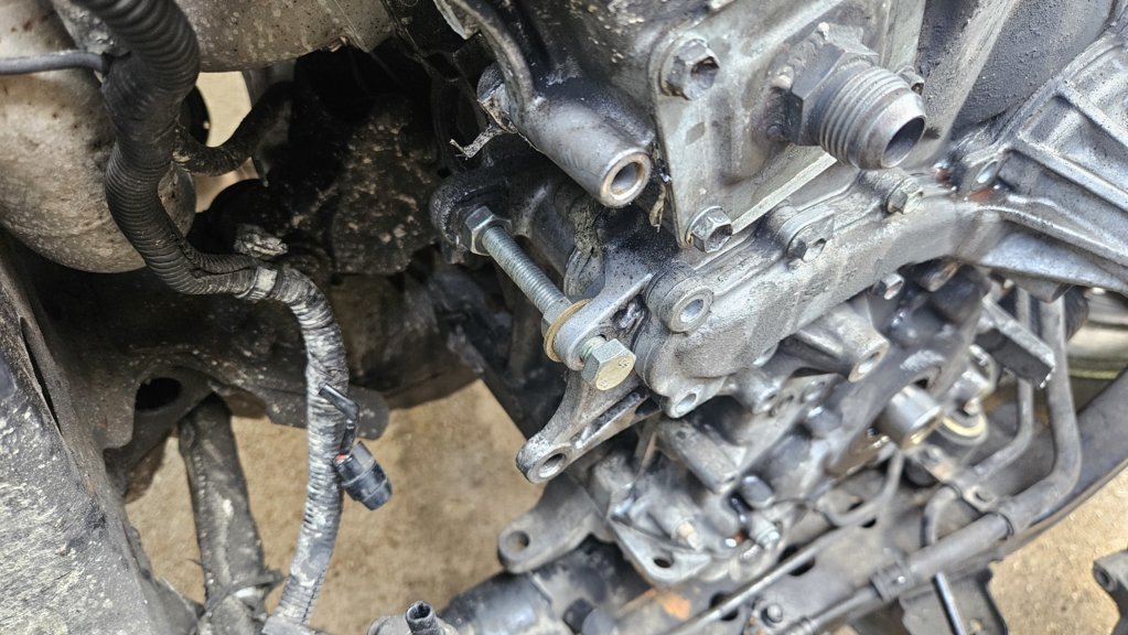

    Not slowing down to worry about something so trivial, I pressed forward.
    The Ron Davis radiator is a heavy lug, even drained. So I added some support underneath.
    By the way, does anyone have a PN for the radiator bushings?

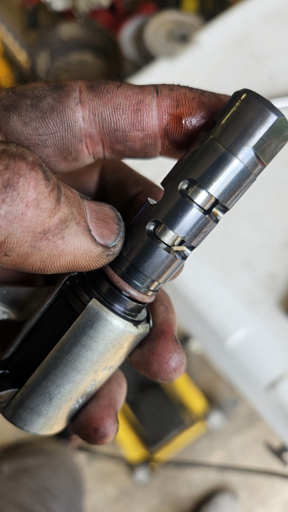

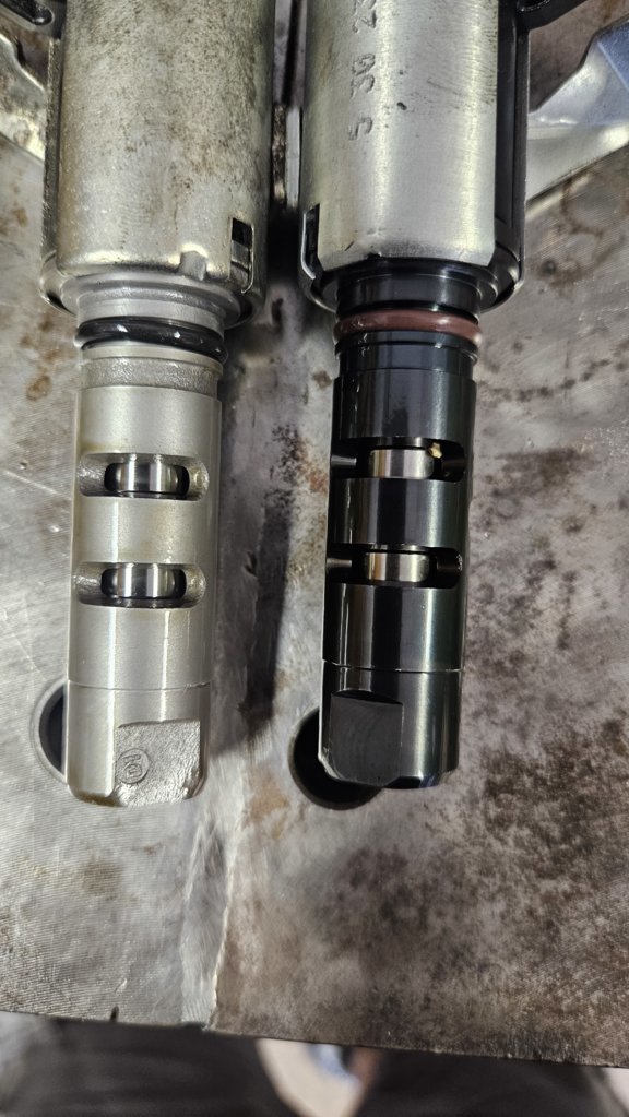

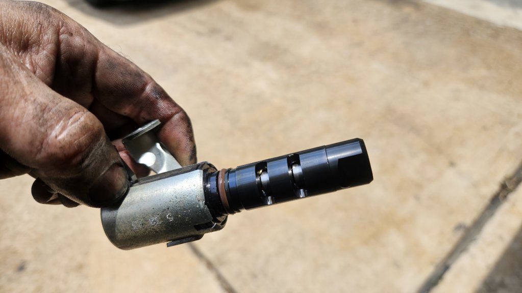

    Once the thermostat manifold was removed, I pulled the passenger Oil Control Valve first.
    Look ever so closely.
    So then I did some testing.
    https://rumble.com/v6tilrn-toyota-1gr-oil-control-valves-testing.html
    You can hear the solenoid try to move the armature, but it is wedged tight.
    I attempted removing the little piece.
    I removed that piece then tested again with the battery. Then found two more pieces.

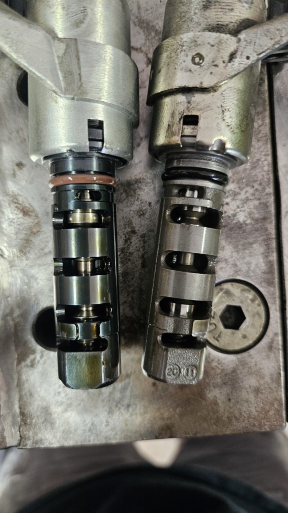

    Maybe it is something internal to this particular brand. It is a Standard Motor Products/Intermotor brand.
    I had some trouble getting a good prying spot, so this little trick helpd a lot to gently pry the timing cover loose.

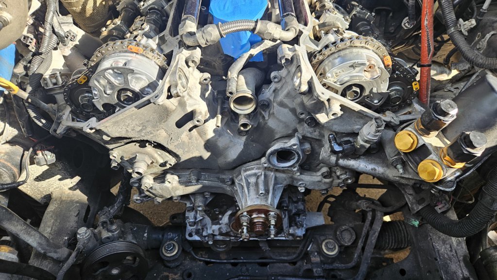

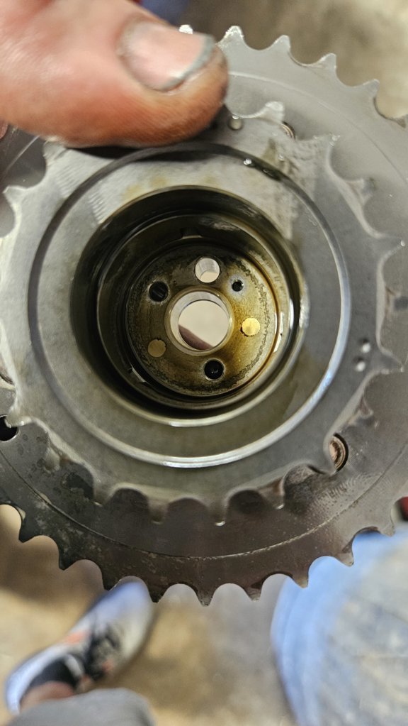

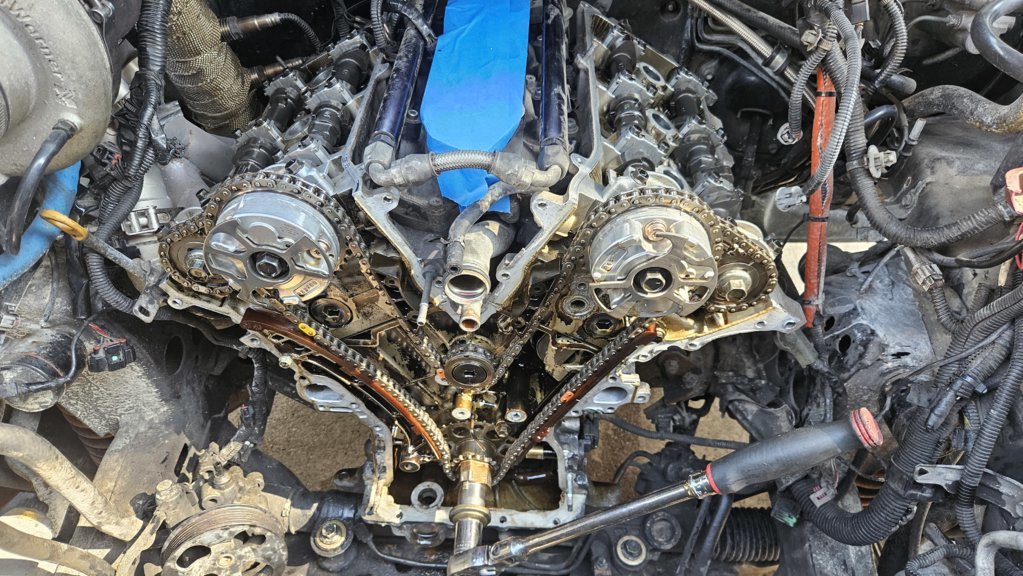

    Timing cover off, my next big question was if I had done a faulty Kelford intake camshafts/phaser installation? Timing all lined up, the phaser came off.
    It has been stuck bothering me in the back of my head, since the install months ago because I didn't remove the timing cover and I thought it could have been my work. I was relieved to learn that my work was sound, but that the new part was faulty, and or the phaser itself chucked one of the white internal seals, that then lodged into the brand new OCV.
    Either way, two new parts are going in, and the timing cover will be freshly sealed.

    Well I figured it out. Went back to that OCV. Shook it by hand, and sure enough the armature jiggled back and forth. Something internal had failed.

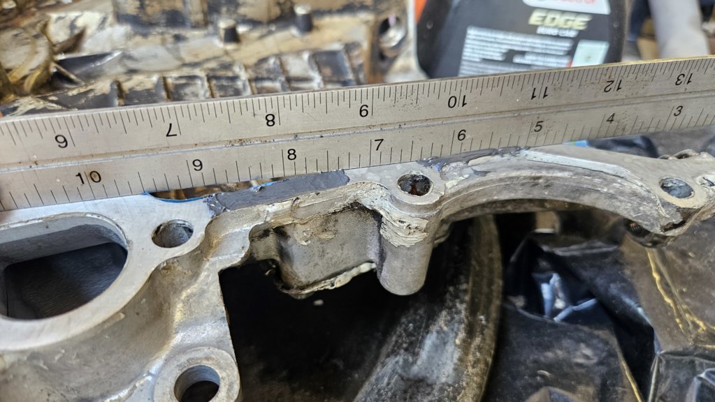

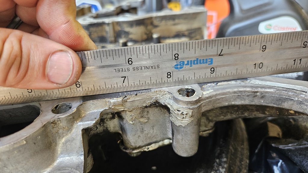

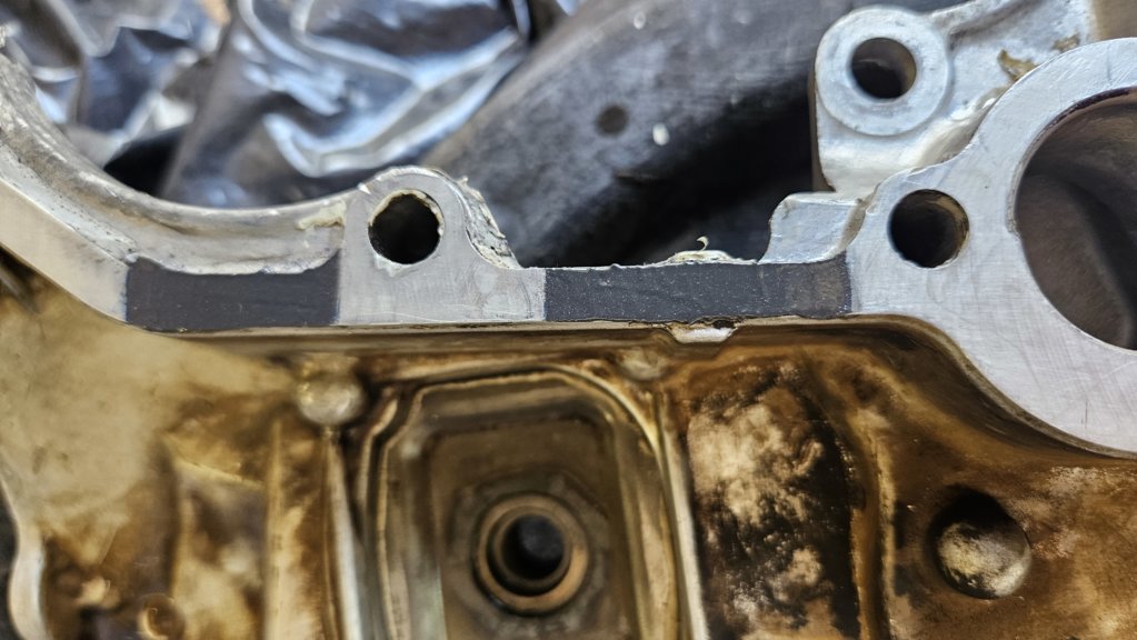

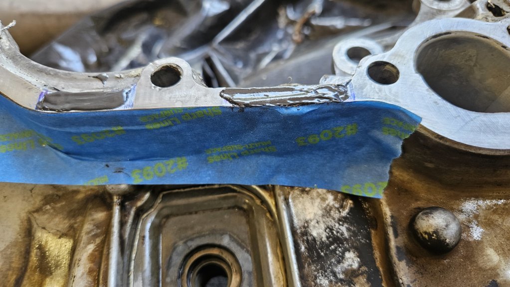

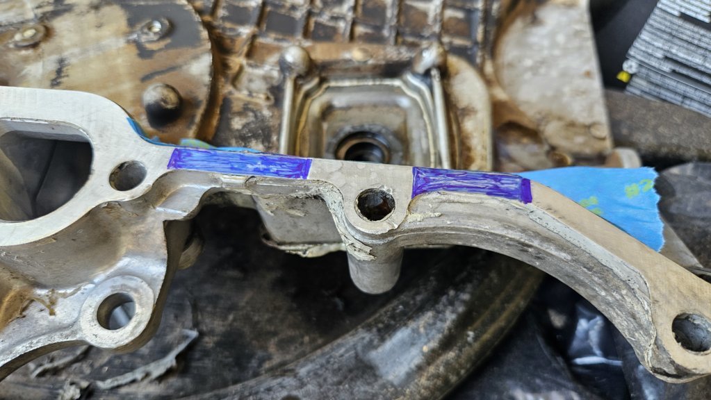

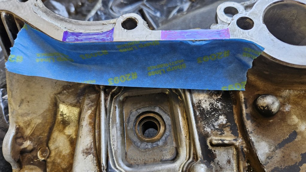

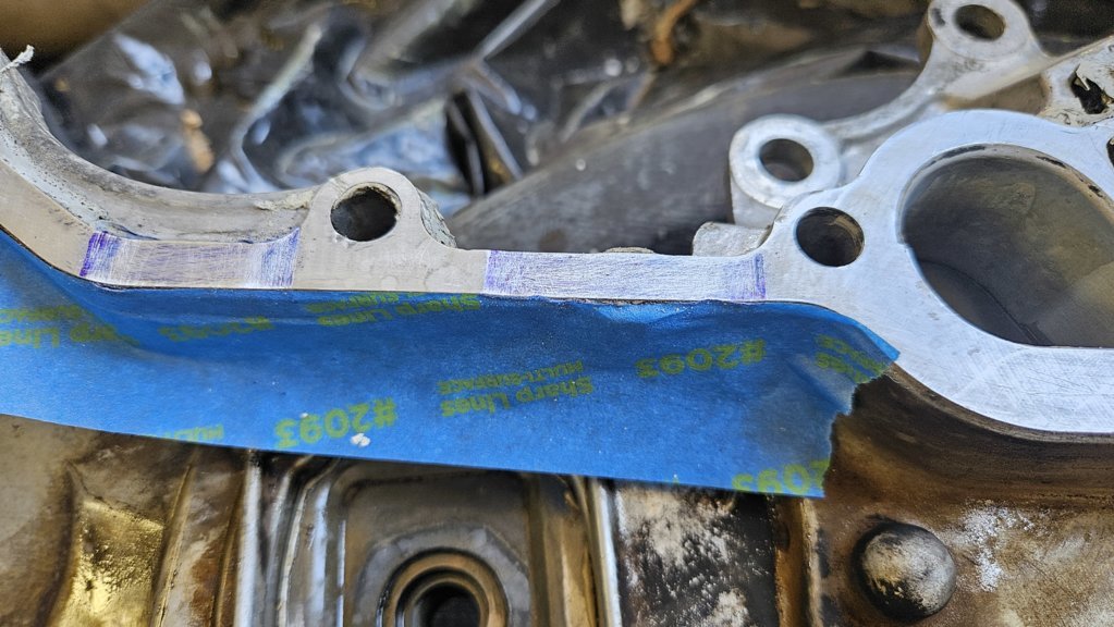

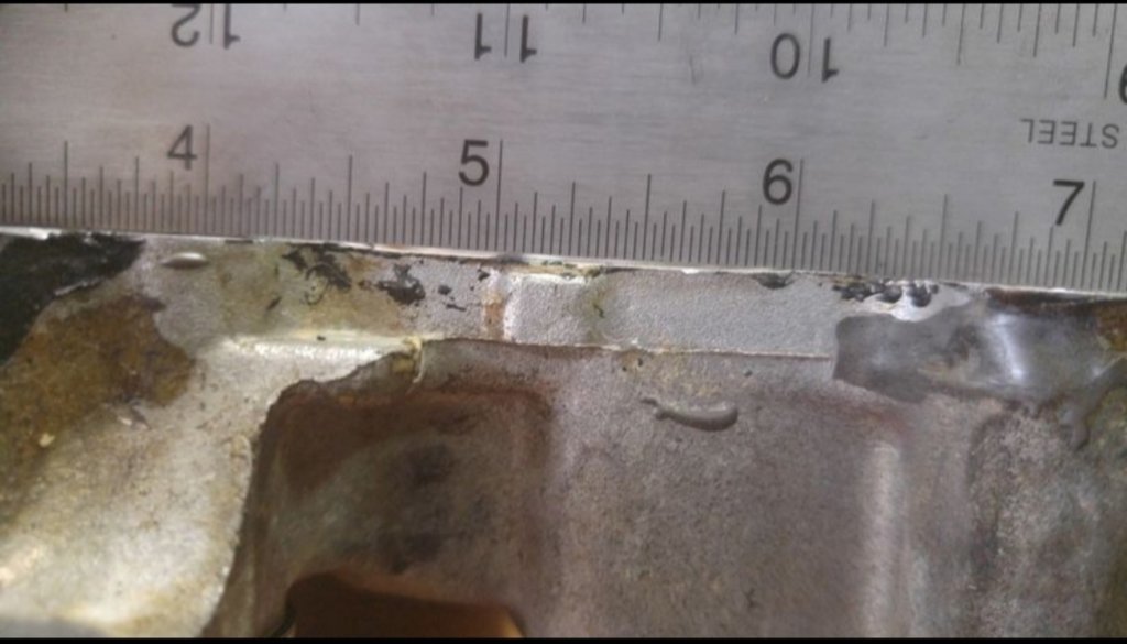

    While cleaning the old silicone off of the timing cover, I decided to finally address the notorious 2005+ 1GR-FE timing cover leak. I've been in there so many times, but never did it. Here are some photos and a video.
    Here are the depressions which created an uneven mating surface. Whether it was intentional to create dealership work, or purely an accident, is unknown to me. Regardless, it is annoying, and can cost a small fortune to have repaired.
    Here I applied tape, and marked the specific areas with sharpie.
    Then I lightly sanded with 120 grit for a better bond with the JB Weld.
    I used a 12 inch ruler/straight edge to clean off the excess.
    https://rumble.com/v6u661b-1gr-fe-toyota-tacoma-timing-cover-leak-fix.html

    Here is a reference of the timing cover, in its original form.
