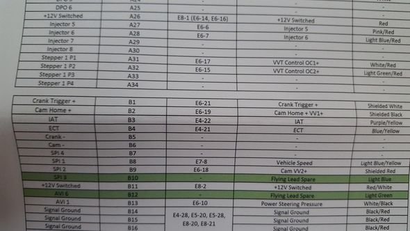

    Just getting the occasional rapid clicking noise from the passenger side. Now I need to check the 12V side for accurate voltage. I already double checked my wiring through the Haltech loom, and it Ohm'd out properly.

    12VDC is supplied from OEM ECU still. Then through the coil. Then back to the E6 plug. Then into the Boomslang harness. Then out to the Haltech. As shown by this pinout.

    Just did a quick test. Removed the plugs from the OCVs. Check for voltage at both pins of each plug, to chassis ground.
    Passenger side had no voltage at either pin.
    Driver side was odd though, that it had voltage on the Blue/Red wire. Not the Blue/white wire.
    Now this makes me curious if this is the same on a "normal" truck?

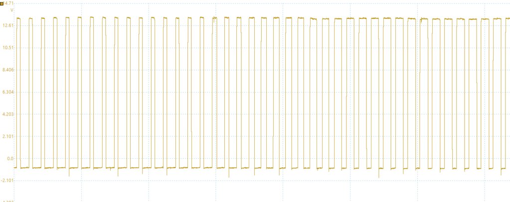

    I'd have to poke around and see if I have any scope captures saved of the OCV control wires, I'll look...
    Torspd[QUOTED][OP] likes this.

    I have one where I'm connected to OC1+, looks like I was incorrect and it is controlled on the Power side.
    ~30% duty cycle with the valve off and ~65% duty cycle with the valve commanded on (scan tool function).
    I can get captures of all 4 wires if you need me to but I don't know when I'll have time to do it.

    This helps a lot!

    This gives me two questions.
    1: what Hz is this?
    2: In the OCV wiring photo that you shared, the wires matched my truck's. What I am now curious of is where the wires' pin and plug locations are?
    In the pinout supplied to me in the earlier photo, the "switched 12v" pins match the positive wires going to the OCV plugs. But what if one of them actually isn't correct? I will test the wires coming out of the OEM ecu this afternoon with a voltmeter, while the engine is running. Then report back.
