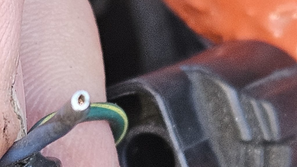

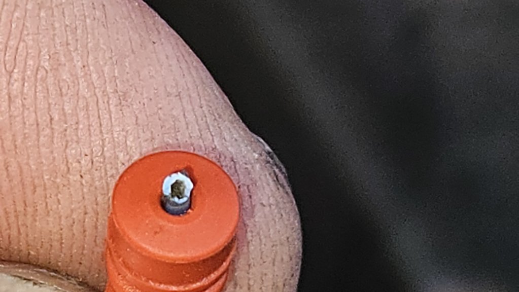

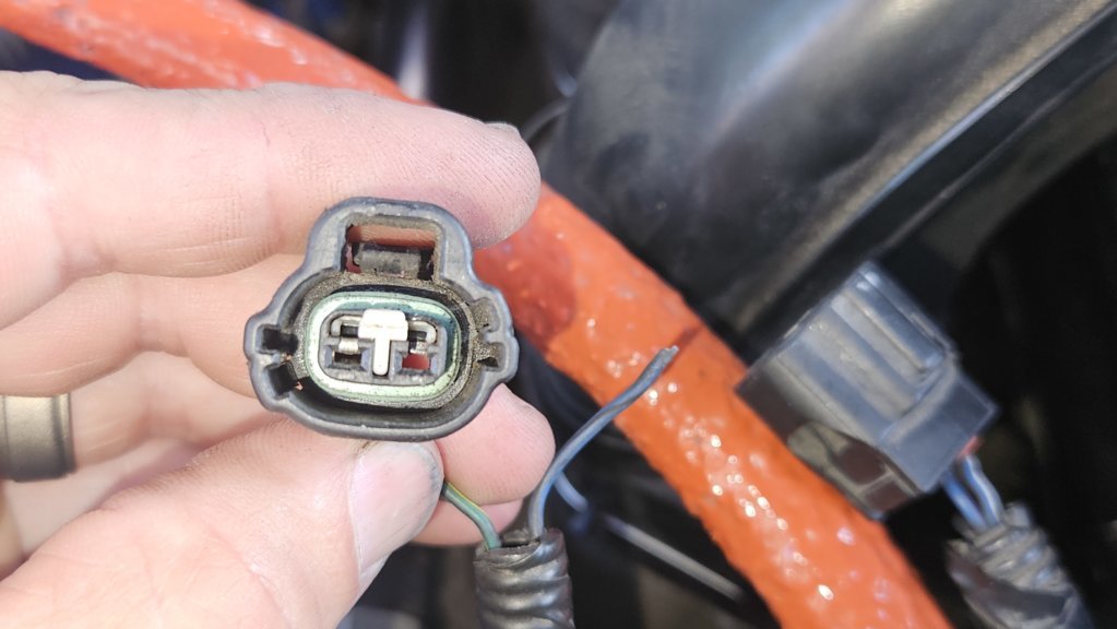

    Alright. I started Ohming out wires again. Referenced to the plug and the pinout assignment sheet. The sheet is correct with the 12v switched and to ground side. Weird though that Toyota has the + and - in the opposite orientation. Whatever, as that isn't a big deal.
    What I did find was that ohming out the driver side OCV from inside the cab, I would get 7.9 - 8.1 ohms.
    When doing the same with the passenger OCV, it was ~13.5 ohms. I found that odd. Went to double check each of those wires and found that there was no longer a reading...here's what I found.
    Looks like all of the rummaging through my engine bay countless times broke the wire and they were barely making any continuity.
    I tested the 12v switched power coming out of the OEM ecu, and it was all good. Now to get new plugs and clean up the wiring.
