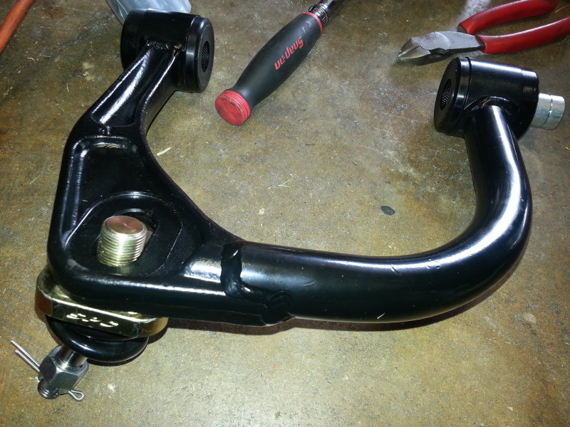

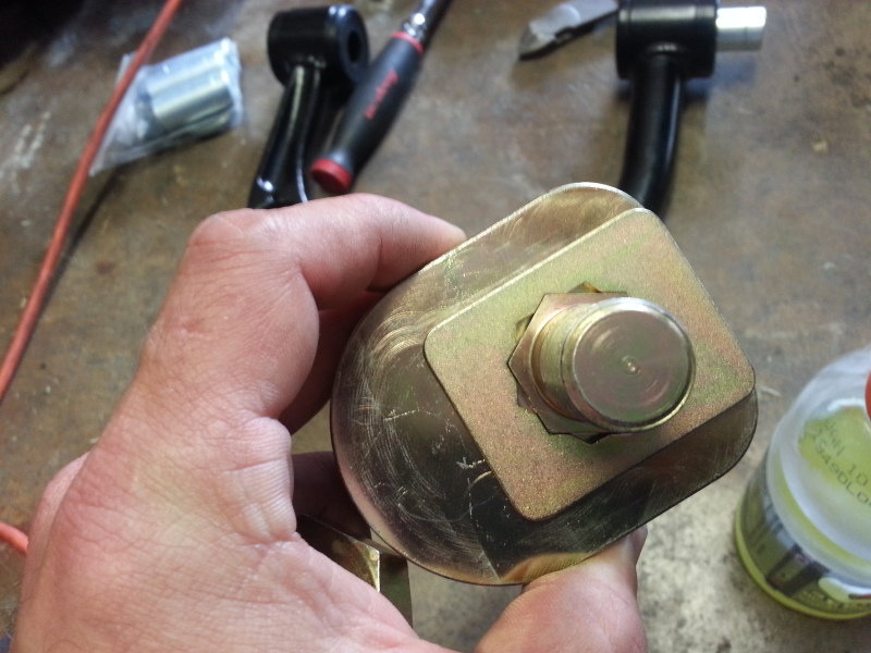

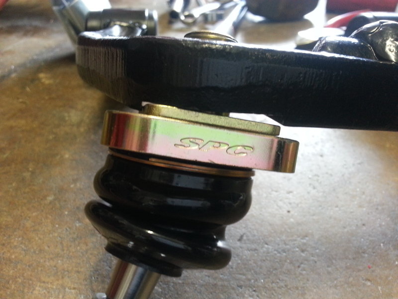

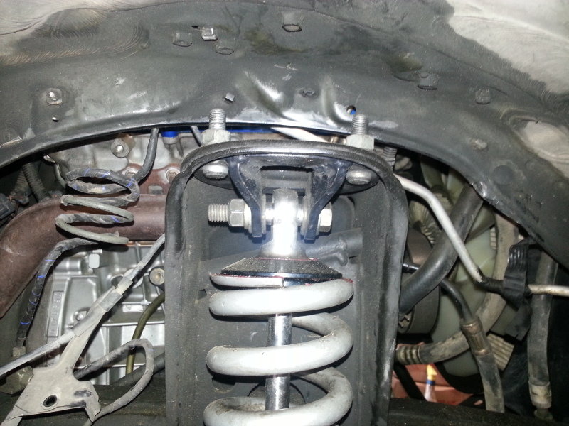

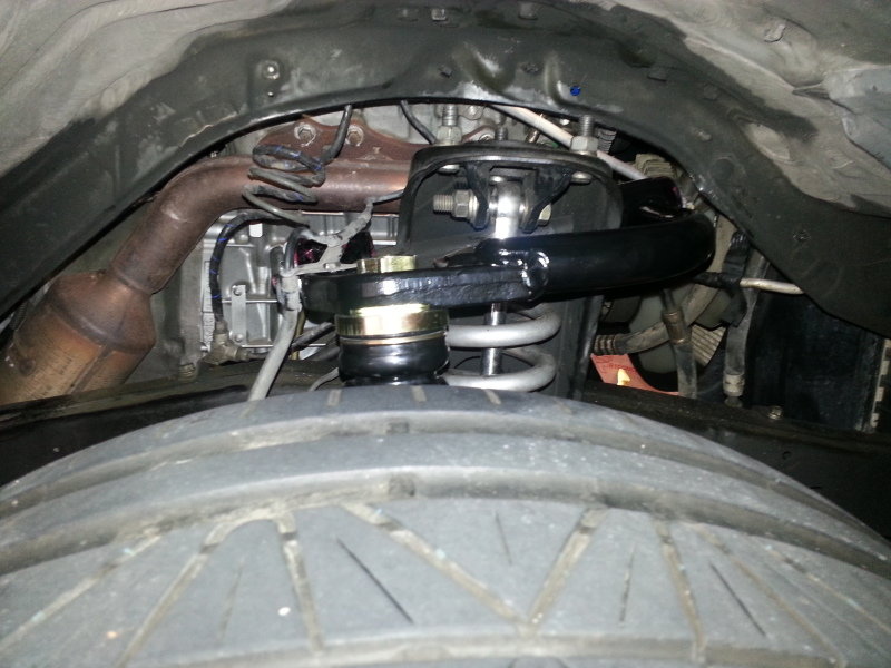

    The latest mod to correct some camber and caster.
    With the aid of my good friend Lucario Runner, we were able to knock them out relatively easy.
    The instructions said that "Position D" should return you to factory caster if you have 2"-3" of lift. Considering that I was just the opposite, I figured that it should work the same for my application. Quite honestly it did. Just barely pulls to the right, but nothing bad. I will say, that it handles soooo much better now. Very well planted compared to before, where it felt like it was on skates.

    Nice! They look pretty good. Are you going to have a shop do an alignment on them or did you do a "carport" alignment?
