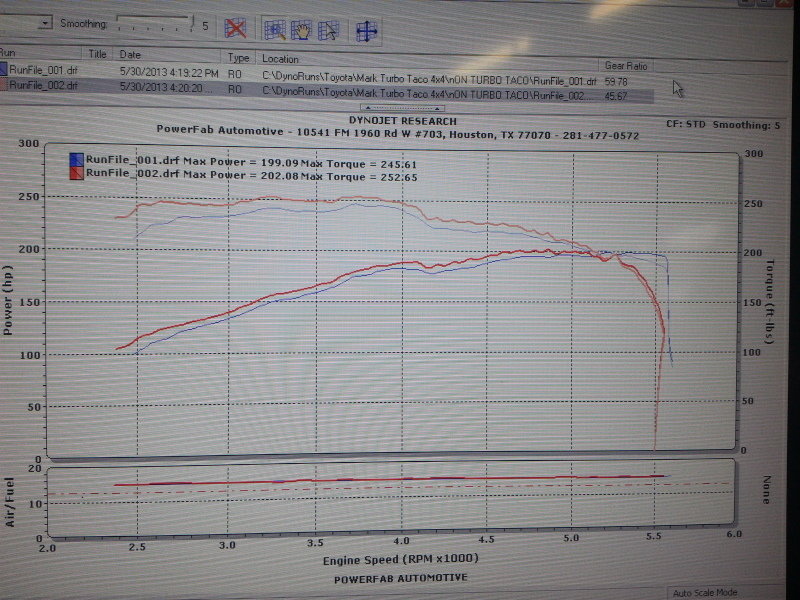

  10. May 30, 2013 at 12:09 PM

  13. May 30, 2013 at 12:54 PM
    #1073
    memario1214
    memario1214 Hotshot Offroad Moderator Vendor
    Oct 1, 2009
    #23628
    20,204
    Colton
    Missoula, MT
    SOLD - 05 Dub Cab TRD Sport 4x4, CURRENT - '21 Tundra MGM Limited
  14. May 30, 2013 at 3:44 PM
    #1074
    Torspd
    Torspd [OP] Tor-nication
    Sep 18, 2009
    #22958
    26,473
    Tor
    The Great America!
    MMVI 4.4L 4x4 Access Cab
    Torspd Custom Turbo kit [] Borg Warner 9180EFR Turbo [] Haltech Elite 2500 [] TiAL Q BOV [] TiAL V44 Wastegate @ 15psi [] CP Pistons [] CP Carrillo Rods [] ARP Head studs [] ARP Main Studs [] ARP Header - Head Studs [] Ported Heads w/ 1mm oversized valves intake/exhaust [] Brian Crower Forged Stroker Crank [] Darton M.I.D. Sleeved Block [] Kelford Camshafts [] Torspd 160* T-stat mod [] APR Large Fuel Rail [] Walbro 460 LPH E85 Fuel Pump [] FueLab FPR [] APR T56 Conversion Kit [] KP RACING Built T56 [] McLeod Racing Custom Twin Disk Clutch [] One Piece Aluminum Driveshaft [] MGW Shifter [] Custom lowering kit [] Ohlins Front Coilovers [] QA1rear shocks [] Custom Ron Davis Radiator [] Dual SPAL Electric Fans []

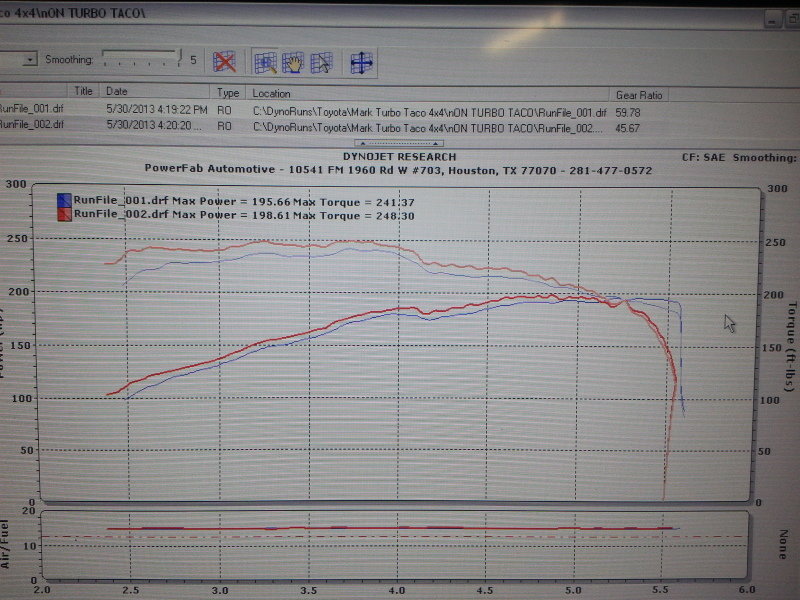

    SAE and STD.
    The first run was in 3rd gear. Second run was in 4th. If you look to the top right, you can see the overall calculated gearing.
    I was expecting the wtq to be a little lower actually. So kind of cool that it was this high.

    198 haha, you were spot on with your guess.
