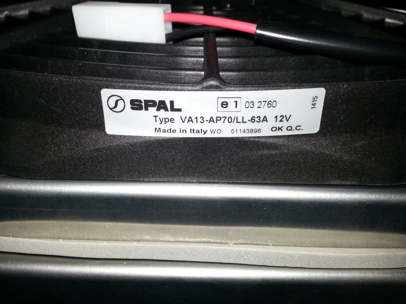

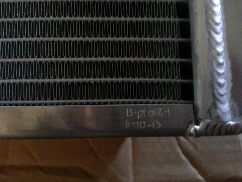

    This is the perfect graph to get an idea-storm off of. That being posted, Intake or exhaust first. Depending on your weather and off-roading conditions, will determine which intake you get. The enclosed box style will have similar gains to the URD intake, except that it is more protected from the elements. That and a set of headers, or Y-pipe would be a good next start. The catback on the '11 is 2.5" already, so unless you want a 3", just replace the muffler to one of your liking. If you get the Y-pipe, you won't need an O2 sim. You will if you get long tubes. They are also cheaper than the short tubes, in the end.
    Born on Date -
    These guys package well. That is a STANT 18 psi Radiator cap.

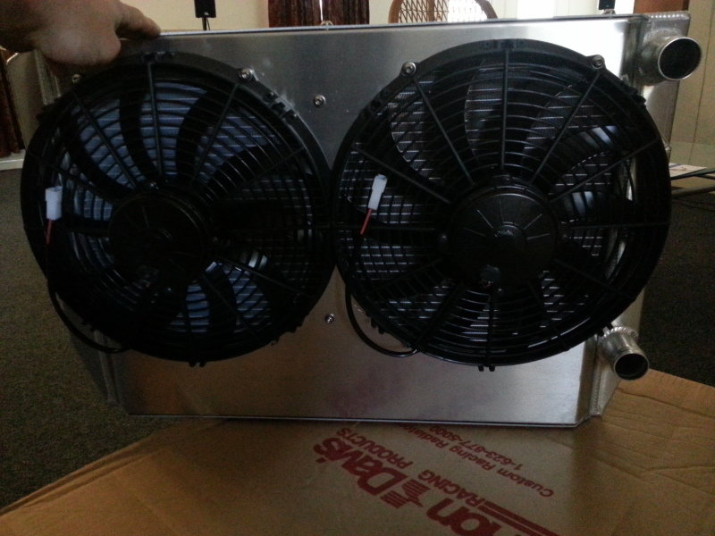

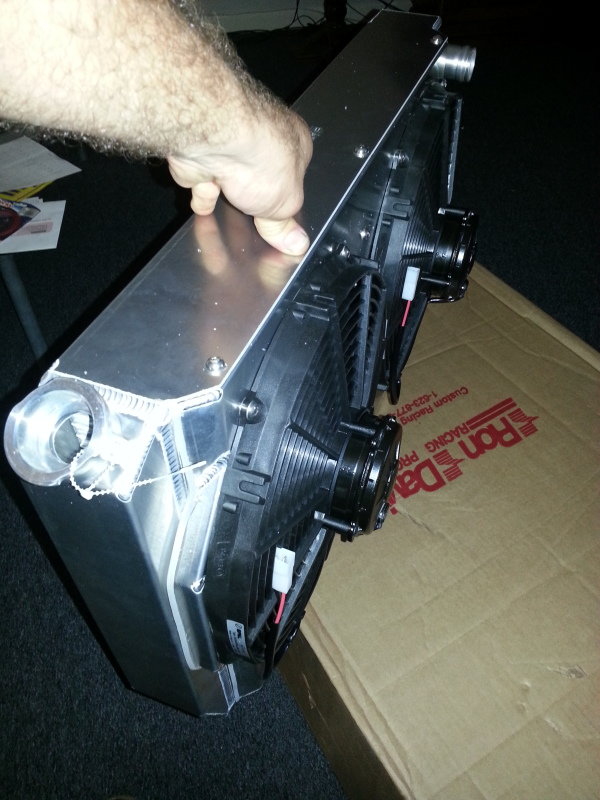

    Any special Modification required to install that???

    Yes, as there are no mounting points on it. Ron Davis Radiators does sell a OEM replacement that will bolt up. I needed something more. There will have to be some re-routing of the lower hose, and whatever is needed to make that happen. Then of course the T-stat/relay harness for the fans.

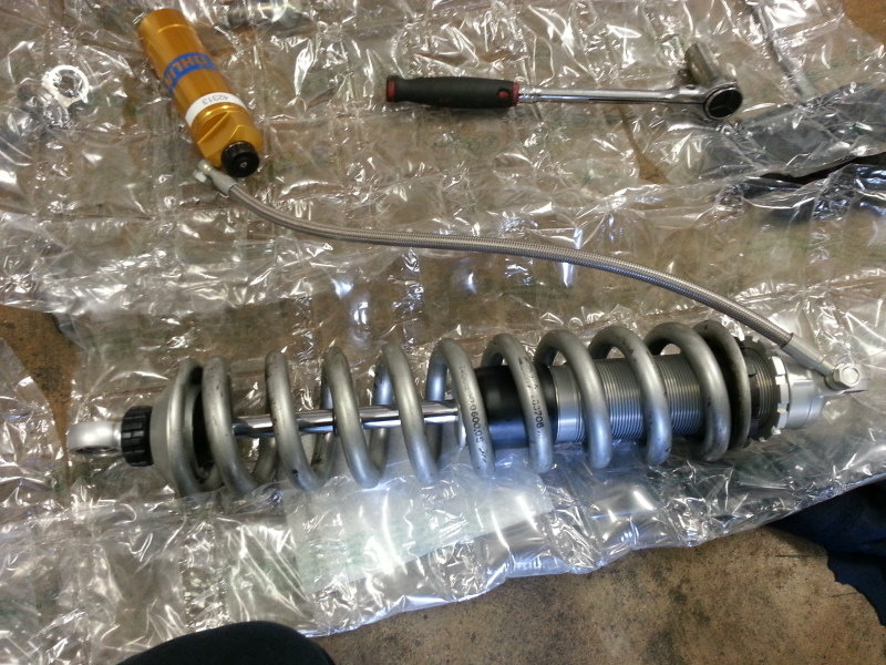

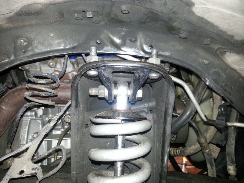

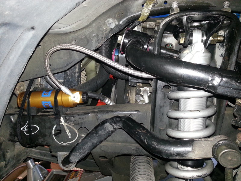

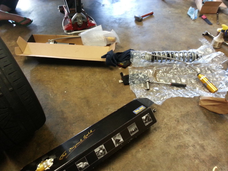

    Put in some wrench time this weekend. Had all of the puzzle pieces to install the Ohlins.

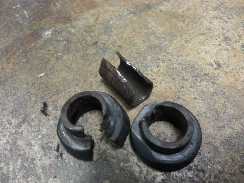

    The uninstall.

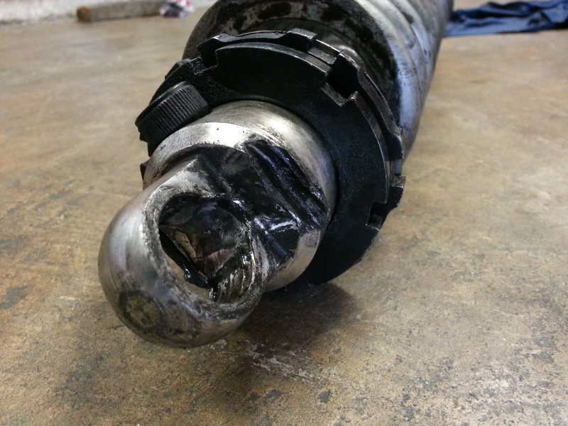

    This is where it gets graphic.

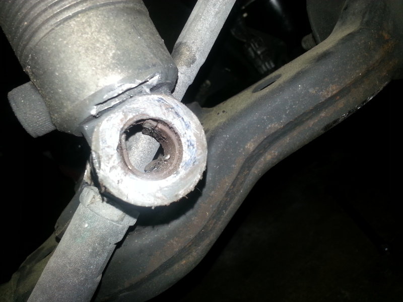

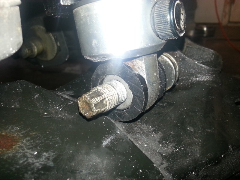

    This is after almost 4 years of useage. Three+ with what worked for the bottom mount. This particular picture is after my most recent bushing/sleeve update, but it was already quite damaged from what came with the QA1 kit. As nothing was a precise fit with the OEM LCA bolt.
    This is what it looked like before and after I changed the bottom bushing setup.
    And here it is with the recent sleeve that perfectly fit the lower bolt. Not an easy part to find, nor cheap!
    The damage was already done to the shock though, but this still worked well for its short stint.

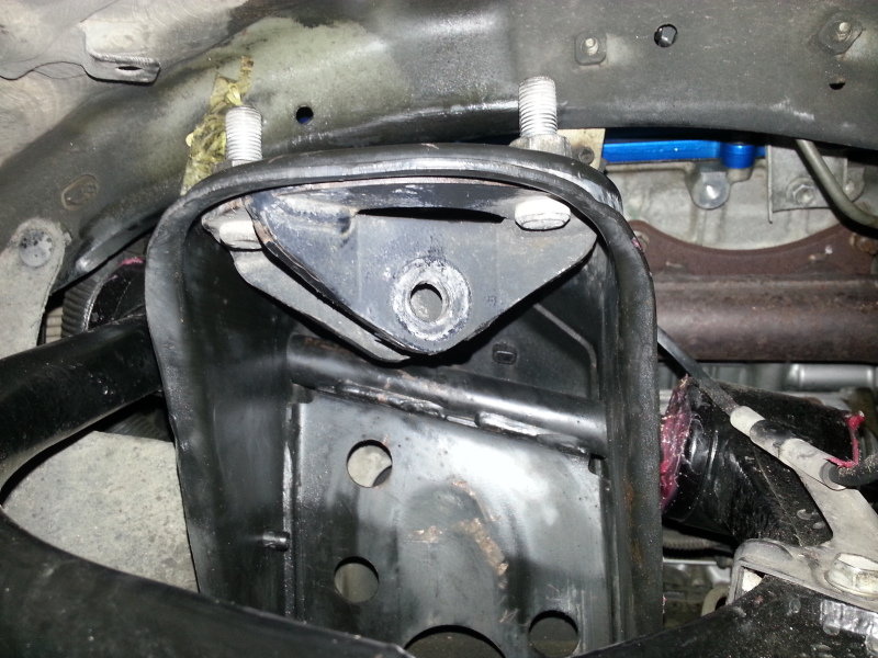

    Cleaned the 2.5" springs and swapped them over.
    More to follow soon.

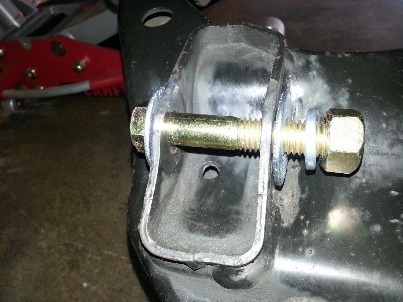

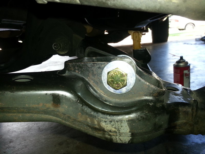

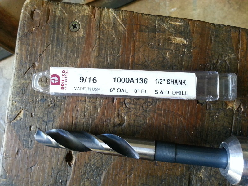

    The I.D. of the "14mm" bearings on the Ohlins, was actually 14.8mm. I am glad I test fit the new OEM bolts prior to installation. Otherwise there would have been to much play between the bearing and the bolt. The best solution was to pick up some Grade 8 9/16" bolts. Since they are 14.5625mm. I may still go back and try a 5/8" bolt still, just because it will be a slightly tighter tolerance.
    Anyway, the 9/16" bolts fit the LCA perfectly. Only had to drill the top mount, since it was 1/2" originally.
    Rotated it to drill, since I don't have a vice.

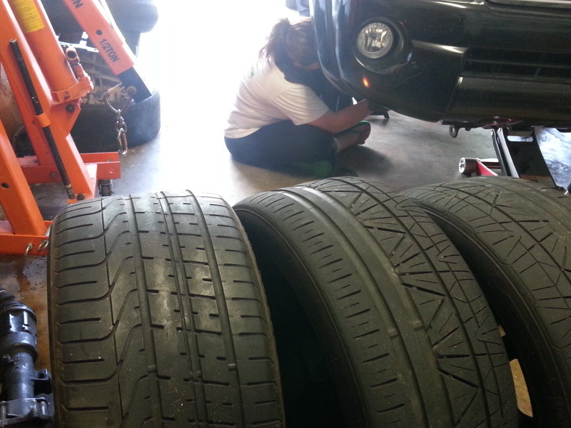

    My girl even put in some wrench time. :D

    I cannot wait to test these out on the track, race truck style. Woot!
    Still have plenty of adjusting to do on them though......
    Compression, on the bottom of the shock, has 40 clicks! Rebound has another 20...... phew...
