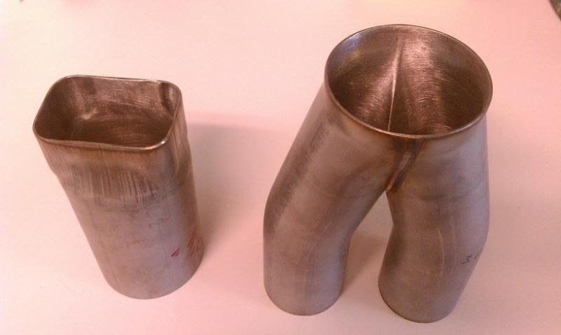

    My setup is different from the ones made by PowerFab. Mine does not have a Y-pipe, but a cross-over to merge collector.
    I do plan on having the driver side header rebuilt out of 321, like the passenger side.

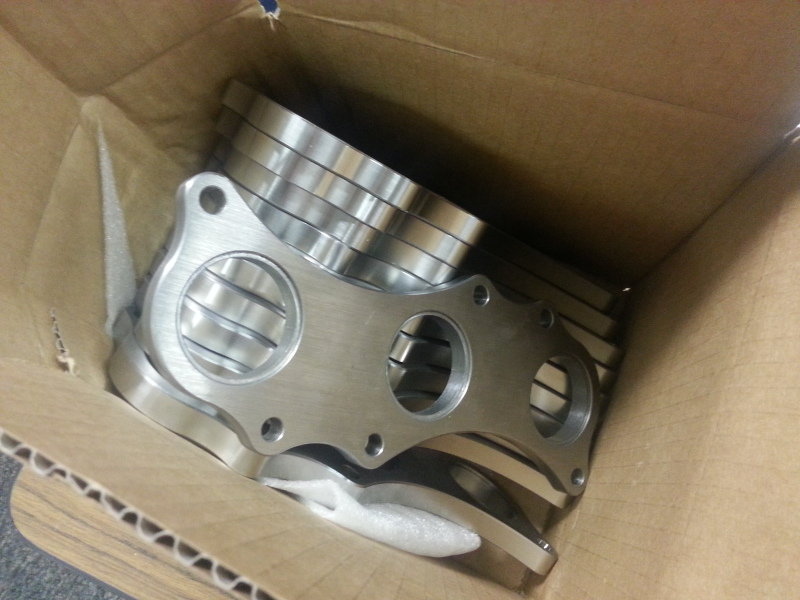

    And since I am the only one, well actually I just sold one set, of 321 stainless header flanges, I am going to have it built with that and not mild steel.
    1.75" primaries to 2.25", to 3" into turbo.

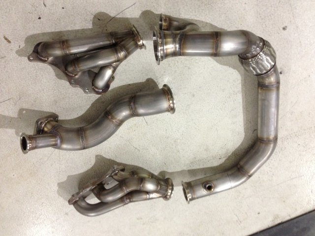

    The only 5 sets of 321 stainless headers.....4 now....
    My "Y-Pipe". Lol

    I want some!!:D haha Don't have the money though. Hoping to drop it all on something like this very soon:spy:

    That looks like the "O" from Demello. :spy:
    Or is it somebody else's work?
    That will be super sexy to have. Better yet, super functional.

    Something for you to check out. PowerFab's
    http://www.xr-underground.com/forum/showthread.php?t=53171

    All-pro, but it is all engage offroads stuff. The leafpack used to belong to All-pro though.

    Damn that is sexy. Clearly I don't know my off road companies that well though. Doh.
    You truck will be even more a beast when that is done!
