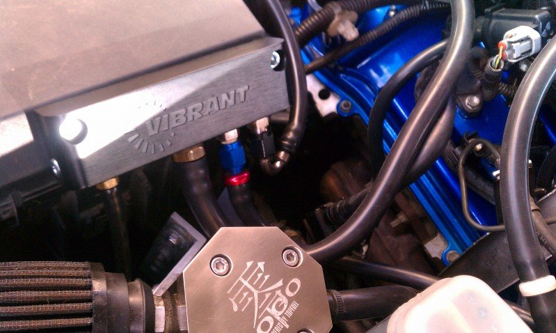

    Hey Tor where did you plumb the vacuum hose from your fuel pressure regulator to when you had the OEM regulator?
    Originally it goes to that little hose tail under the air filter box. Correct me if I'm wrong....but is this before the throttle body and will always be roughly at atmospheric pressure on a NA motor.
    I'm not sure whether to go straight to the intake after the throttle body, then it would see vacuum and positive pressure or just vent it to atmosphere.

    If you are trying to use the OEM FPR in the same manner as an aftermarket rising FPR, then it will need to be plumbed from somewhere after the throttle body.
    There is a vacuum hose right after the throttle body. The close to the port behind the TB is best. Otherwise you will possibly get a pulsation from the solenoid, which is at the other end of that vacuum hose.

    I used a vacuum block to help clean up the birds nest of vacuum lines I have. As it gets rather tricky and extensive.
