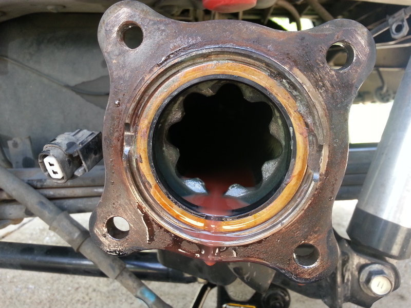

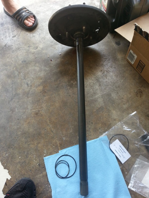

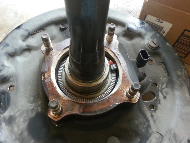

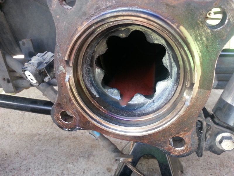

    Two days prior to race day, I decided to install new shoes in the drums. E-brake was a bit incapable of holding the truck completely still. Well when I pulled the drum off, the shoes and drum were saturaded with oil. Gear oil.
    After a little more tear down with the help of 1GRracer, we found the issue.

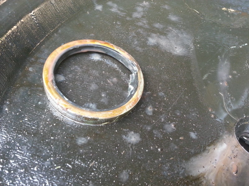

    This seal was bad. Identical problem to what had recently happened to Memario. o_O Decided it was wise to leave the passenger side alone until after race day. Just incase another seal was bad. Picked up the last one from the local Toyota for this side, and replacement didn't happen until Friday, the day before. I was cutting it too close.

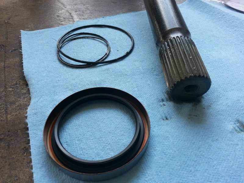

    Removed with the aid of a screw driver.
    Installed the new one, and was pretty much good to go, after a thorough cleaning of the drum, and replacement of the shoes.
    Likely will have to replace that bearing soon though....

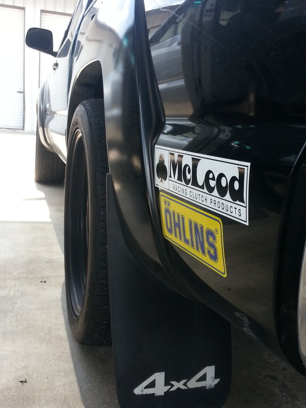

    And finally added some stickers to the truck. :D

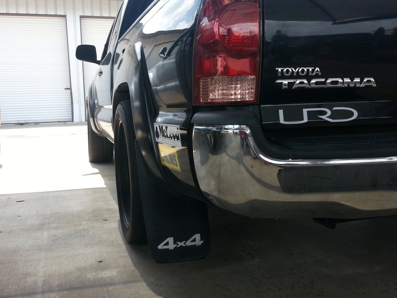

    lol at the 4x4 flaps :laughing: All you need to make it even better are some "TRD off-road" stickers!
    So many awesome memories flood back when i see pictures of other peoples track days!!! especially smells! looking forward to future pics and vid man :D
