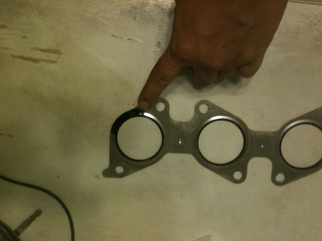

    These pre-production*** Spec-U headers were not completely "bolt-on".
    Didn't have to jack the engine on for the passenger side. Just remove the rear two head - headers studs, like we did on the driver side. Passenger side went on like a champ.
    Driver side had to remove the steering linkage, like you know, but got it all properly back together.
    Had to drill out the hole for the transmission - header bracket, on the header flange. Header- Ypipe flange.
    As well as some of the driver side bracket had to cut out to fit properly when bolted to the header flange.

    You think it was a warping issue when they took the headers off the jig, or was the hole for the transmission mount actually drilled in the wrong place?
  12. Oct 20, 2013 at 4:27 PM
    #1352
    Torspd
    Torspd [OP] Tor-nication
    Sep 18, 2009
    #22958
    26,432
    Tor
    The Great America!
    MMVI 4.4L 4x4 Access Cab
    Torspd Custom Turbo kit [] Borg Warner 9180EFR Turbo [] Haltech Elite 2500 [] TiAL Q BOV [] TiAL V44 Wastegate @ 15psi [] CP Pistons [] CP Carrillo Rods [] ARP Head studs [] ARP Main Studs [] ARP Header - Head Studs [] Ported Heads w/ 1mm oversized valves intake/exhaust [] Brian Crower Forged Stroker Crank [] Darton M.I.D. Sleeved Block [] Kelford Camshafts [] Torspd 160* T-stat mod [] APR Large Fuel Rail [] Walbro 460 LPH E85 Fuel Pump [] FueLab FPR [] APR T56 Conversion Kit [] KP RACING Built T56 [] McLeod Racing Custom Twin Disk Clutch [] One Piece Aluminum Driveshaft [] MGW Shifter [] Custom lowering kit [] Ohlins Front Coilovers [] QA1rear shocks [] Custom Ron Davis Radiator [] Dual SPAL Electric Fans []
    It is actually exactly the same as how the DTLT's with the driver side mount. The header's bracket hole is offset from the hole on the bracket. Which created the crack at the collector flange, which you saw last night.
    So Dremel'd out the ID of the bracket hole, so that when tightened down, it doesn't put the header in a bind. I had to do this on my 1st Gen DTLT's as well.
    I forgot to mention earlier, I had to drill out one of the driver side header to Y-Pipe flange holes. They didn't line up, even when everything thing was still loose. Had to be done.

    as for the bind really the issue is with doug thorley as these brackets line up fine on oem manifolds. The driver side was in such a bind that it both caused a small crack on the welds at the flange making a exhaust leak at the y pipe connection AND at the last cylinder as shown on the gasket.

    that crack at the flange really surprised me.

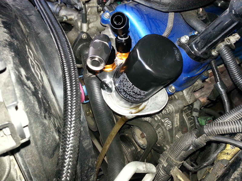

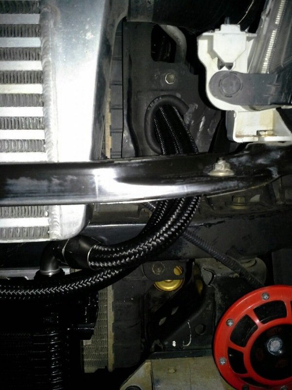

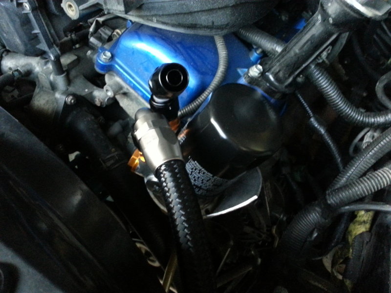

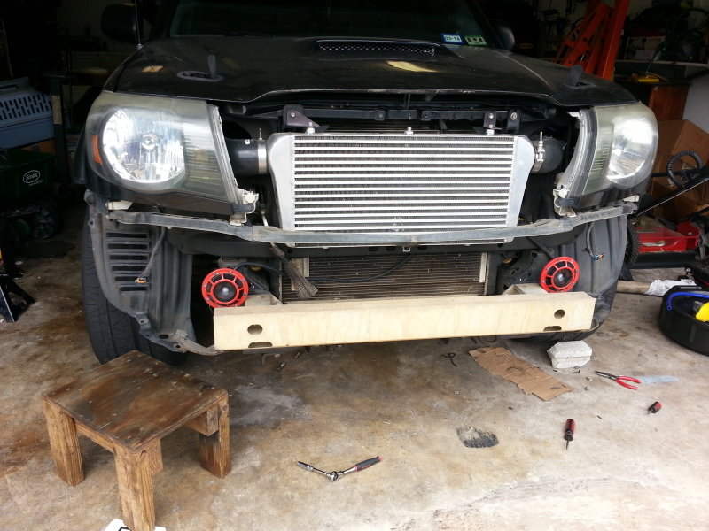

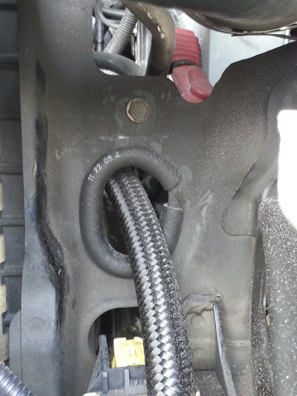

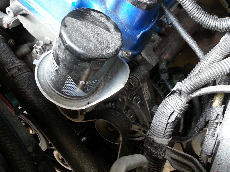

    The count down to MSR Houston, on November 30, has begun.
    Trying to knock out some mods before then. One, is finally complete, minus lower supports.
    The External Engine Oil Cooler. :woot:

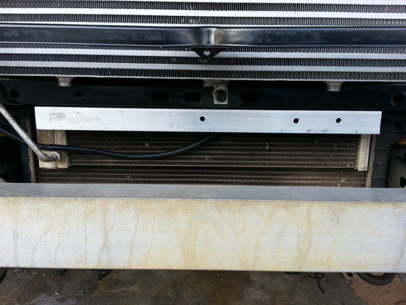

    This is the best place I could find to mount the 1/8" thick aluminum angle. Due to the height of the cooler and the thickness. There are some holes in the sub-frame which I used with 10mm bolts.
    Trimmed the shield so that in case I need to rotate the sandwich plate in the future, I will have the ability.
    Going to re-cut another piece of hose completely cover the sheet metal.
    All together.
    Need to add some thick angle to mount the bottom to the frame cross-member, and it will be all finished.

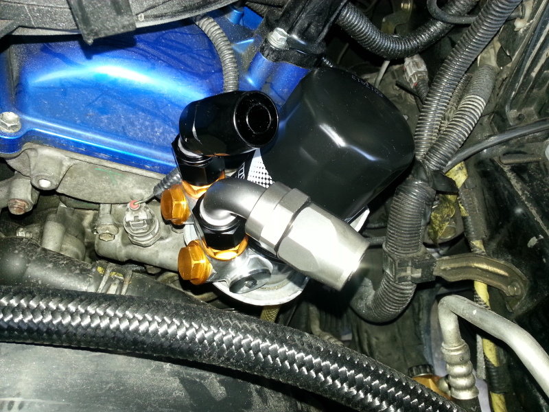

    Maybe I am wrong here but I thought these had a factory oil cooler on them. I see the reason for going to a bigger one but if we had an oem one couldnt you have just used those oem ports for the lines rather than fabbing something up at the oil filter?
  20. Oct 28, 2013 at 10:16 AM
    #1360
    Torspd
    Sep 18, 2009
    #22958
    26,432
    Tor
    The Great America!
    Only if you ordered the tow package, or purchased it later. It is a water cooled cooler.
    You cannot do like you asked because the oil doesn't go through the ports. Coolant is pumped through and the oil passes over heat sink fins internally. So oil would never be able to flow to an external cooler.
    The adaptor I have is specifically for EOC use. It is also thermostatically controlled.
    http://www.shopgreddy.com/accessori...ter/adapter-oil-cooler-block-3-4-x-16unf.html
    Interesting factoid. The TRD X-Runner uses both water and air oil coolers.
