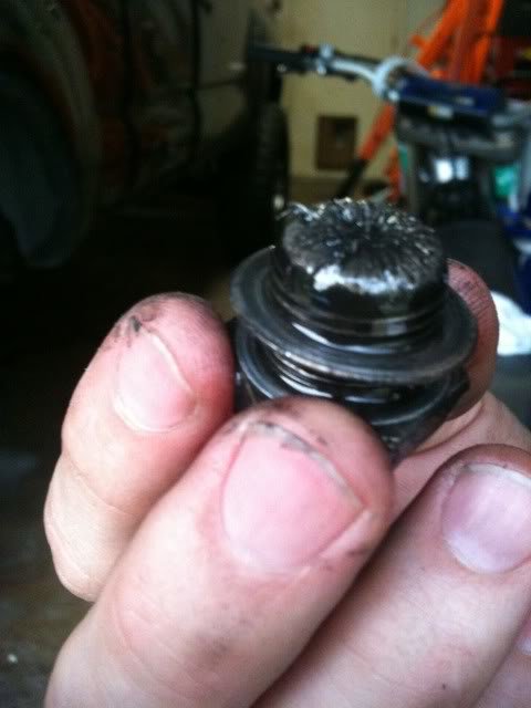

    Interesting development happened last night. I found out that oil is leaking out of the block, on the passenger side. Between the head gasket and deck of the block. :/

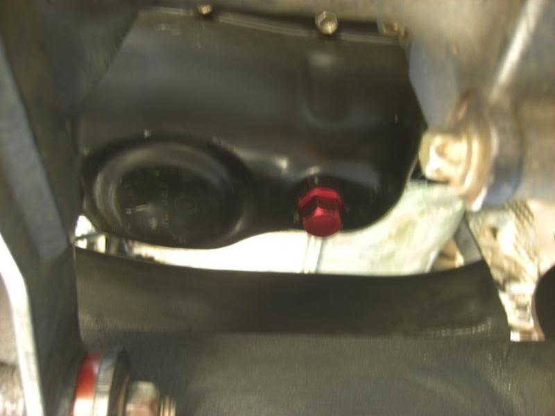

    Here are a few other mods that were done around the same time as the turbo upgrade.
    Titek Magnetic Drain plug.
    The interesting thing about my year model, is that it did not come with a magnetic drain plug. My truck is an '06. I think in mid '08 or '09, Toyota started installing from the factory.
    Greddy Radiator Cap, for a little higher pressure.

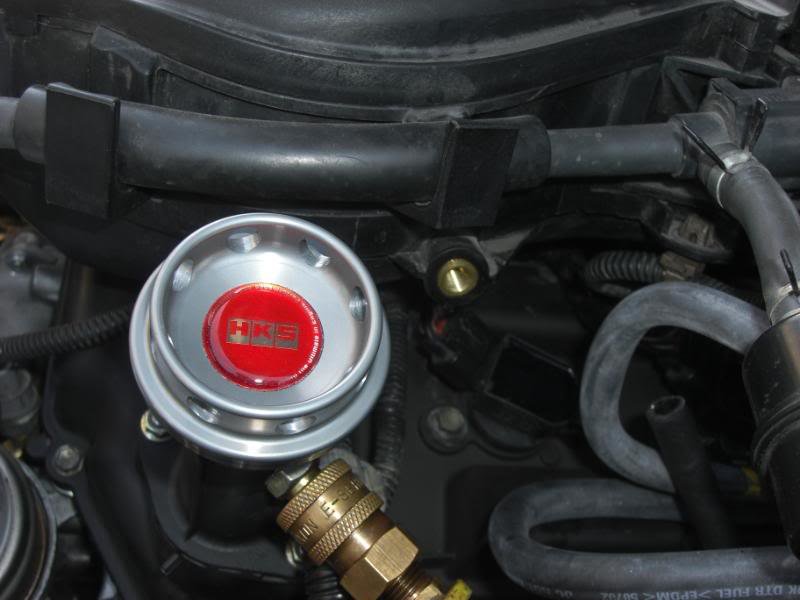

    And an HKS oil cap. I still need to swap that out to a Greddy one as well.
    The line you see going into the oil fill tube, was for the oil return from the turbo.

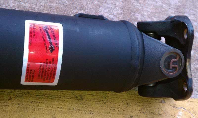

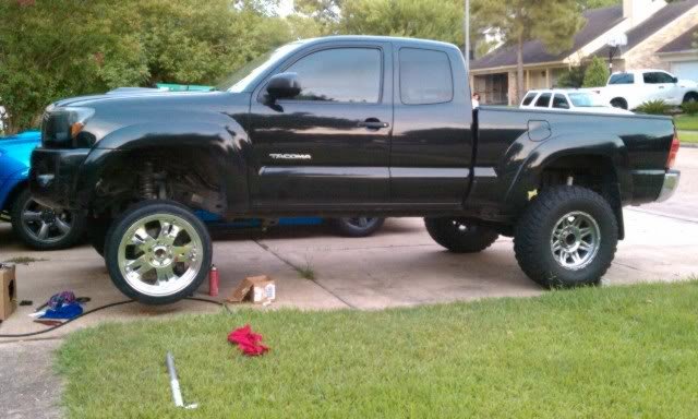

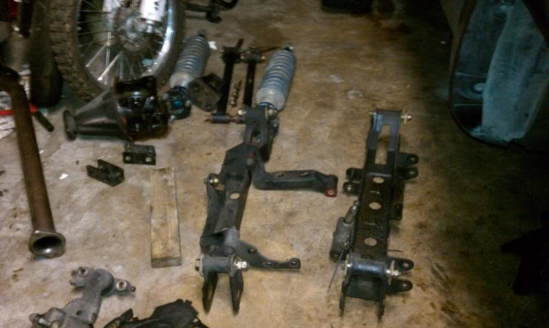

    One month later, June 2010,....I am driving home from work. I come to a stop sign and feel a "lunge" from the rear of the truck. Not sure what it was, I take off slowly, senses on high alert. I had never felt anything like that before.
    All of a sudden, I feel the back of the truck bouncing. Badly. I had to pull over, and get my truck towed to Toyota.

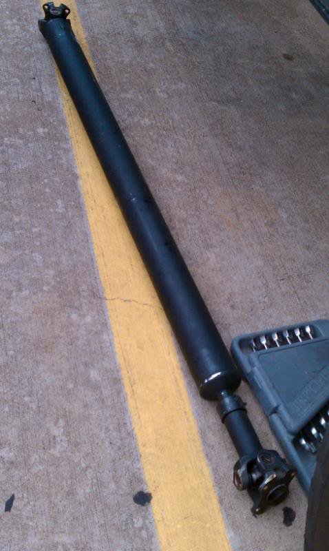

    They diagnose the "problem" as a bad carrier bearing, and worn out U-joints. Said that I need to replace the drive shaft, for a mere $1600. Pfff F that! So I called up Northwest drivetrain, here in town, gave them some measurements, and had one made, for $468. Much better deal.
    It is a 3" diameter, one piece drive shaft. Steel. Very nice, and weighs only 29 pounds. Felt like less than half that of the factory one.
    Get to Toyota, and install it. Don't even get it out of the parking spot, backing it up, and there is a huge knocking noise again. Same as I had heard earlier. I had the manager to drive it. They did not even think about ring and pinion being bad. Never even looked at it. That was the whole problem the whole time.
    Because of that, they had it towed to my house for free. Not willing to purchase a new ring and pinion, or 3rd member from Toyota, I ordered a used one. Cheaper than all the other options. Here is the damamge.

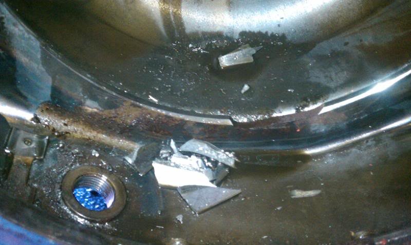

    Torspd Custom Turbo kit [] Borg Warner 9180EFR Turbo [] Haltech Elite 2500 [] TiAL Q BOV [] TiAL V44 Wastegate @ 15psi [] CP Pistons [] CP Carrillo Rods [] ARP Head studs [] ARP Main Studs [] ARP Header - Head Studs [] Ported Heads w/ 1mm oversized valves intake/exhaust [] Brian Crower Forged Stroker Crank [] Darton M.I.D. Sleeved Block [] Kelford Camshafts [] Torspd 160* T-stat mod [] APR Large Fuel Rail [] Walbro 460 LPH E85 Fuel Pump [] FueLab FPR [] APR T56 Conversion Kit [] KP RACING Built T56 [] McLeod Racing Custom Twin Disk Clutch [] One Piece Aluminum Driveshaft [] MGW Shifter [] Custom lowering kit [] Ohlins Front Coilovers [] QA1rear shocks [] Custom Ron Davis Radiator [] Dual SPAL Electric Fans []

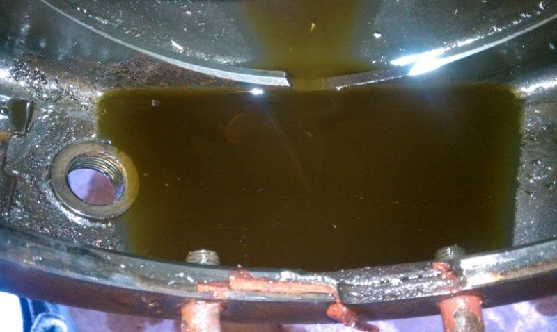

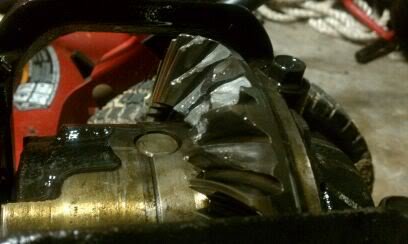

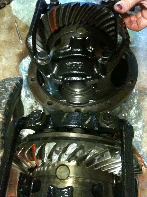

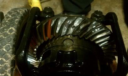

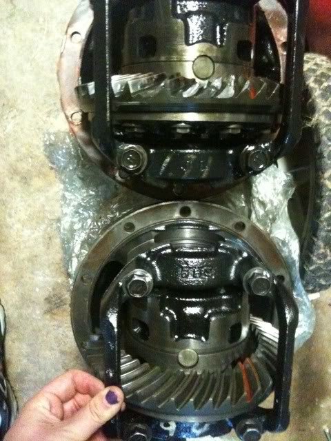

    Here are a few more pics of the ring and pinion failure.
    What I will imagine that contributed to the ring and pinion failure, are a few things.
    Axle wrap, weight of truck @4500 pounds, larger rotating mass from tires 35", years of off roading, and ~500 ft/lbs of wheel torque. Combined, it is easy to see, that that is a destruction stew.

    Yeah that'd definitely do it. Are you also re-geared or just running stock 3.73 gears?

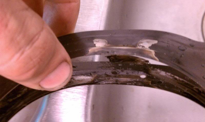

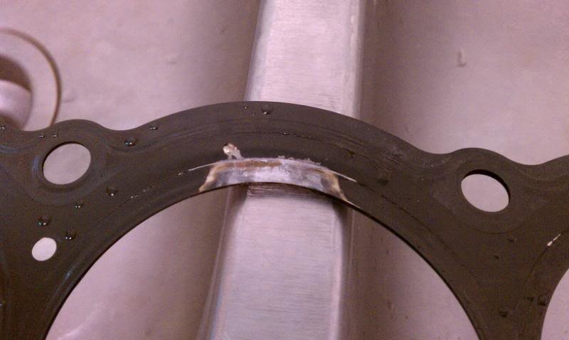

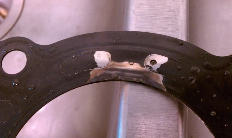

    As I was coming home from work one day, there was a loooooooooong open expanse in front of me. No cars to be found. What the heck. Down shifted into fourth and opened it up. Shortly there after, i felt some pinging and truck was stumbling like it was running with a spark plug disconnected. Smoke started coming out of the exhaust. As soon as I saw that, I knew what it was. I looked down at the Scange Gauge II and saw the coolant temp rise to 198*. As soon as I saw that, I pulled it over and shut it off. Had a friend tow me home.
    Once I got it home and popped the hood, I could see that coolant had blown out of the reservoir. The only next thing was to pull the spark plugs and see which cylinders were the bad ones.
    That was the week prior to 10-7-10.
    The center cylinders on each bank, # 3 on the passenger side, and #4 on the driver side. Both of those plugs had coolant on them. It was time to buy some new head gaskets.
    Here are the pics of what was found.......
    Spread apart, you can see the thin middle layer. It had blown back!
    At the time that I had this engine built by LCE, I hadn't heard of the company Cometic making their head gaskets, for the 1GR. That is why I went with the factory ones. Luckily though, at this point in time, I was certain they had some. I ordered them just as soon as I had pulled the plugs because I knew they would be needed.
    Crom likes this.

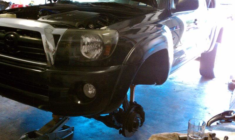

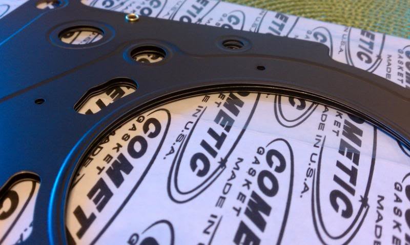

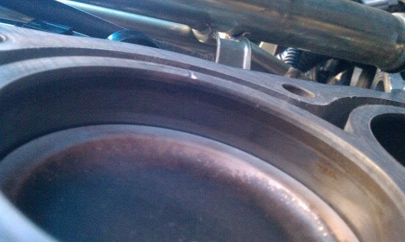

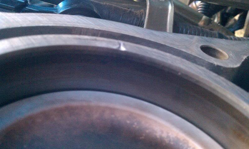

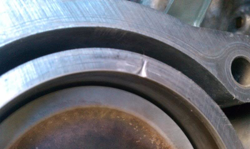

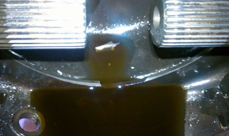

    Those pictures of the OEM head gaskets were after I had ordered the new Cometic ones. Like I had mentioned, I ordered those before I did the tear down.
    When did, not only did I notice the head gaskets being blown, but I also noticed something else. Something that scared the crap out of me.....
    This!
    Combustion gasses steaming the coolant, melted the deck.
    Best way to fix it.....get a new block. (At the time)
    Being at wits end, I decided, "F* it. Selling the truck once I get it back together."
    So. I did what any body would do when they needed a quick fix. JB Weld to the rescue!
    Filled in the spots on both sides. Let it dry for day then did it again, just to make sure. Let it dry. Once all dry, I "machined" it with a razor. I mean, what's the point of going through all of the extra work and labor, and more time down, when it is going to be sold anyway? Wash my hand free of it.

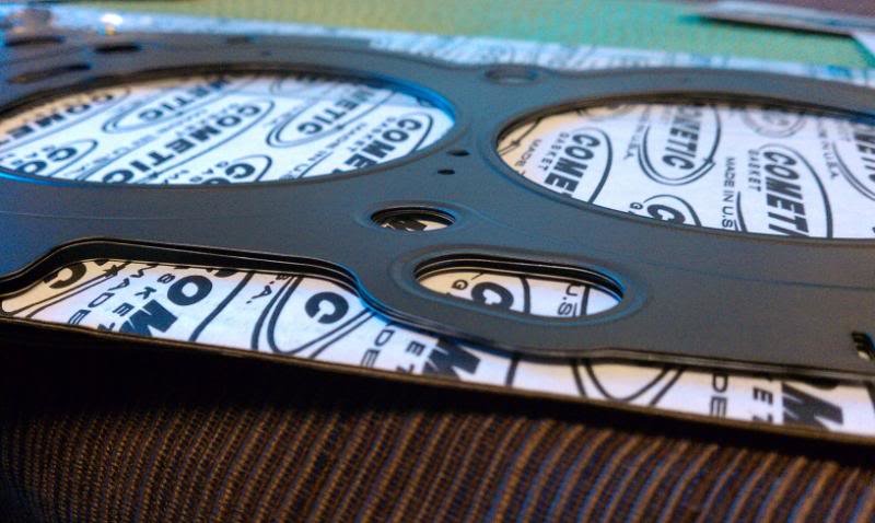

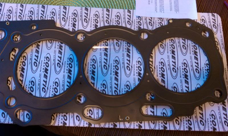

    With the Cometic gaskets in hand, it was time for install. Here is what they look like. Notice how much thicker the middle layer is compared to the middle layer of the OEM ones.
    ebuyaer2002 and Crom like this.

    New set of Cometic head gaskets will be here this week for the head gasket swap of my spare engine, as well as the head studs, that arrived on Saturday. Going to be a busy weekend, with TX2k12, Lonestar Drift series at Gulf Greyhound Park, and me working on my dang truck. Hopefully all goes well and i will have it knocked out and back together before Saturday.

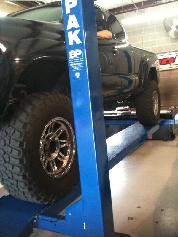

    Here is where the the phrase "form follows function" comes into play.
    After the problems with the driveshaft, and third member, (actually before that I had been planning it) I finally followed through with lowering my truck. It had been in my mind for a while. Due to the stresses on the drive-train, due to the power output, from the weight of the truck, as well as from the large diamter and heavy wheels/tires, it was a clear that I would need to reduce some of those stresses. Lowering would give me better handling, and the lighter wheels and tires would reduce the rotations mass, thus lowering the torsional stress on the axles and ring and pinion.
    It took a long time to find a set of wheels that were not only Forged, but also had the proper offset, proper bolt pattern, as well as an acceptable width; all in a reasonable price. These are what I came up with.
    Centerline Mojave. 20x9.5 with a +19 offset. Paid $500 each.
    Trust me, I looked and called every one I that I could think of. The next option is a set of HRE's. Those are just crazy expensive.

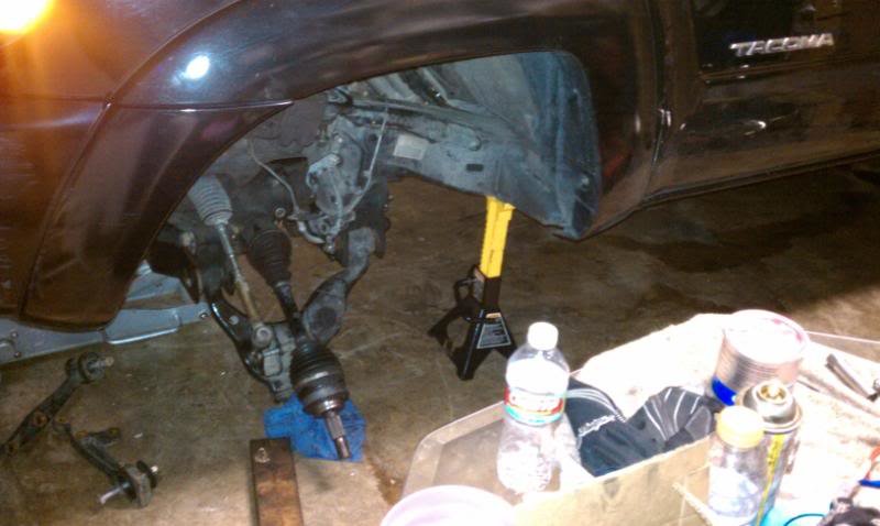

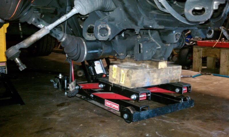

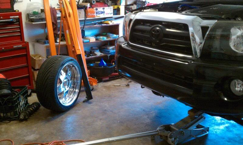

    I made a deal with a friend of mine, and ended up getting his VIS Carbon fiber/fiberglass hood out of the deal.
    These are the pics of the transformation.
    First. A tester just to see, and get a kick out of how it looked. As well as give it a quick spin before the drop.
    That tire was an Vredestein Ultrac Sessanta 275/35 R20.
    With all four on, it looked funny as hell. I was determined to give it a little test drive though. Holy smokes, it felt so much quicker. So then it became time to tear it down.
    Being that I had the ProComp lift, they had to cut a section of the cross-member out, for the front diff and drive-shaft to fit properly. Luckily, I had kept everything from the lift kit install, when 4wheel parts did it. That meant that I still had the piece of the cross-member that they had cut out.
    When it came time to remove the bolts for the LCAs, I encountered the fact that the camber bolts were practically seized in. That took quite a bit of work to get them out, without having to replace any parts....
    After about three hours of fighting the bolts, and contrapting a press from various sized sockets, washers, and bolts, they finally were out, and I was able to drop the ProComp drop brackets.
    With those out of the way, it was time to re-install the factory components and finish up with the front end portion of the drop.
