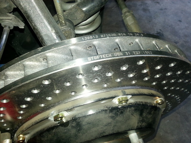

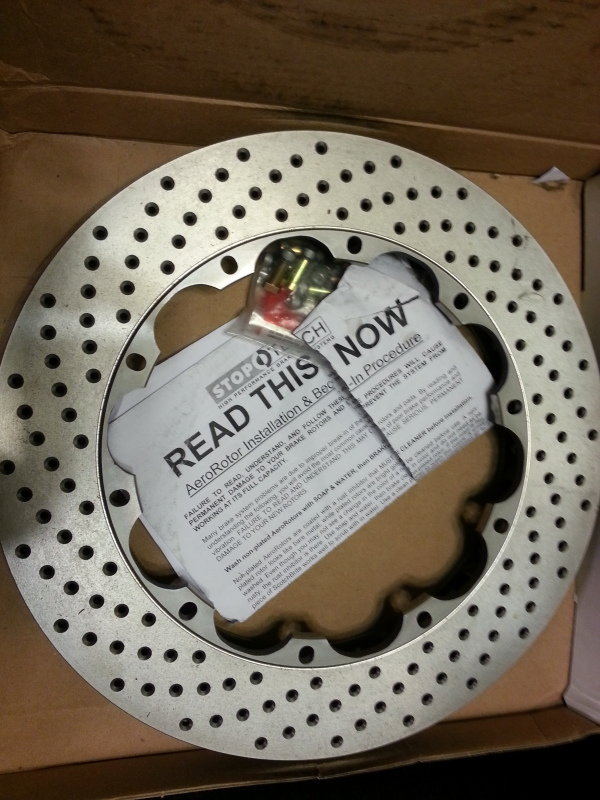

    Gifts from Grumpy. 305/35 R20 tires.
    Stop Tech rotors mated to Rotora hats.

    rotor and hat look good!! What size you end up getting?

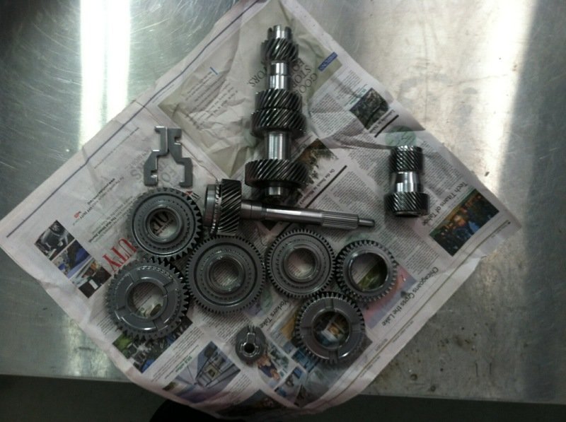

    It is a pusher....... :p. Gears came in yesterday. :woot:
    Will be picking it up Friday since I am working late the next few days.
    355x32 on a 10x9.19 rotor bolt pattern.

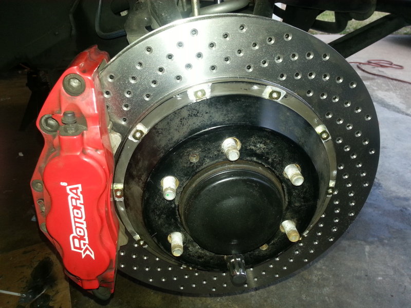

    They are! I switched to these Stop Techs because I wanted a different option from the Rotoras. The holes for the pins, which attach the rotors to the hats, were circular in the Rotora rotors. They are only supposed to be pill shaped, to allow for heat expansion, but no lateral movement. You know this Sconnie, but others may not.
    Regardless, it wasn't safe. So hopefully the Made in the USA Stop Tech rotors will last much better.

    They should! Lots of the heavy bimmers at the track we used to run at had great luck with them.

    That is much more reassuring.
    Plus these were about $40 cheaper than the ones from Rotora, as well as made here. Win win. I heard there were some QC problems with the foundry where the Rotora rotors were made(Taiwan), in the past. Either way, the rotors shouldn't have worn in that fashion. I'll have to post comparative pictures later.
