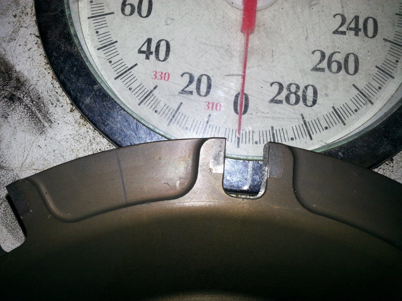

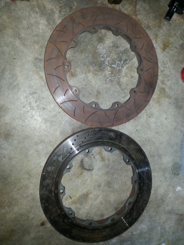

    Here is the old Rotora rotor, next to a rear rotor off of a Ferrari race car.
    Also note the rotor mount holes between the two. The Ferrari's are still "pill" shaped whike the Rotora's are circular.

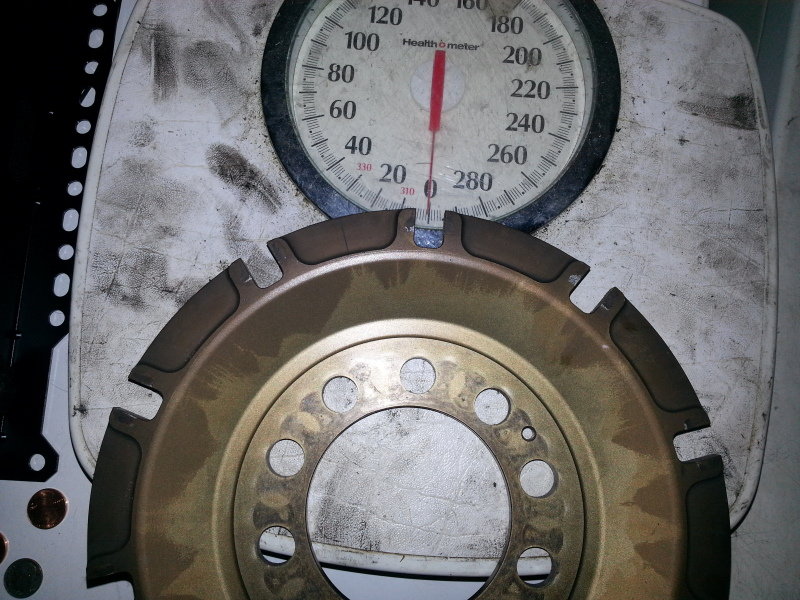

    Here is the weight of the Ferrari rotor's hat. Made of Titanium.

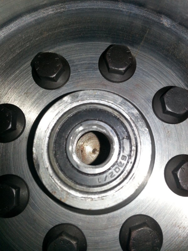

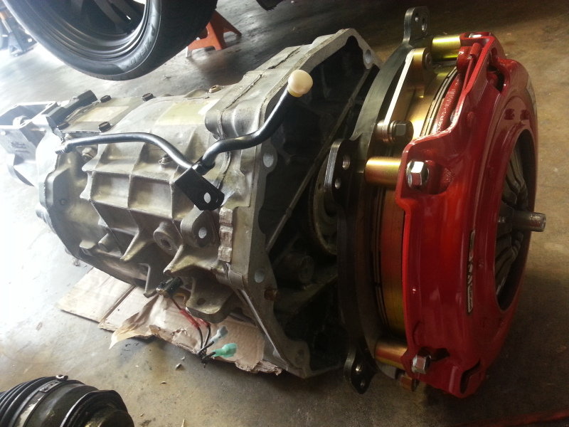

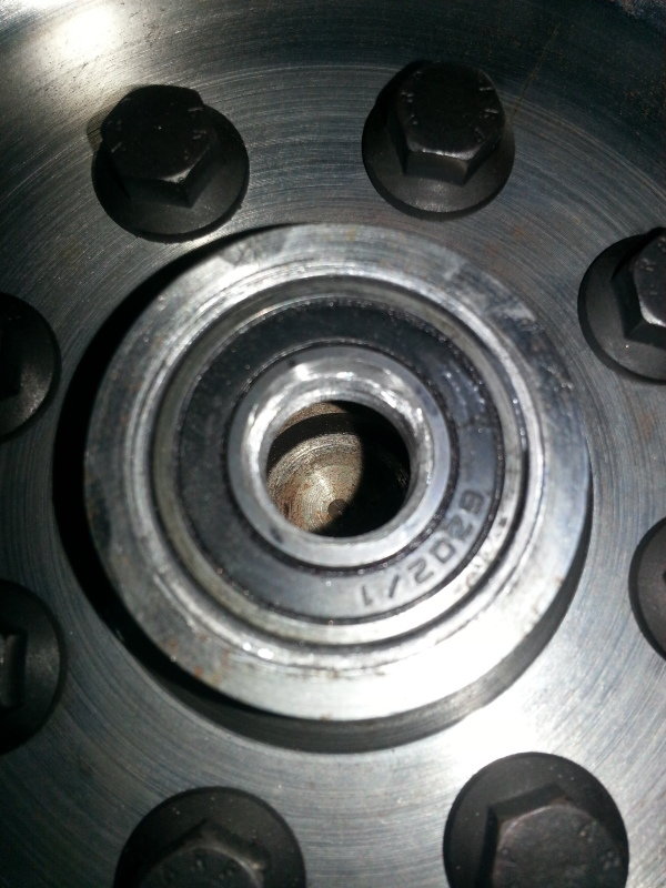

    Did a lot of double checking of measurement. Stabbed the transmission by hand, then encountered an odd "sticking" issue. It just wouldn't quite stab in all the way. Ends up that the disks are just a hair off center from the pilot bearing. So tonight I will have that sucker back in there.

    Transmission in and clutch bled. Went in super easy this time, after that Dremel work on the pilot bearing.
    Didn't start until 7:30pm, but it is done at least. Will be driving it tomorrow. Break in brake rotors, and fluid changes. Then ready for MSR. :woot:

    These pictures help to visualize what was done to the pilot bearing. Although still hard to accurately see, you can get the idea. I tapered the I.D. inlet with a much more gradual taper and larger starting diameter than before. Which was practically a straight edge. Then due to the extremely tight tolerance between the I.D of the Micro Blue Ceramic bearing, and the O.D. of the input shaft, I ground aways at that, as evenly as possibly. To give it a little looser tolerance. Took about .010" off the I.D. really helped.
