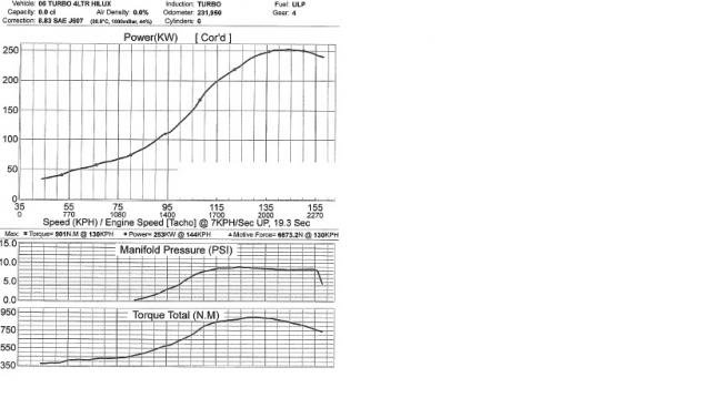

    I am using a Vipec, it can control fly by wire, vvti etc. Its a great computer I installed it myself. I think they are made in New Zealand.
    Here is the graph. Don't pay attention to the RPM the dyno operator must not have scaled the print out correctly.
    I would still be interested in seeing your timing table if you could do a screen shot of it off your computer.

    Unfortunately, I can no longer plug into my ProEFI, as I don't have the cord anymore. So since that is the case, I can't look at the tables anymore. When the time come to get tuned again, I will snag some pictures.
    When I started the look for an EMS that could control TBW, I came across the Vipec as well. It was just that they weren't as local, nor had enough tuners to make me feel comfortable buying it. Incase I couldn't do something myself.
    Then there was also Motec. But those were just to much out of my price range.
    Help me understand your graph, if you don't mind. I see the words "Max Torque = 501 N.M." and "Max Power = 253KW" But the tq curve doesn't match a those #'s. Then there is also another word "Motive Force" how does that apply?

    Sorry Tor its a shit scan of the original. That max torque figure is 901N.m its a lot clearer on the original. He had really good detailed graphs on his dyno computer then they give you a shitty one page print out when you leave.

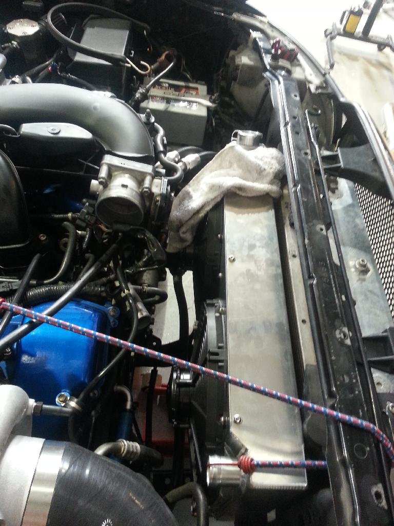

    Ron Davis radiator nears completion of install. My friends at www.KozmicMotorsports.com are doing the fab work/ installation and wiring. They were highly impressed with the quality of the radiator.

    That is a HUGE torque number! Which turbo and specs are you running? How does it feel to drive now, with all of the power and tuned?
