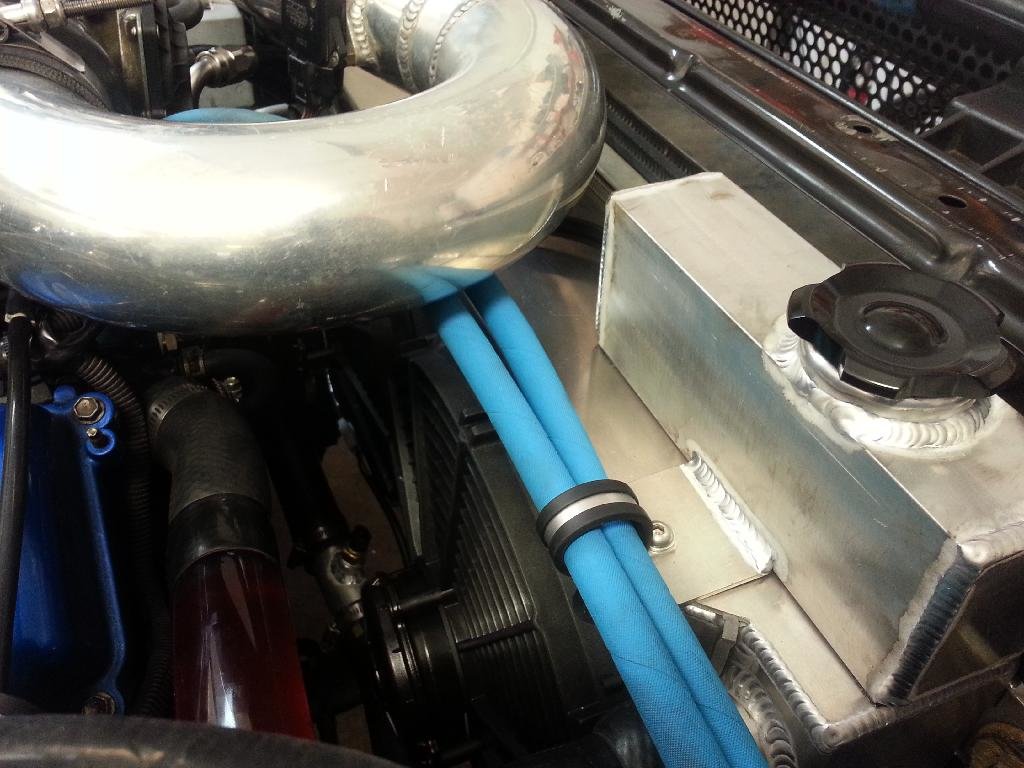

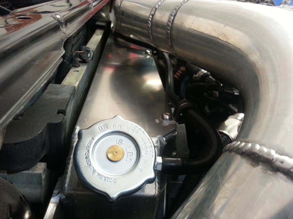

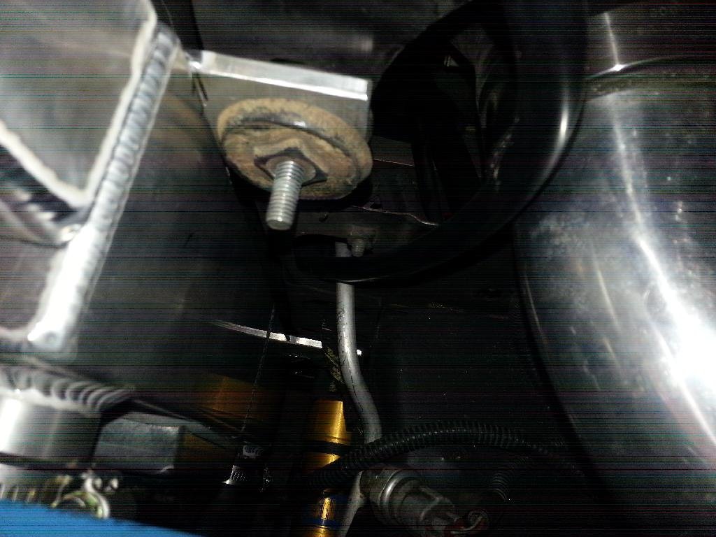

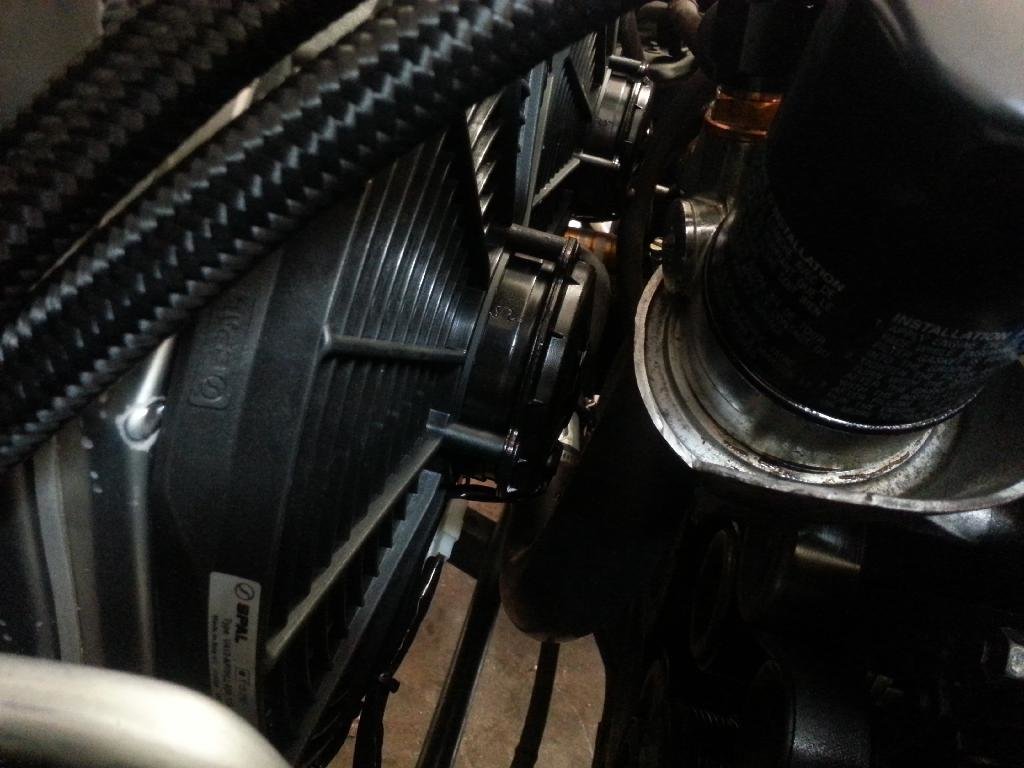

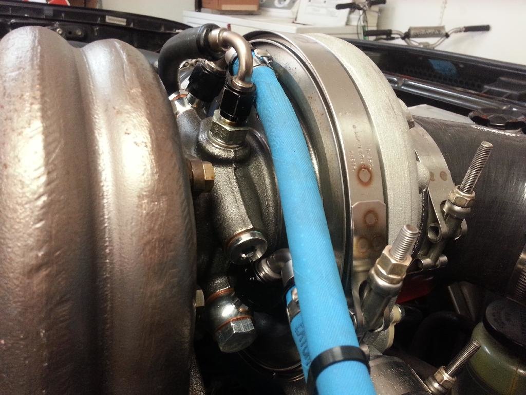

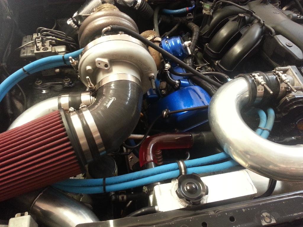

    Latest update. The SPAL fans are beasts. Seriously. They will suck a small child through the radiator.
    Got the back yesterday. Here is the finished product.
    Uses factory isolation pads and mounting holes.
    Overflow reservoir made by Kozmic.
    Coolant lines all attached. Being fed by the ports which used to feed the throttle body.
