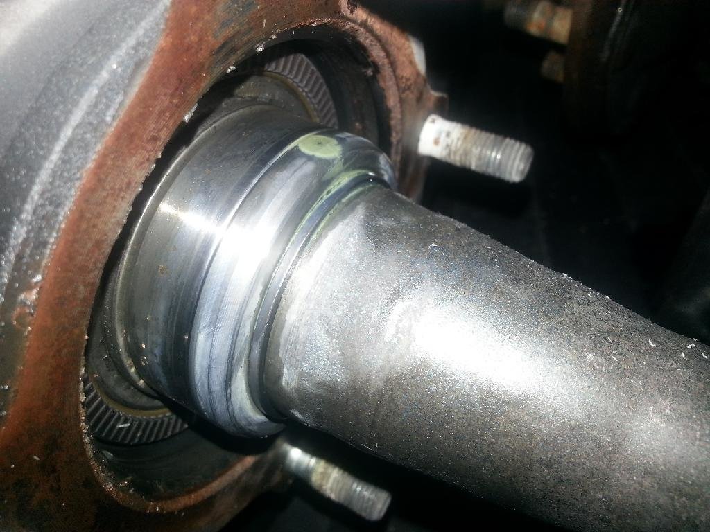

    how are you upgrading your axels? you know there are off the shelf solutions for that right? marlin trail gear and nitro gear all sell cromo rear shafts

    MMVI 4.4L 4x4 Access Cab
    Torspd Custom Turbo kit [] Borg Warner 9180EFR Turbo [] Haltech Elite 2500 [] TiAL Q BOV [] TiAL V44 Wastegate @ 15psi [] CP Pistons [] CP Carrillo Rods [] ARP Head studs [] ARP Main Studs [] ARP Header - Head Studs [] Ported Heads w/ 1mm oversized valves intake/exhaust [] Brian Crower Forged Stroker Crank [] Darton M.I.D. Sleeved Block [] Kelford Camshafts [] Torspd 160* T-stat mod [] APR Large Fuel Rail [] Walbro 460 LPH E85 Fuel Pump [] FueLab FPR [] APR T56 Conversion Kit [] KP RACING Built T56 [] McLeod Racing Custom Twin Disk Clutch [] One Piece Aluminum Driveshaft [] MGW Shifter [] Custom lowering kit [] Ohlins Front Coilovers [] QA1rear shocks [] Custom Ron Davis Radiator [] Dual SPAL Electric Fans []
    Here you can see the worn in groove. It is being touched by the green dot, on the left side.

    Id check the specs of an fj rear axel see if itll work

    Even if they do fit, what is the benefit that you are thinking of?

    the non elocker axles are all the same. 8.4", 12 bolt ring, shafts. The hino I swapped into my 05 5lug was out of an 07 6lug. Which I am 95% sure is the same axle in the FJ's

    As of right now, I am planning to send an axle out to Moser to have them make a pair. Said about $375 for them.
    Makes me curious is the FJ axles fit now.
    And 3rd members are swappable on a variety as well. It is quite likely that if someone makes them for the FJ, that they would bolt up. I should call Toyota.
