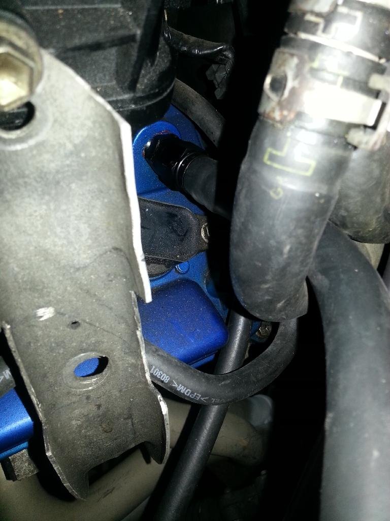

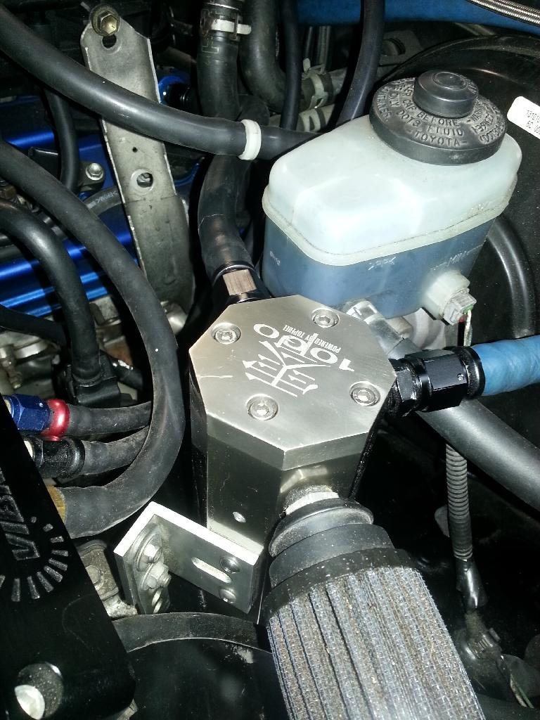

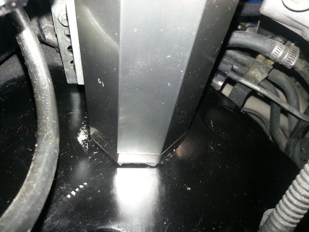

    Just added this to the Oil Catch Can Installation thread.
    Made some changes to my current can, as I still haven't installed the Draft42 can.
    Tapped the threads on the valve cover to fit 3/8" NPT. So that I could add a push lock -8AN fitting to it.
    Both sides are now -8AN inlets, with a breather outlet.
    To top it off, some foam padding for an isolation pad.

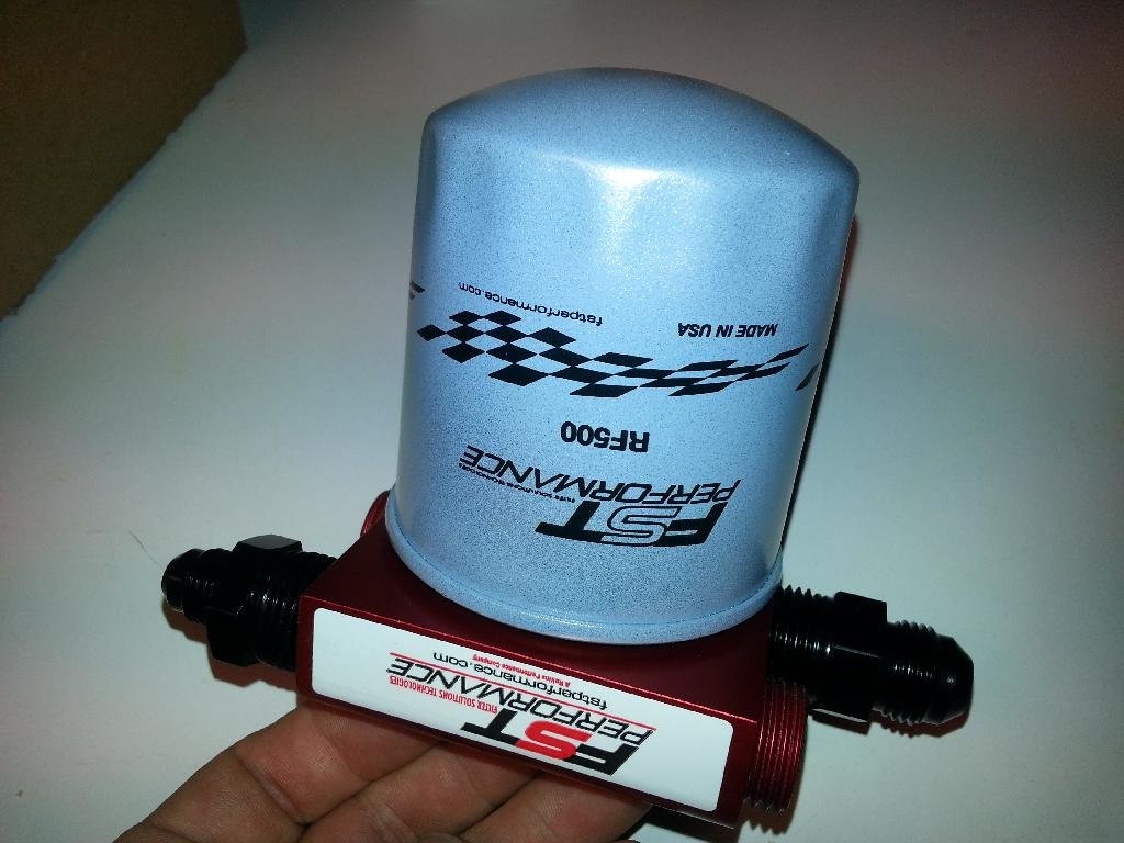

    Need to get some PTFE fittings and hose, then my new fuel filter will be ready for install. This is a truly capable fuel filter. 4-5 micron filtration, and every fuel compatible.

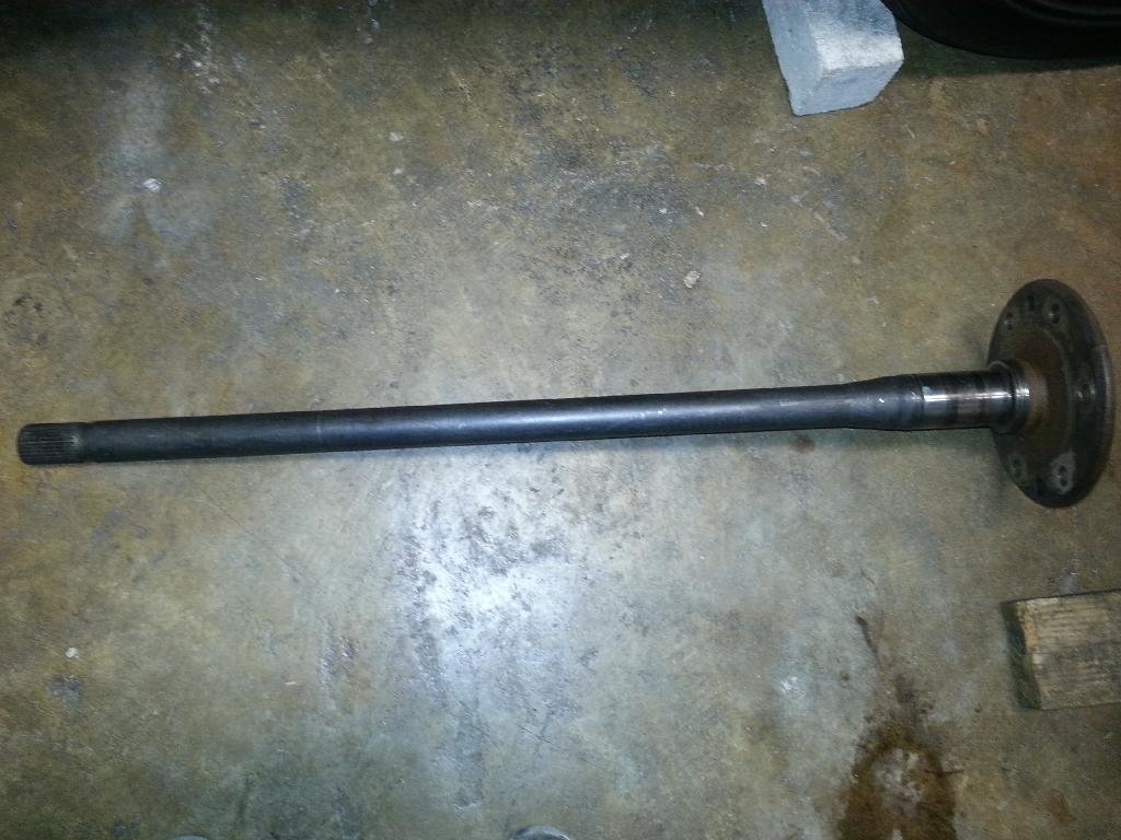

    Lastly, my OEM axle shaft. Bare naked and waiting to be shipped out.
  20. Jan 27, 2014 at 7:07 AM
    #1800
    colinb17
    colinb17 If at first you don't succeed, don't try skydiving
    Jan 6, 2008
    #4127
    20,257
    Colin
    Charleston, SC
    '07 TRD Sport 4x4
    Build thread in sig... 4-link long travel
    getting the axle dimensioned out?
