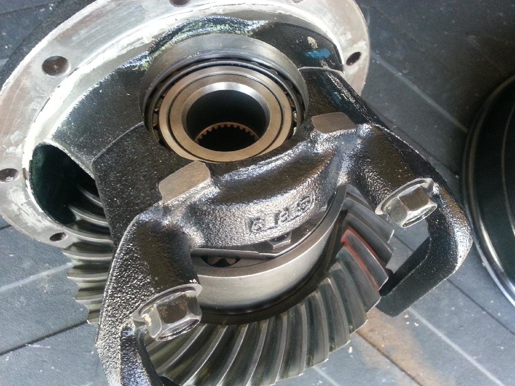

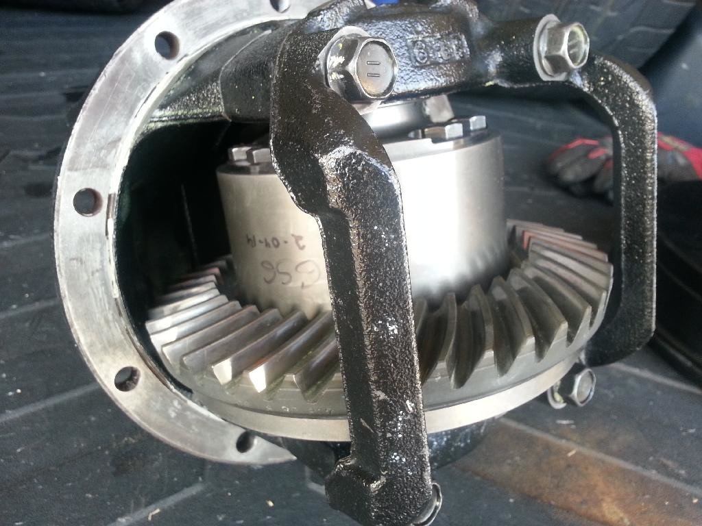

    3rd member back and ready to go in. Had KP Racing, here in Houston, do the install. $180 installed.
    Also might have a new lead on a company that will make the custom axle shafts. Need to give them a call. Here is a cool fact that was learned through this process though.
    When I was up at KP Racing, picking up my 3rd member, I saw a twisted axle shaft. The splines had been twisted off at the drag strip, during an obviously hard launch. We busted out the calipers, took measurements, then I compared them to the measurements of the Tacoma axle.
    That car was making about 950 whp and similar torque. That car was a Shelby GT500, and the axles were stock. Our 2nd Gen Tacoma axles have a slightly larger bearing OD and slightly thinner shaft OD. And I am talking thousandths.
    That means that as long as I don't drag race, mine will hold some pretty serious power. I still want stronger ones though.
