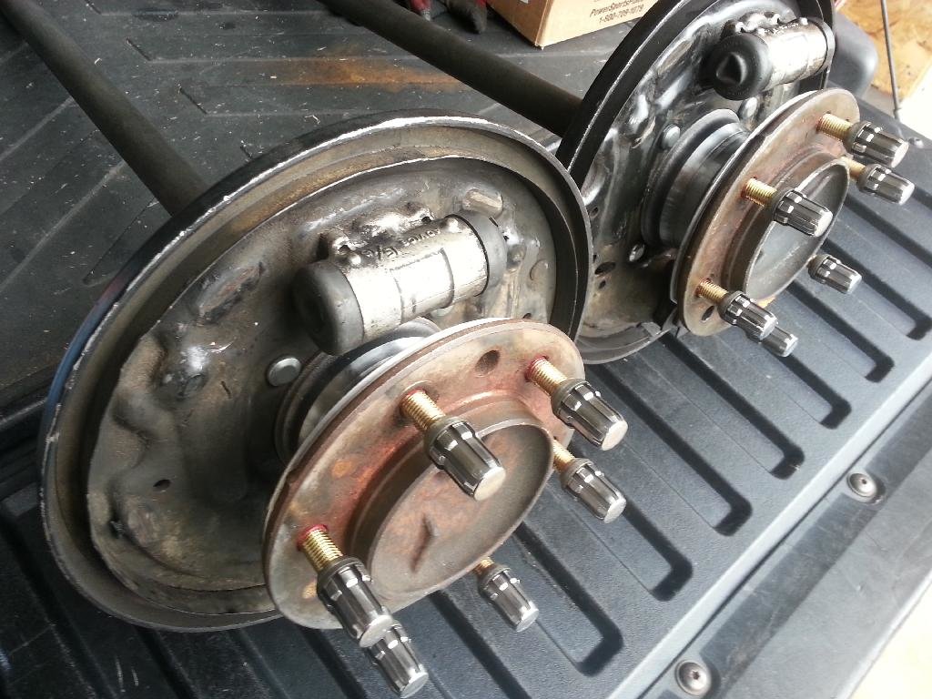

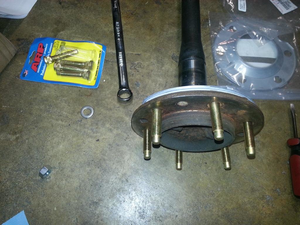

    As of last week, these the axles were re-installed. Used Timken bearings instead of OEM because it cost only $250 for the pair, instead of $600+ from Toyota. Unnecessarily expensive.
    Those are using the ARP Toyota Celica wheel studs.
    Long wheel nuts are required as well. Those in the picture do not work.

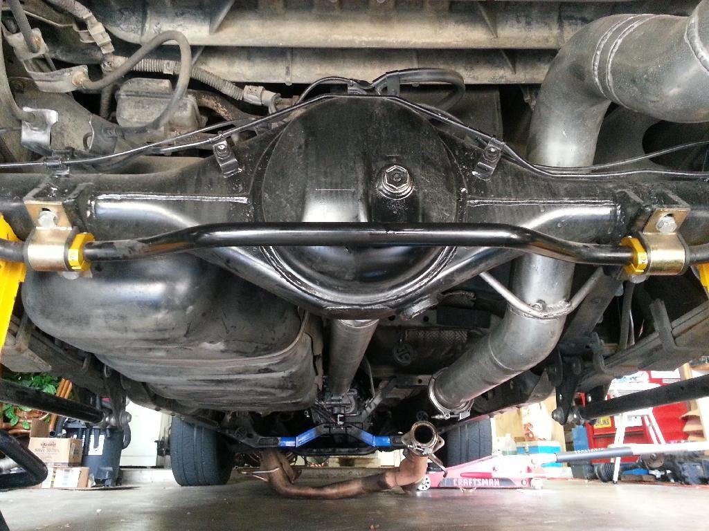

    Rear sway bar never came with stops, to prevent it from shifting. Whiteline makes bolt-on stops to alleviate that problem.

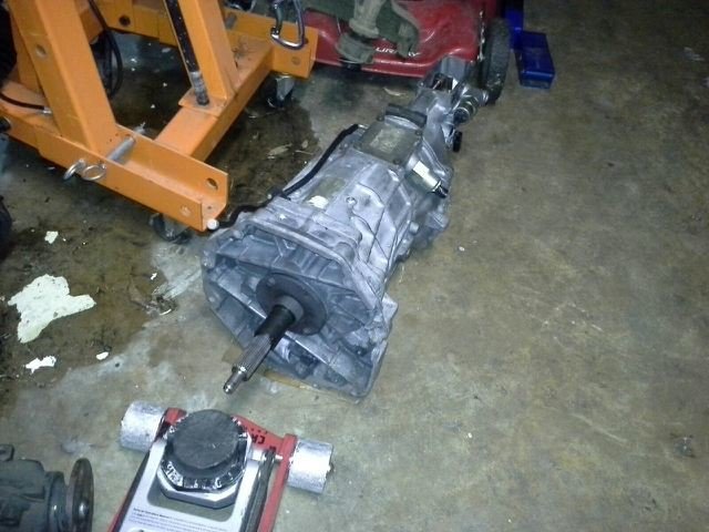

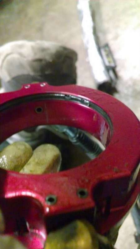

    Here is the transmission again. Throw out bearing was squealing like a pig, and the piston would stick partially depressed. So what I thought was a great TOB, is actually more well know as giving a lot of headaches.
    Rob and I found this damaged seal last time we had the transmission out. Well that knick seems to be allowing clutch dust in between the raised portions. In turn causing the TOB to stick and not fully return.
    New seals will be here today, and we can get this thing back together.
    Trust me though, I have already found a better TOB.
