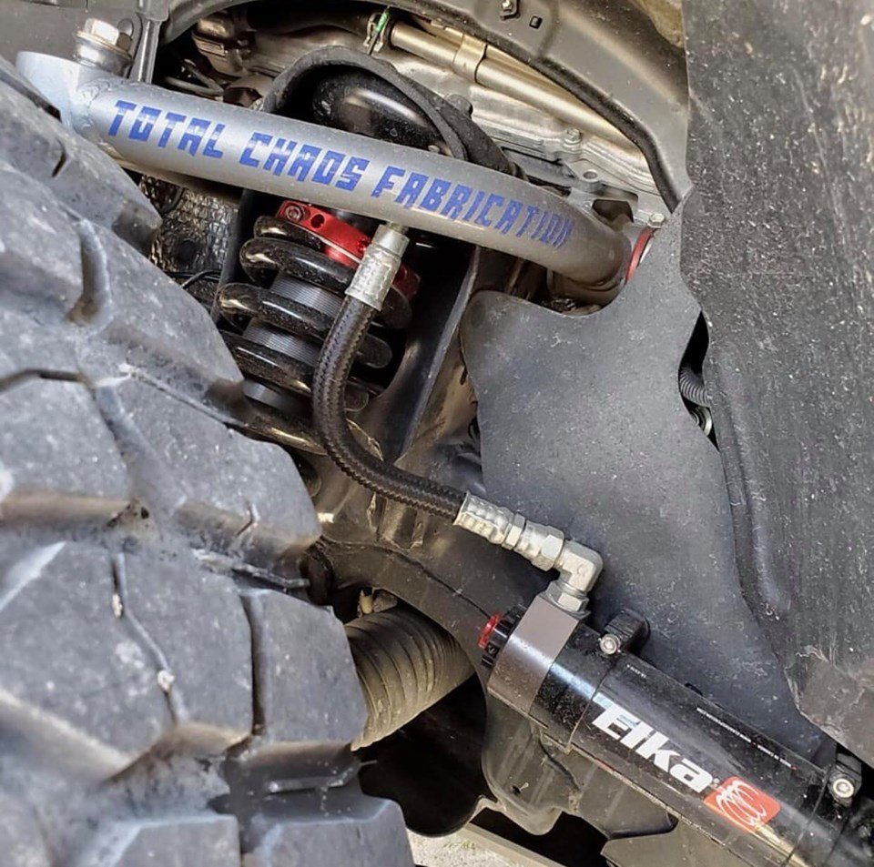

    Elka Suspension 2.5s sitting pretty with our UCA's...
    What coil-overs are you running with your TOTAL CHAOS Upper Control Arms?
