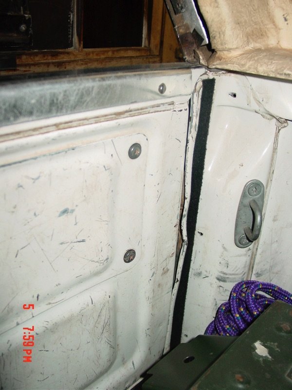

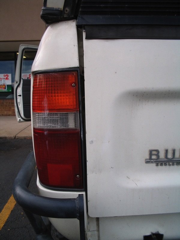

    I think this is really the bottom line. For normal use with an open bed the design is sufficient. Even occasional weight isn't gonna hurt anything. With the tailgate closed the bed sides should be fine, the tailgate provides support. It's if you're putting weight or force on the sides all the time or twisting the chassis that you run into problems.

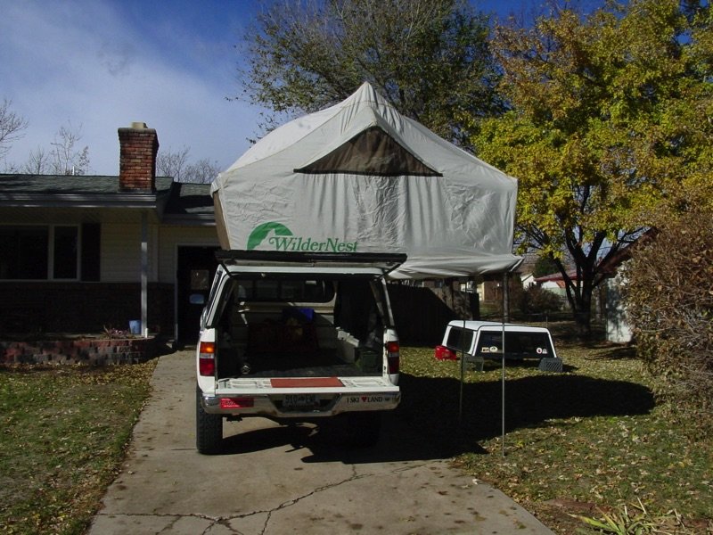

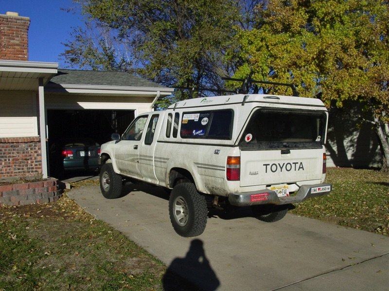

    What fatigued my the sides on my '91 was the WilderNest. And I totally acknowledge this is an unique case. I am preparing the Tacoma to mount this and wanted to fix a problem I knew was going to be there. Even if the Tacoma bed was just as strong as the older trucks I'd have done this and since it's not even that strong this was definitely gonna happen eventually to it.
    Closed it looks like this.
    Open it looks like this.

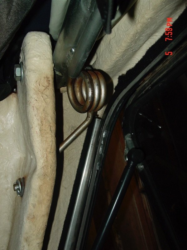

    But since the lid that flips over is heavy and awkward, they put in helper springs. They prevent the lid from slamming shut when you close it. They are loaded with the top shut and that's a constant pressure pushing the sides of the bed out. There's a bracket that goes over the door to tie the two sides together, but it's still a big unsupported space. When I 'wheel with it I connect the bed sides together with a ratchet strap to give it support but there's only some much you can do over time.

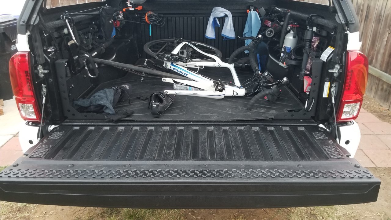

    I've had my Total Chaos Bed Stiffeners on for almost a year now and love em. I spearfish a lot and like to go out on kayaks. Sometimes I go offroad with the kayaks on my racks so I got these stiffeners for the peace of mind that my bed flexes less and will mitigate any encounter with the bed tearing. I read a few folks who had their beds split/tear due to the loads on the rails and thought it would be a good idea.
    These things are much beefier than they look in pictures. They've also added more tie points for me which has become super functional every weekend hauling things. I get a lot of comments on them.

    The metal in my bed didn't flex, the welds along the seams were cracking and lip had started to buckle. Like I admitted in a later post, the WilderNest is pretty hard on bed sides and an exceptional case. I eventually beat that flat and bolted angle iron along it, but the damage was already done by then and the side has splayed out.
    Your point is valid, normal use shouldn't seriously stress the bed of a Tacoma or any truck. But I don't think it's completely fair to say it's pointless to reinforce an obvious weakness to any pickup bed if your use dictates it is fair either.
    The stress and shock of 'wheeling also cracks the fiberglass in topper shells, so repairing the gelcoat periodically is necessary. Doesn't mean all toppers are flawed, but does mean I have started using 1/8" rubber under them to try and reduce the cracking from it.

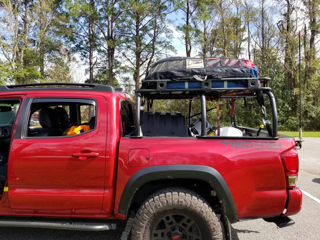

    I'm in the same boat. Stiffeners we're one of my last mods and carrying an overlander xl smittybilt with camper shell. There were so many other things I've done to the truck and frankly these were on the bottom of my list and really just because I wanted to spend money during a labor day sale. For most people I doubt these necessary. But it was always a thought for me driving over trails hard without these that maybe it was a good idea to have extra support given my extra weight.

    Dude, that is awesome! That looks really awesome. I like that it sits flush with the roof rack, that's exactly how I want the bed rack to sit on mine when I do mine.

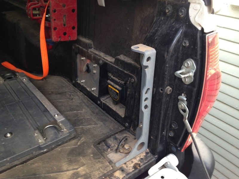

    They help but if your bed is showing signs of bowing, it’s just a matter of time.
    This was before the stiffeners
    And after I put them on
    Then a year later of wheeling
    Can see here in this picture that the bedside is still pulling away even though the stiffener is in place
    Not saying this will happen to everyone but don’t think that a bed stiffener will prevent your bed from bowing. My total chaos stiffeners stayed square, it was just the crappy bed. Rtt with a cap and bouncing offroad doesn’t mix well with our beds.

    Pretty much what I was trying to get at
    Many will buy these thinking it will beef it up where nothing will happen.
    I know I did. It still split
    And like yours mine haven't moved but you can see where the top screw is that the bed is pulling away from that part.
    I think it would definitely help with the bed caving in but not splitting out.
    And like you said when it comes to flexing and banging around off road it's just not going to stop it 100%
