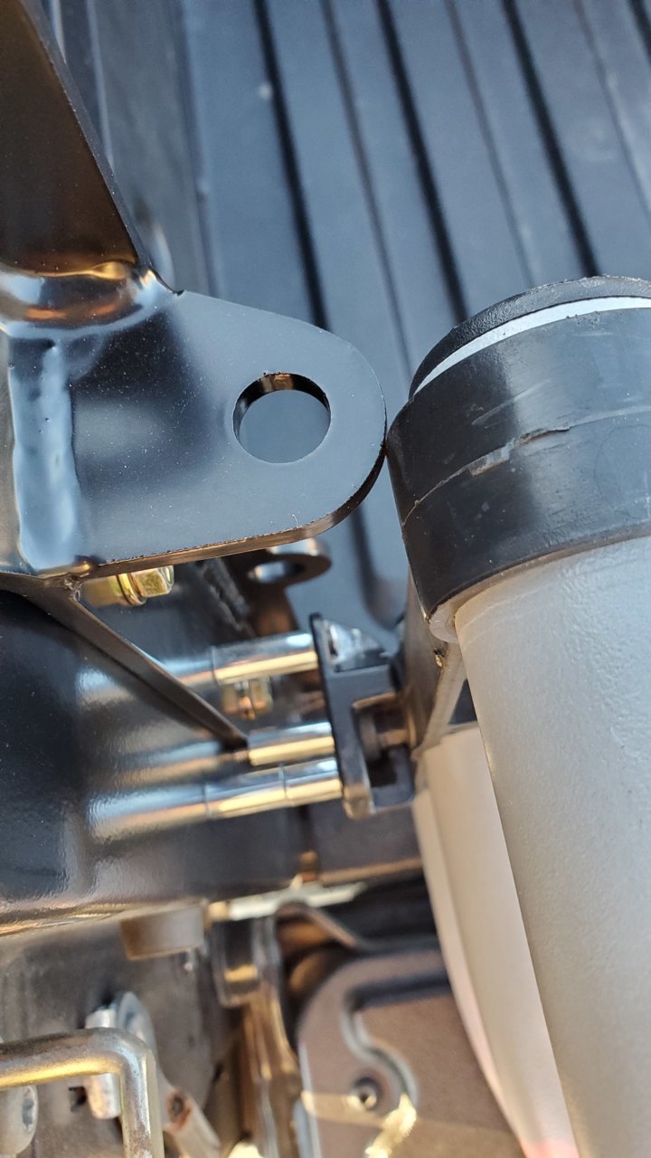

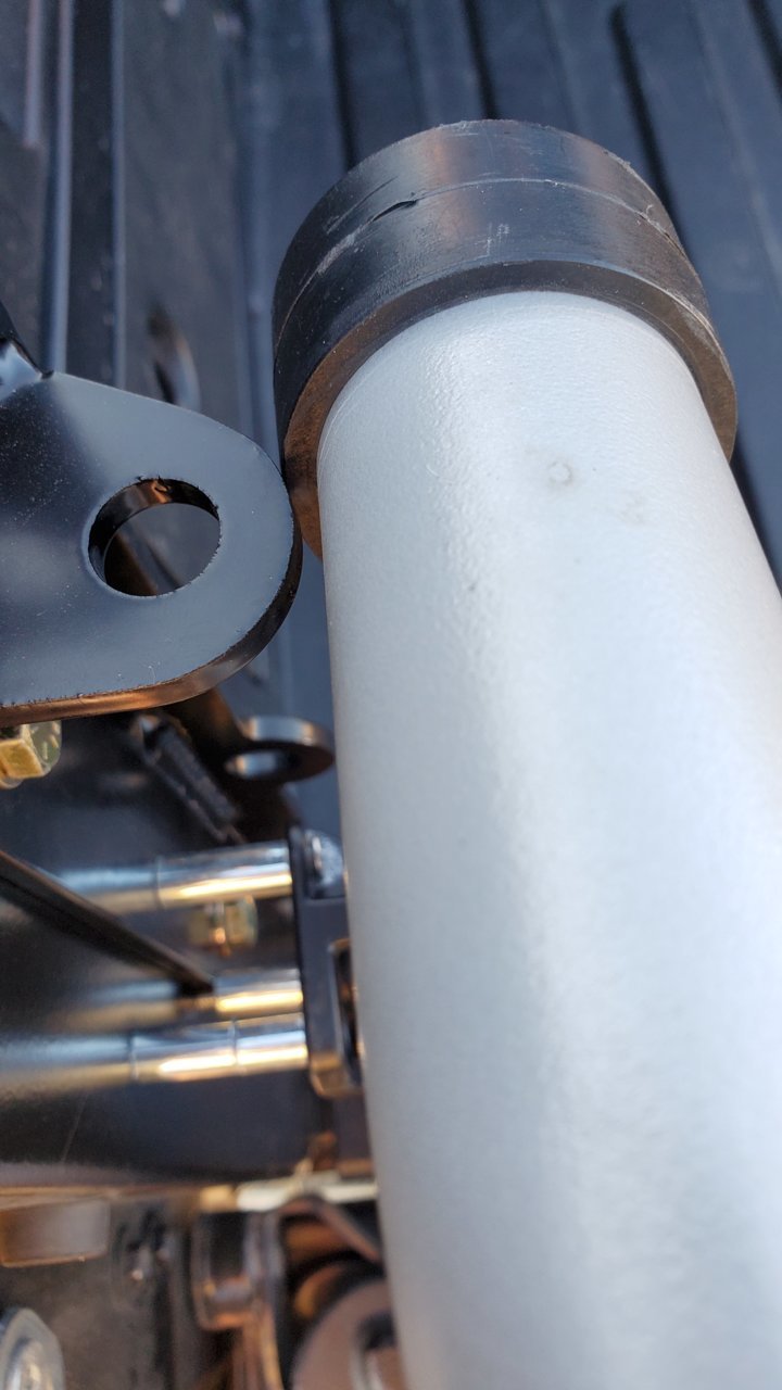

    I just finally completed this on my 3rd gen with the factory bed extender. I did not have to cut anything and she fit! But barely.
    That being said, there are a couple of things to note:
    The screws holding the joint clamps together are facing inward and get pretty close when the extender is narrowed up. The screws are a T20 torx head and I could not get the rachet in after narrowing up the extender. Hand tight won't do in this case because the screws are hard to turn without proper leverage and need to be fully in for the clamps to work. Unfortunately you also cannot just reverse the clamps to get the screws facing outward. The way I got these together was with a T20 drill bit and a 1/4" wrench to turn the bit.
    It fits, barely and with some rub on the top of the bed stiffeners. However it's not a lot and honestly provides a little extra security to keep that from bouncing over bumps. 20200716_202302.jpg 20200716_202245.jpg
    I could trim down the plastic, but I figure it'll wear over time and not enough to cause any issues to the extender. I'll just have to keep an eye on the paint as a just in case, but I don't anticipate many issues, if any.
    Also, keep in mind that the straps that attach to the tailgate latches will be a bit tighter when attached. But they still reached no problem.
    Thank you for the idea and how to, OP!

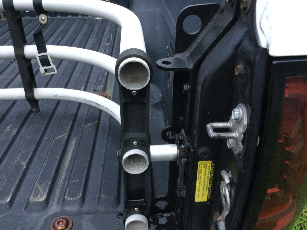

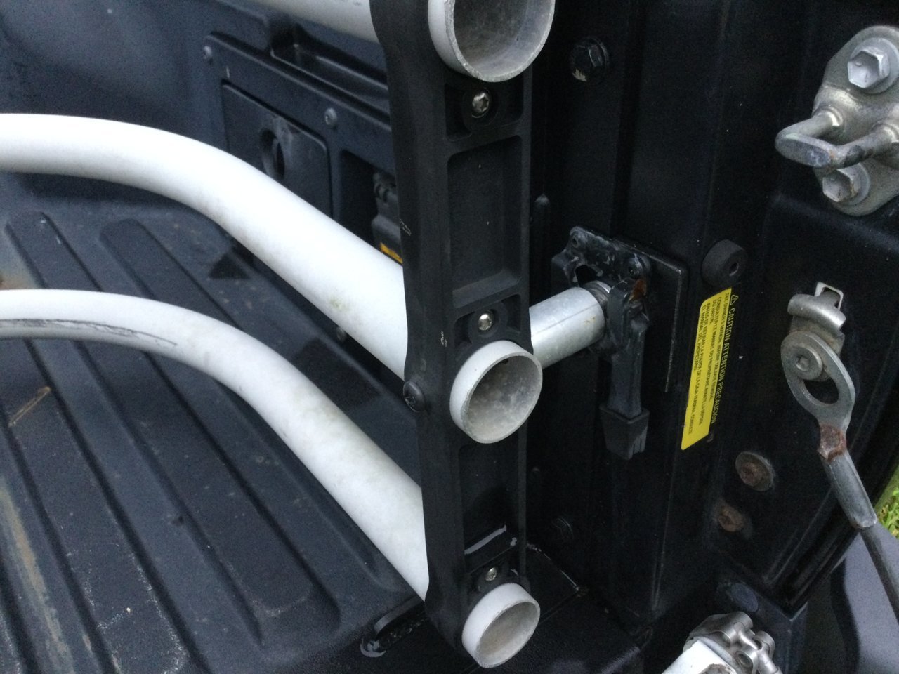

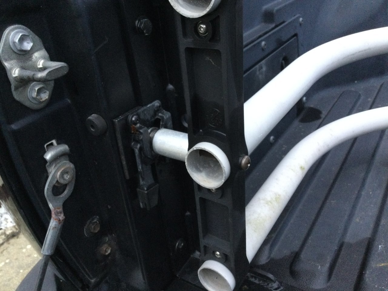

    A few years ago I installed the Total Chaos stiffeners and had to decide how to retain my Amp bed extender. Yes, I saw this topic back then but opted to make it work by another method.
    Rather than extend on standoff spacers the Amp mounting plate, I fabricated a spacer from aluminum plate and shimmed the Amp mounting plate to set flat against the bed stiffeners. Next I loosened the extenders center plastic clamps and narrowed the extender by sliding the extender ends and center tubes to a shorter position.
    Next, using aluminum round bar, I fabricated two grooved pivots that replaced the original Amp posts that insert into the Amp mounting plates. By doing it this way, I do not have those mounting plates on spacers protruding when the extender is removed. So far it has worked well and lasted for many years.

    160C978E-F1DE-440C-B898-EBDFD98BB6E4.jpg D649B0ED-DD96-4FD2-87CF-2B535606A083.jpg 4FA17022-7B22-4507-BDAF-3520F3E9738F.jpg
