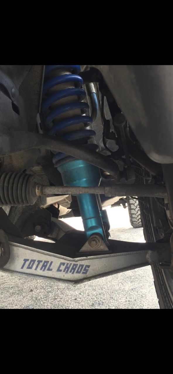

    @TOTAL CHAOS is there part# on your 2nd gen tacoma LCA ? Whats the easiest way for someone to identify what lower Arms is on their rig to see if there stock length or +2 without having stock set to compaire?

    I would have to go look. Are you running LT coilover that would be an easy sign? They do not use the same coilvers. If you are running 6" coilovers then they are stock length.

    they do have some visual differences... look on their website at the two products... if there are secondary shock mounts, that's an easy item to pin point.. the stock length secondary is more off the main arm vs the 2+ arms where the secondary is primarily on the arm.. look where the bump pad is..

    @NYCO @nudavinci64 Thanks fella im not driving this truck today but i have this photo not sure if that has any tell tell sizgs. When measuring the shock to see it they are 6 inch would i be measuring the overall length?

    @TOTAL CHAOS a little help here please. I need to know what replacement bushing to order.
