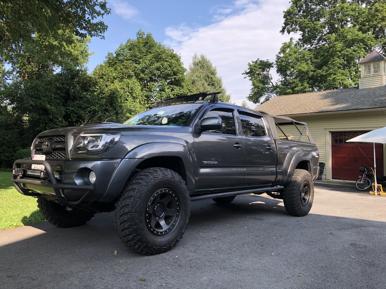

    TC Mid Travel +2, TC SUA, king shocks, Swamp Donkey/Rigid lighting, Mechman alt, SOS/Boztek armor, ATH Fab tiedown, full active JL/Audiofrog sound system, NOICO sound deadening EVERYWHERE. Up next: roof/bed rack + dry storage, skids, bumpers, fiberglass, power wire upgrade + frame grounds, LTO battery swap, air compressor, on board pressurized water, powered cooler, suspension seats, frame reinforcement, solid motor/trans mounts.
    2011 Tacoma DCLB on a +2 expedition series kit and spring under axle conversion.

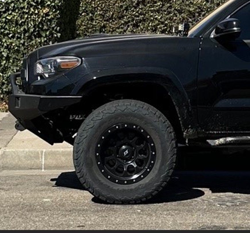

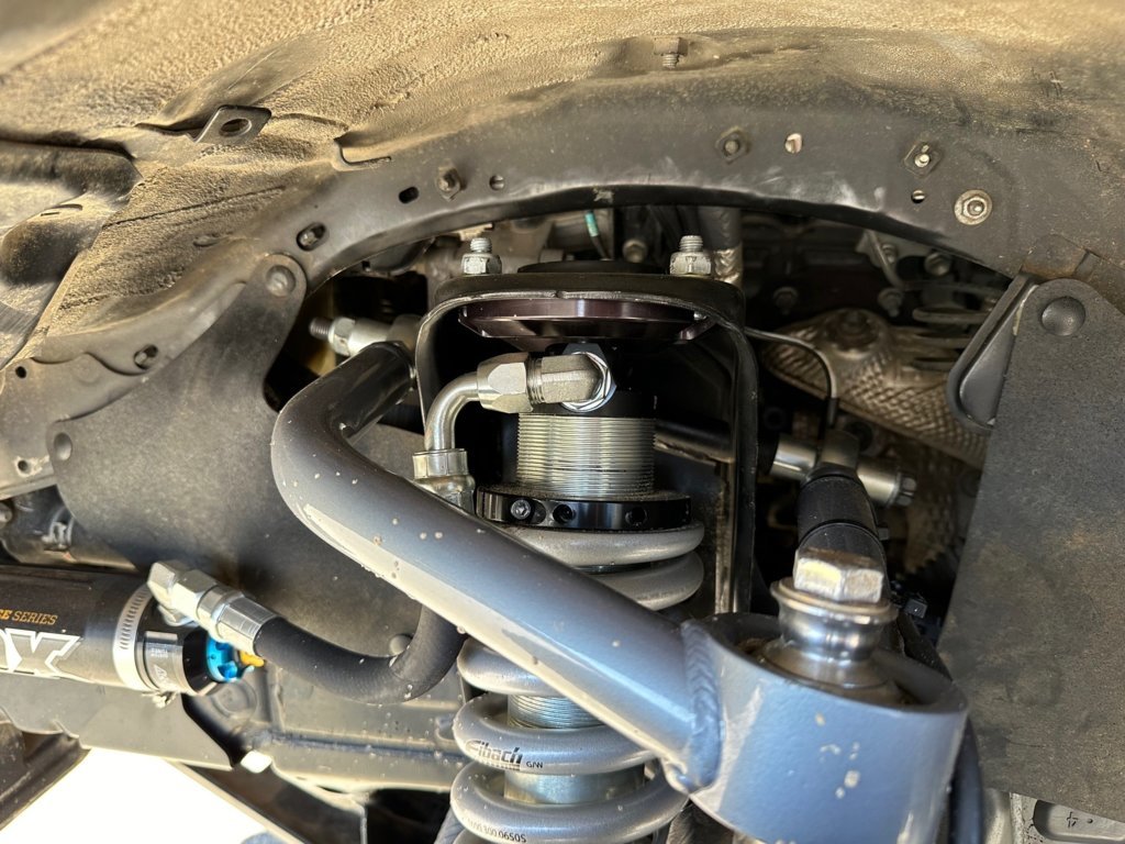

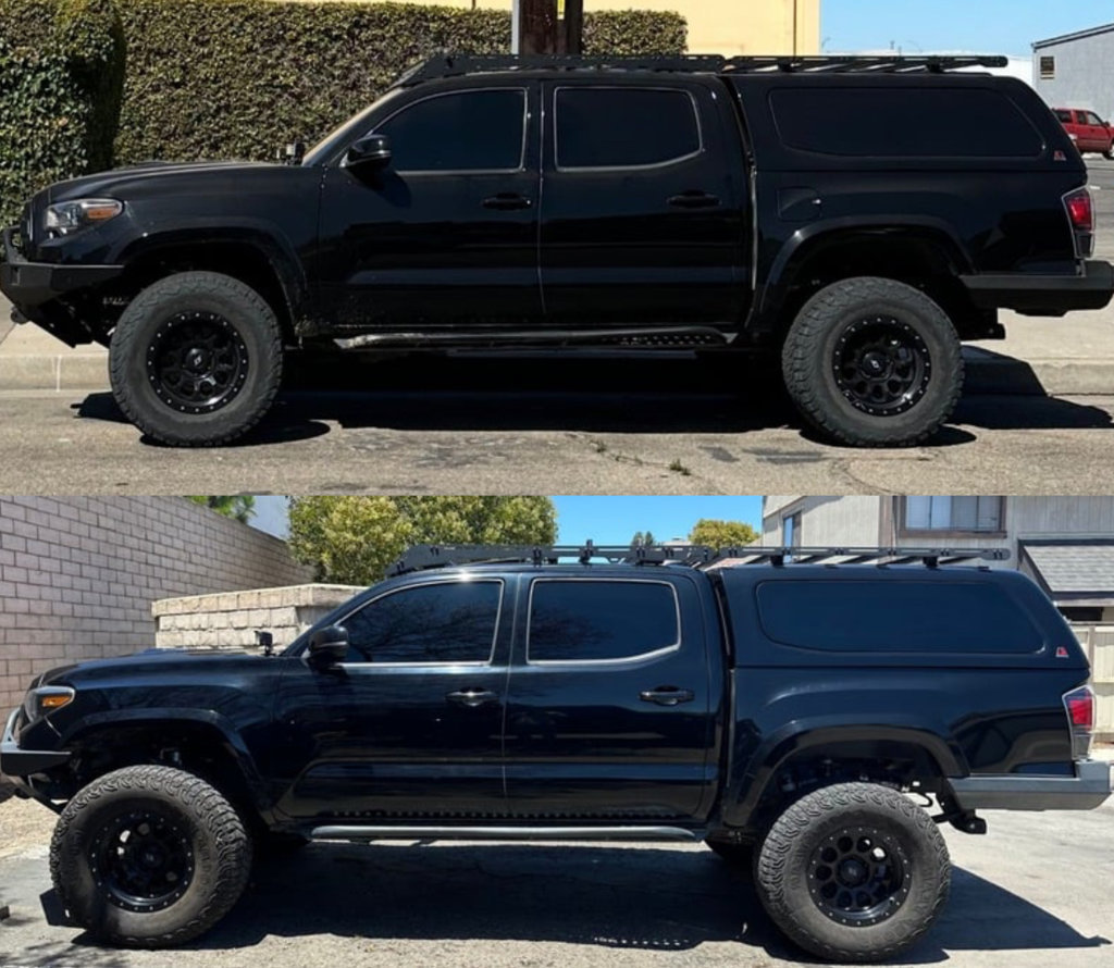

    Whats everyone's spring rates with your total chaos kits? I got the plus 2 expedition kit from accutune and resprung the coil overs to 16" x 650lbs (against accutune reccomendations) because it was sitting low in the front. 650's didn't have much of an effect and i cant imagine running 700's but maybe? Looking to see other folks similar set ups and spring rates.
    I have seen a Tacoma on IG "tacomakoma" running the same kit with the 600# springs with no preload and he looks like he has plenty of height clearing his 37's. Not something i am trying to achieve. Rather just another inch or 2 of lift.
    My bottom line concern is that a total chaos plus 2 kit will not work with heavy rigs due to not having a spring that is compatible. Heavier rates increase coil bind risk and length of shock does not support longer than 16" springs. front wheels on scale weight - 3300 . Rear wheels - 2600
    Total ~6000 depending on gas and passengers

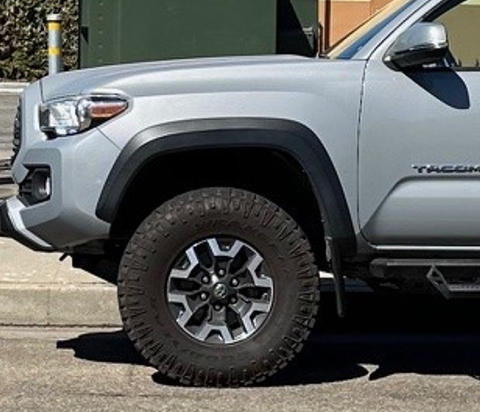

    Some comparison photos with my neighbors gray truck that is stock with a 2" spacer lift.
    Neighbors fender to hub measurement - 23"
    My fender to hub measurement - 21.5 ish
