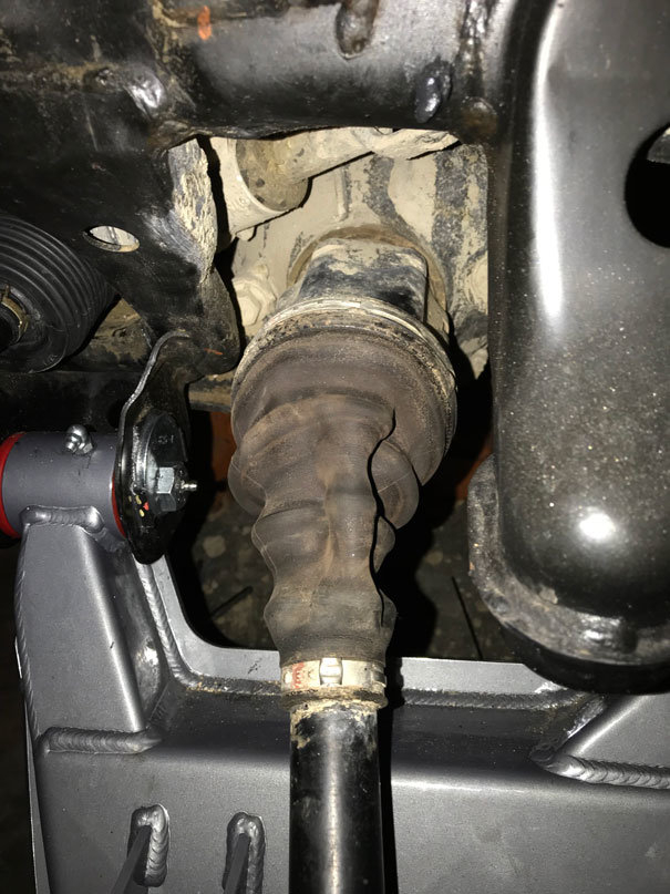

    New idea. I've replaced everything in the front fender wheels except for the CVs. I think I'll call CVJ tomorrow and swap those out too.
    I have a ton of play in my CVs and I find a gap where they go into the trans. The boots are stretched out as well. Why not start from scratch!

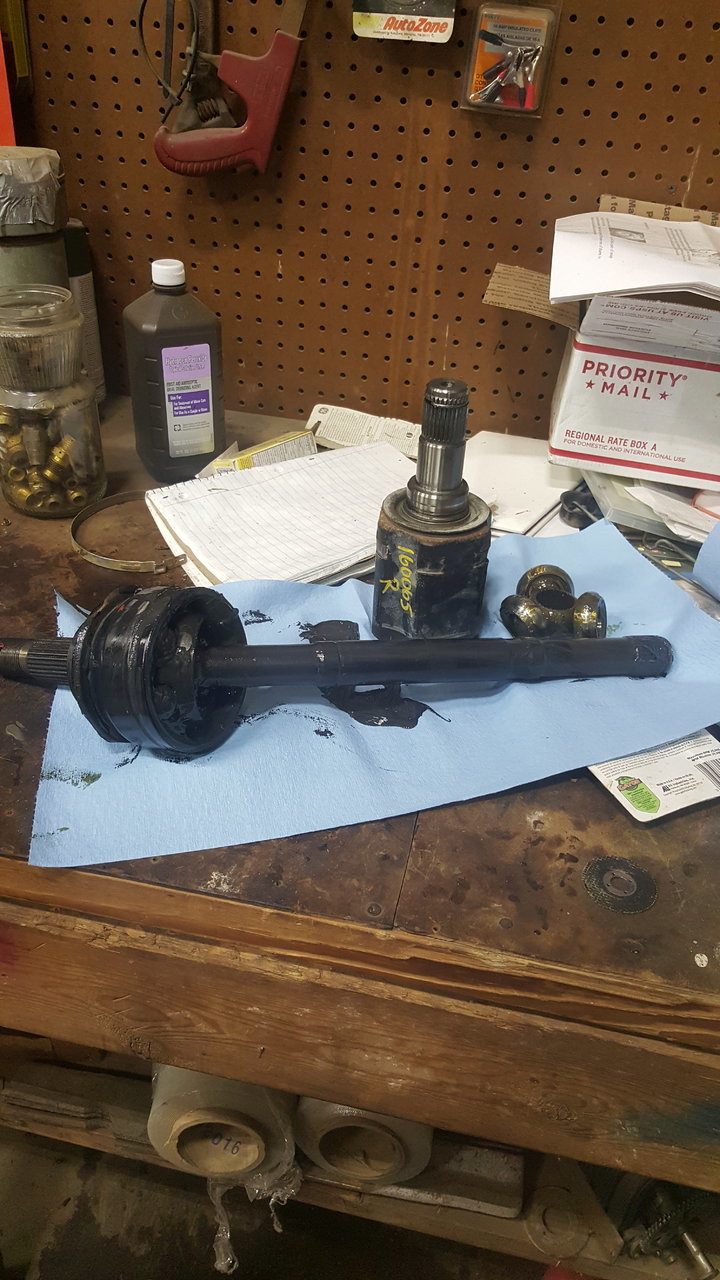

    Post a picture of your cv, you could have pulled the "tulip" out of the cv inner housing.

    Yea that's exactly what happened, it can be saved you just have to twist the cv and get the tulips to line back up with the cup. Then push it into the cup.
    20160328_173905.jpgIn the picture you can see the tulip piece that slides in the cup.

    I edited the post. Hope that helps man
