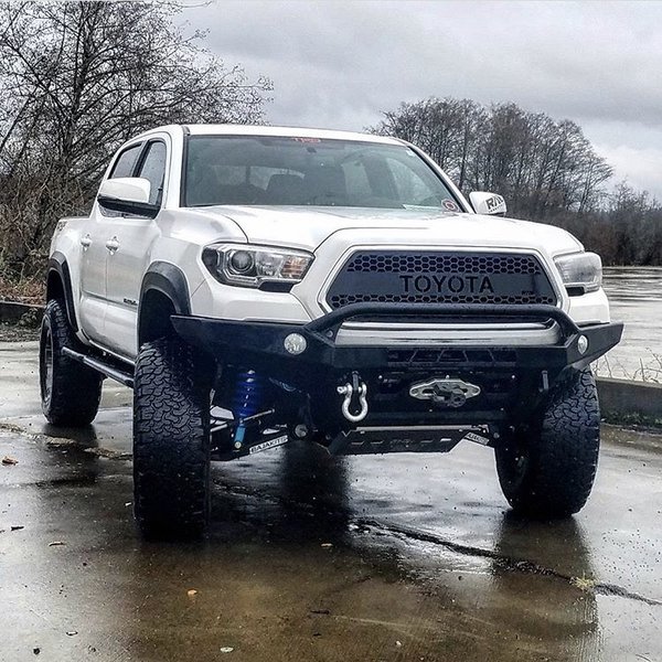

    Our set up is a +2 Kit but we have been selling quite a few of these kits already in a short amount of time it's been out!
    Here are a couple pictures of our customers trucks...

    White truck is Max's ( the_yeti_off_road ) on IG.
    He is the process of getting fenders painted.

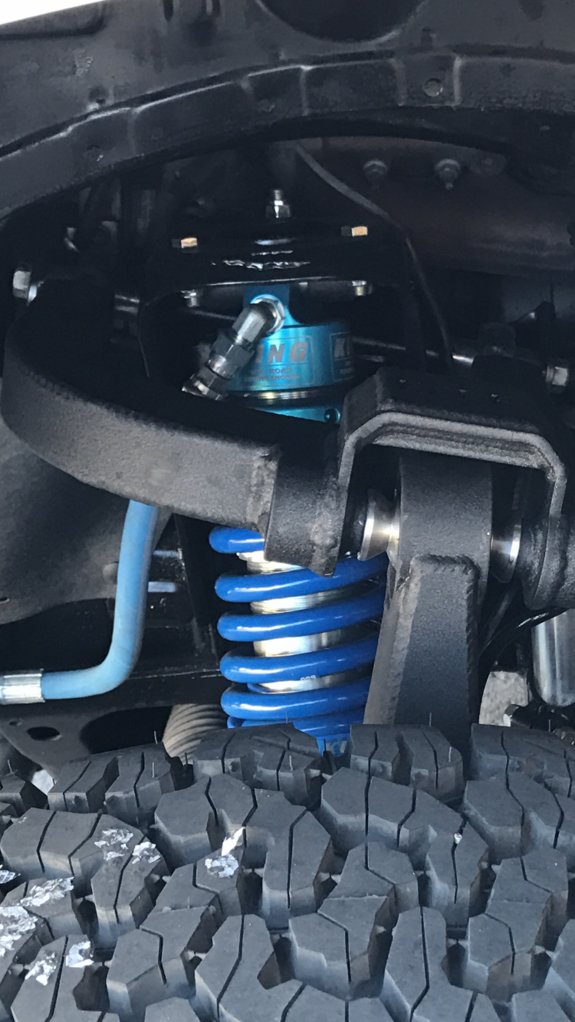

    icon ext travel co dirt king lca dirt king heimed uca fox bumps dmz sua icon piggy back fox bumps Solo Motorsports pre runner bumper ifs trans tcase skids demello wrap around rear bumper mcniel fiberglass fenders and bedsides front suspension and rear suspension set up by Solo Motorsports

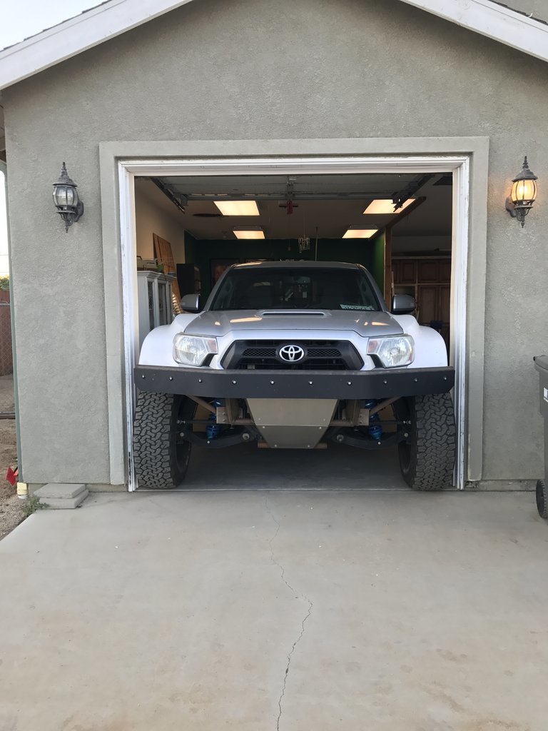

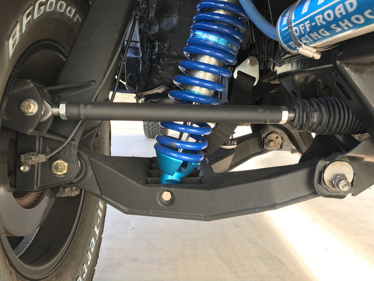

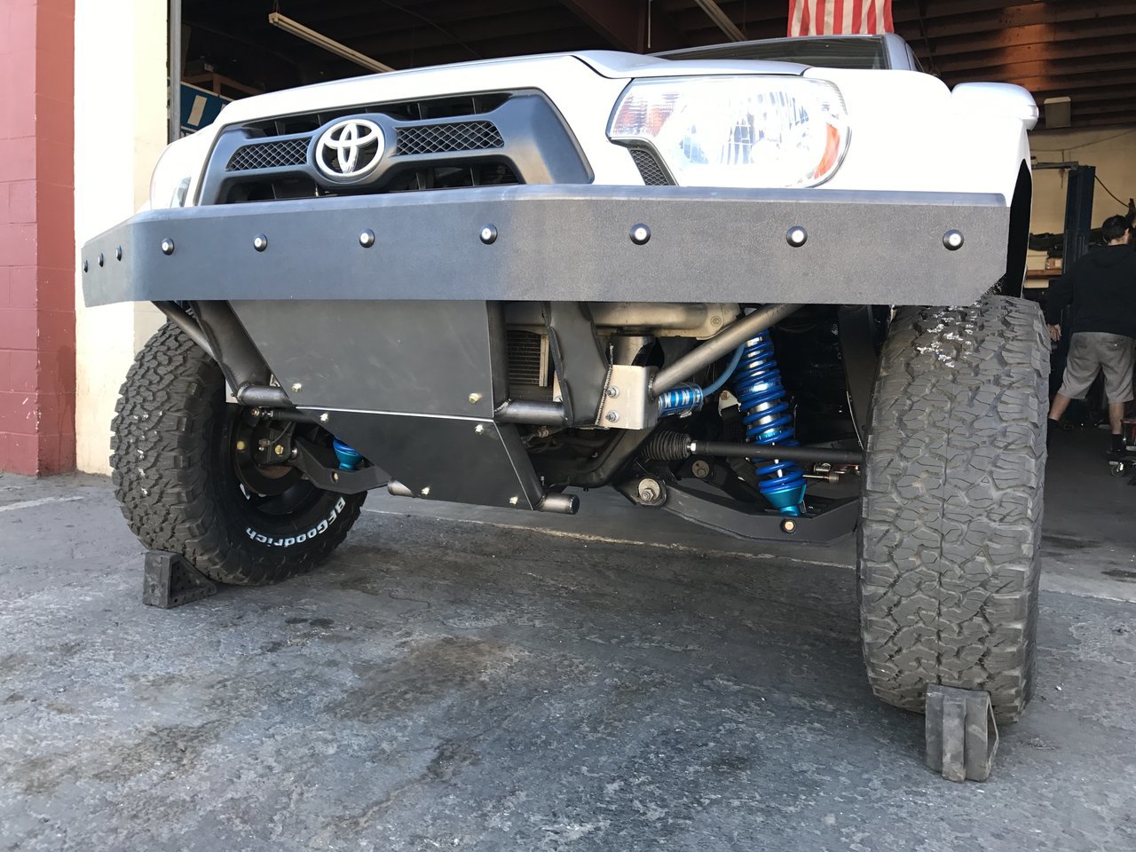

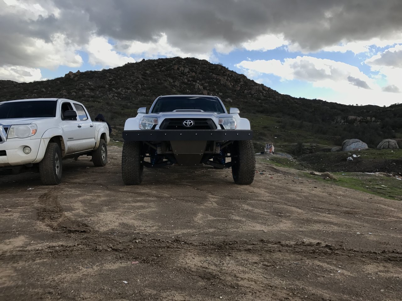

    dont forget about dezert toy fab :headbang: tony makes a awesome kit, boxed uppers and lowers, race spindle 6" over per side, 18" of wheel travel IMG_4066[1].jpg IMG_4361[2].jpg IMG_4367[1].jpg IMG_4706[1].jpg IMG_5133[1].jpg

    It would take me forever to park that thing in the garage with it being that close! Who makes the glass for the fenders?

    lol only had to park it on that side of the garge for a few days till i got the rest of the garage cleaned to fit the new bass boat in.. but it was sketchy parkin on that side.. had less then a inch per side of wiggle room (that garage door is 95" wide to lol) the fenders are from @tacomonazul.. they were fiberwerx 6" that were cut up, widened and re molded to fit the DTF kit
