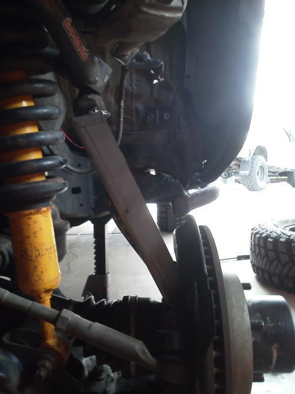

    the way the sway bar gussets line up, i believe you need more BS than the non-sway bars...
    TC sway bar
    TC non-sway
    from the links zach posted on my build you can see the comparison between mine and erics to show the same comparison you see above
    Crom[OP] likes this.

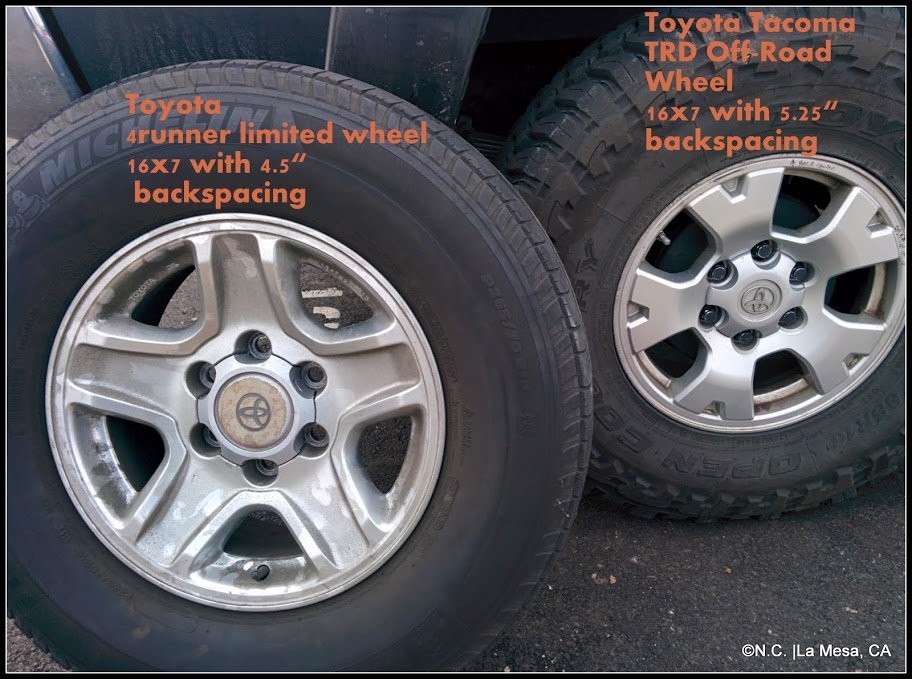

    I've been in touch with Total Chaos. They are unsure if my wheel choice (4runner limited wheel 16x7", 4.5"BS) will work with the sway bar version of gussets.
    They have offered to test fit one of my wheels, by bolting one up to a knuckle that they have in their office. But they are 100 miles away...
