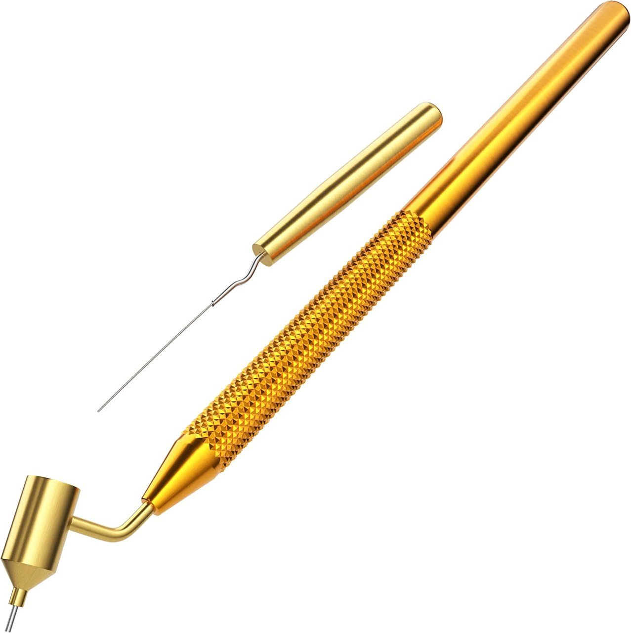

    I use one of these for touch up and its amazing.

    use the Toyota one if you just want to paint it over to prevent rust
    but do invest in one of those tools others have posted above, you can buy the color matching Toyota touch up pen and twist it open and access the liquid paint instead of using the ball point pen.

    What is this tool called exactly?

    fluid writer. $10 on Amazon. I find it only works on horizontal surfaces like the hood. I could never get it to flow properly on vertical surfaces since it uses gravity and the weight of the paint in the little cylinder to get the paint to flow. It’s worth it for the price though

    Pshh I've worked in many body shops. The best touch up guy I ever met used a paper towel twisted up in one corner. That was his brush. It worked just fine. Don't need to spend money on a fancy brush for touch up paint.
