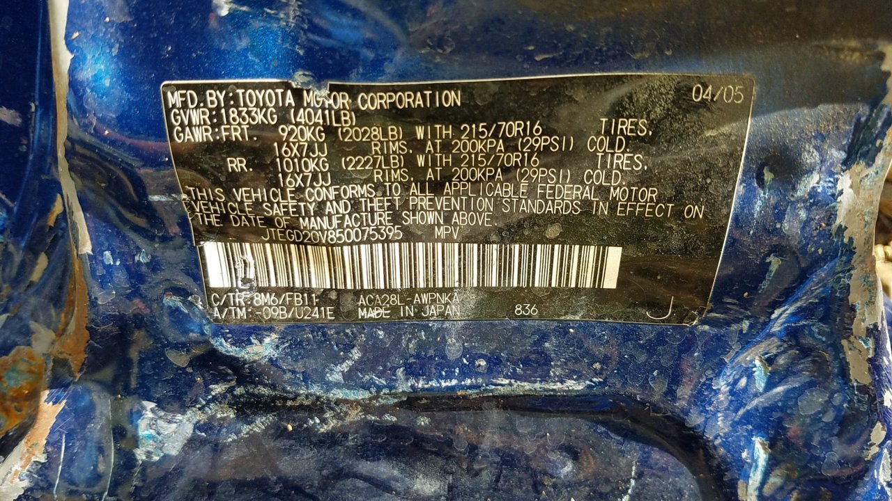

    Where can you find your paint code to get an exact match?

    Drivers door jamb .Decal with serial # production etc.
    Something like this . Pic from my rav4 . Just needed minor touch up lol.
