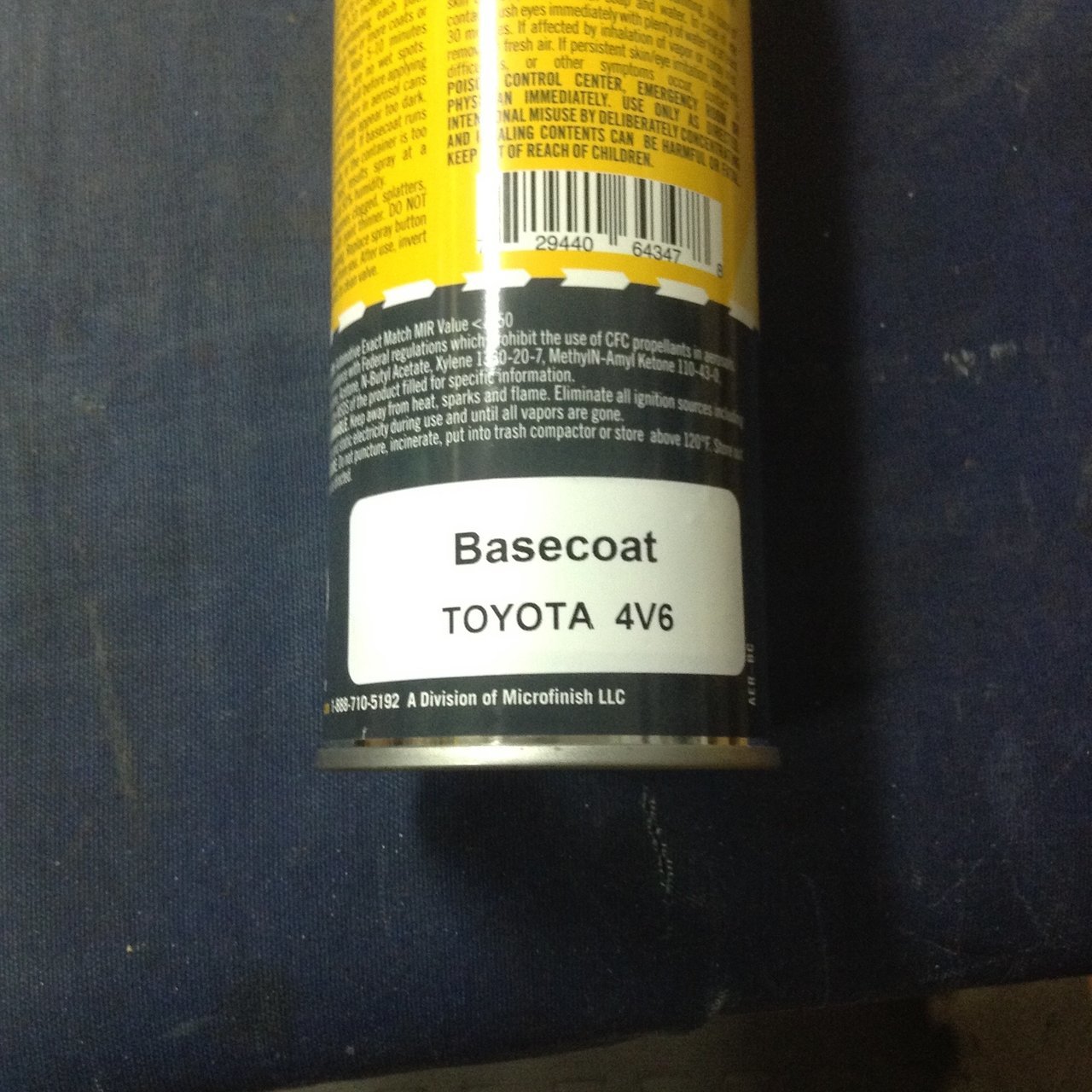

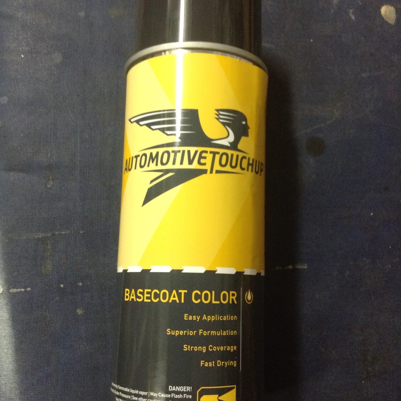

    Don’t use the brush that comes in the tubes! It’s huge and will dump way too much paint. The code pictured is for quicksand.

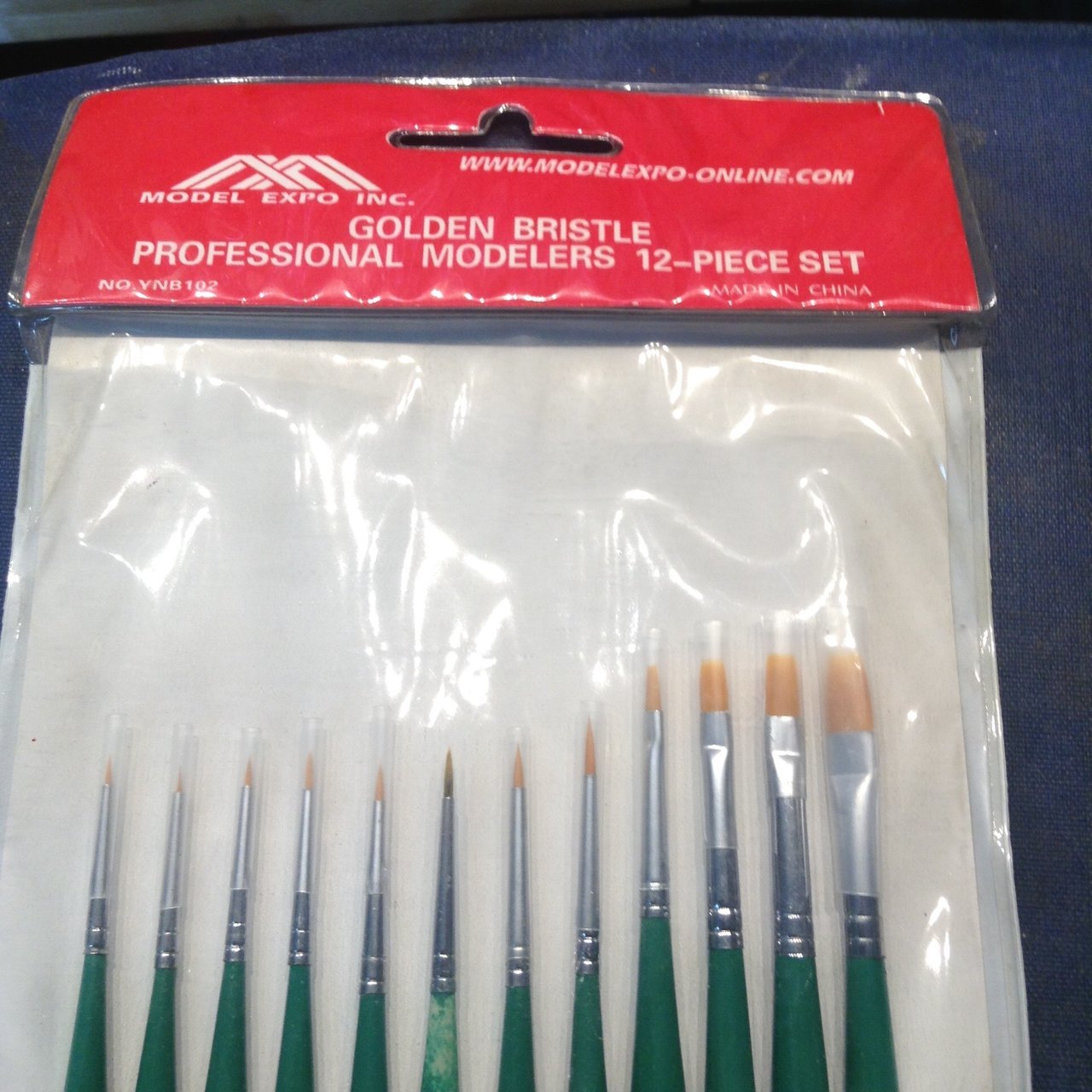

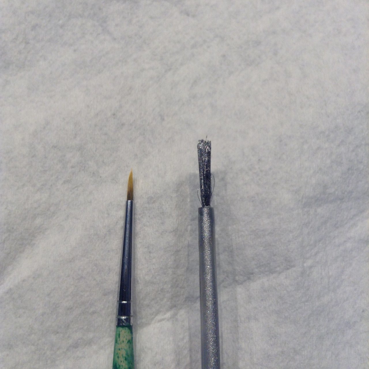

    Still way to big for most chips. Check out the size of brush I use compared to the tube brush.
