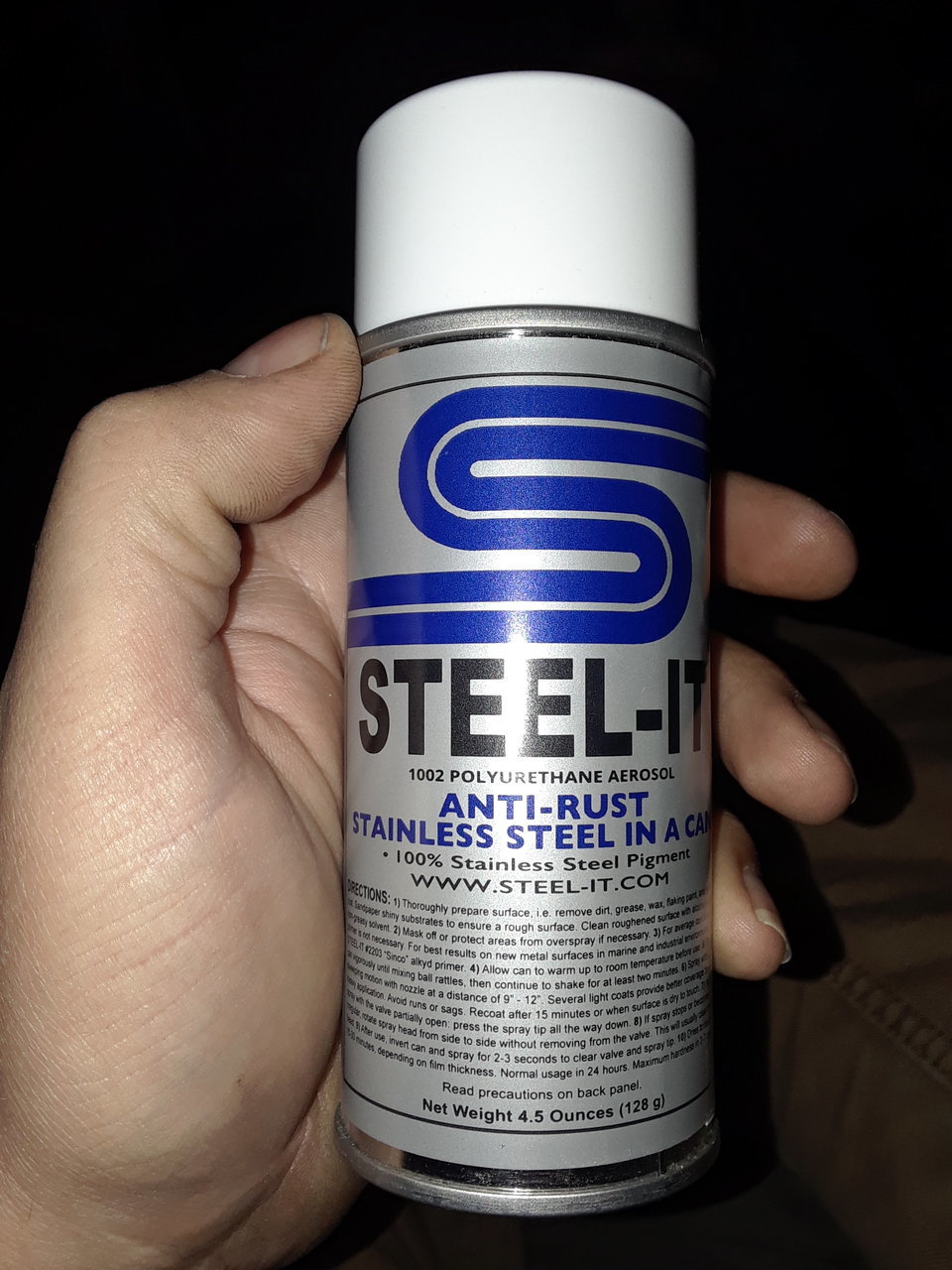

    15138892211081710254410.jpg just got a free sample of this. Going to try it on my sliders. Supposedly you can weld thru it too. Developed for Baja racers..

    You gonna paint the entire things that color?

    It comes in different colors..check the website. I've got a silver truck so they're getting sprayed black
