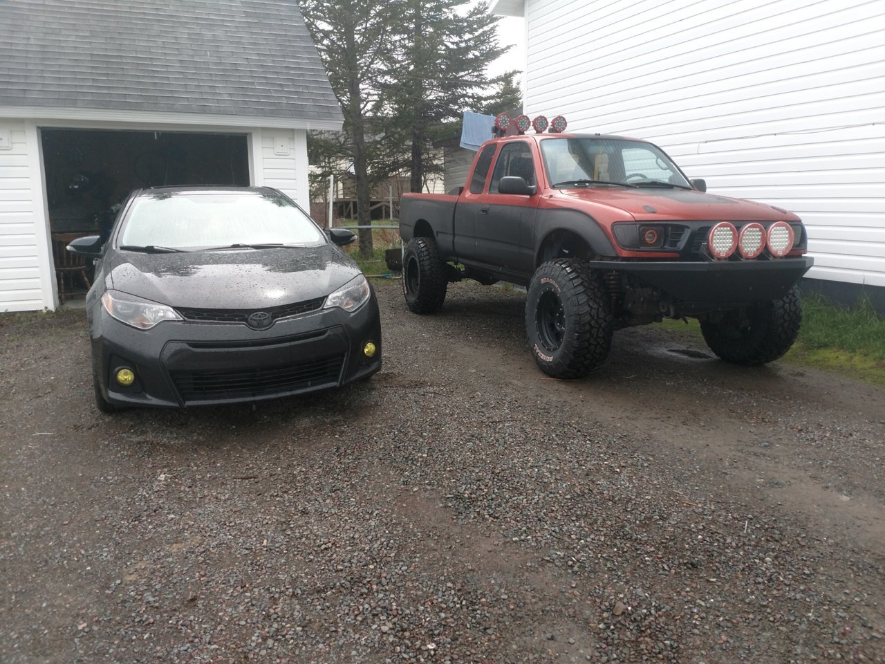

    i bedlined just the lower half.

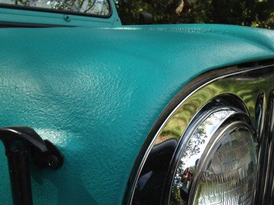

    Well, that's mean. One of the features they push about the monstaliner is that it doesn't have as bad of a textured appearance. 2013-05-25_14-10-01_139.jpgpretty much the scheme I'm looking for....

    And all things considered, I'm looking for the most durable paint job. A type of liner seems to fit the bill.
