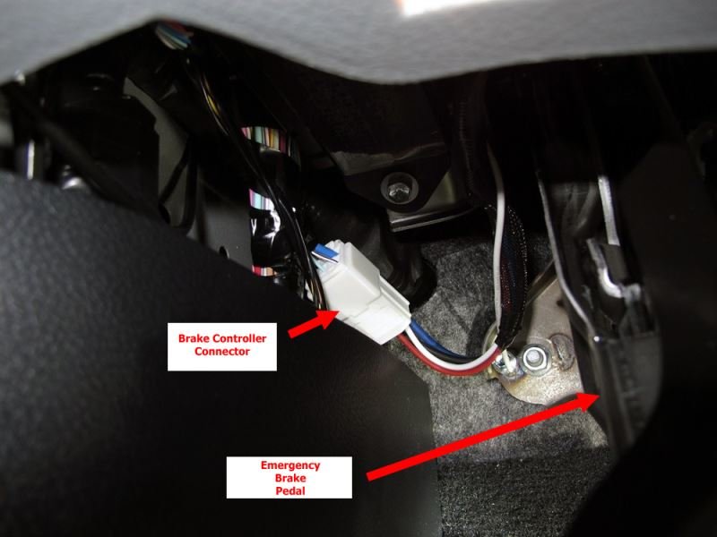

    The pigtail connector for the brake controller (if you have it) would be behind the driver side kick panel.
    Should look something like this (the one in this photo has a controller plugged into it, so you’re looking for just the left half back behind there)
