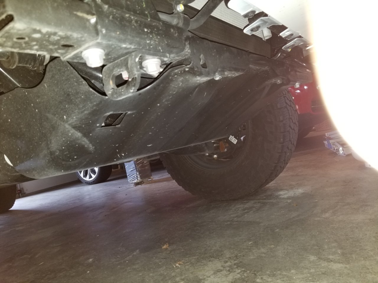

  13. Apr 4, 2018 at 12:58 PM
    tomgru
    tomgru Well-Known Member
    Oct 3, 2017
    #231939
    742
    Thomas
    PNW
    2021 TRD Pro
    i'm probably totally wrong here... but i though the loop was on the drivers side. i'm talking about this point on the passenger side.
  14. Apr 4, 2018 at 1:22 PM
    EatSleepTacos
    Mar 24, 2015
    #151688
    59,654
    Randy
    West Valley, AZ
    2017 4Runner
    Neither loop is really meant to be a recovery point for difficult situations (i.e. stuck as fuck off road) but for something easier such as getting pulled out of snow then it’s just fine.

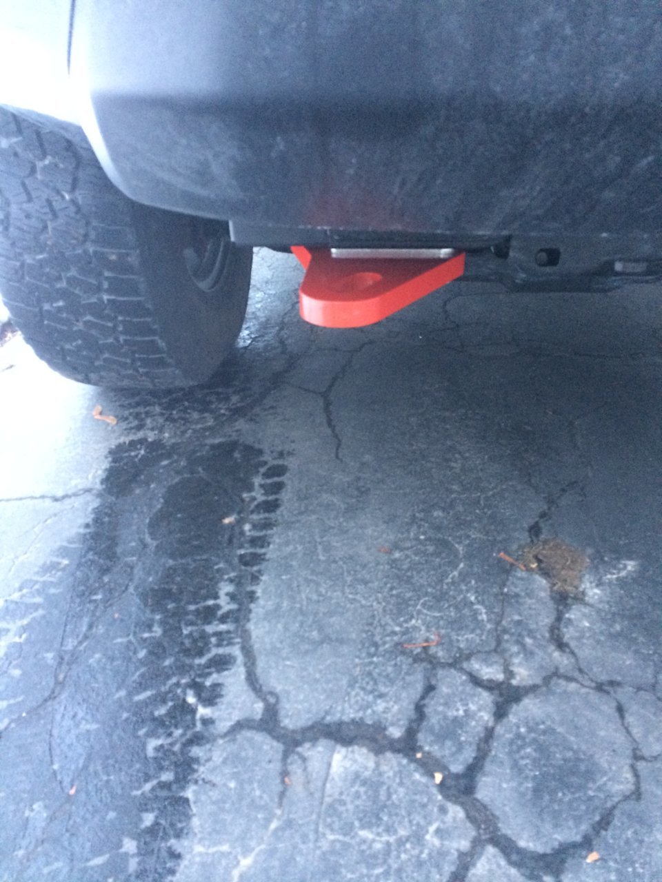

  16. Apr 4, 2018 at 1:49 PM
    #16
    RocTaco
    RocTaco Free stun!
    Nov 12, 2016
    #202199
    2,040
    Pete
    Green Mtns
    03' Reg. Cab 4x4 5MT
    If you REALLY want something solid on the front, go with thisIMG_0531.jpgARB recovery point, rated at 17,500 lbs. Definitely more expensive than the other options, but your truck will rip in half before you break this thing.

  18. Apr 4, 2018 at 2:01 PM
    #18
    PJnc284
    PJnc284 Well-Known Member
    Mar 6, 2012
    #74326
    690
    Garner, NC
    2016 Tacoma TRD Off Road 4x4
    That's still more of a tie down. Below is the factory hook on my Off-Road but as mentioned before, either may work in a pinch but none are hardcore off road worthy. Granted most of those doing that probably have plate bumpers with built-in recovery points.
