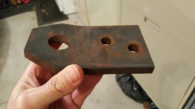

    Has anyone here tested the BPF skackle mount in a recovery situation? Im very curious to know how it holds up. Its only rated at 8200lbs...
  2. Apr 4, 2018 at 4:44 PM
    #42
    Joe23
    Joe23 Canuckistikian
    Oct 5, 2015
    #165909
    11,299
    The Great White North
    2017 TRD Off-road DCSB
    thats really not that much when you consider thats only about twice the weight of our trucks, and during a hard recovery the forces can be way more than that.

    My guess is that's just a random, conservative number that they threw out. There's no way that they actually went through testing like ARB did with theirs (I'm assuming they did). I just did some quick research to try and calculate the tensile strength but that shit's above my paygrade. Anyways, maybe people don't realize just how damn thick 1/2" steel is. It's BEEFY. There's no way that it's going to shear in half. The shackle or strap would be the point to fail. On my previous truck I had a 1/2" thick point that a member here used to make and it was solid to be recovered from.

    It's not so much the steel I would be concerned with but the bolts and the portion where those bolts go. It's not what I would call a beefy spot to tie into vs the way the ARB ties into the frame and was tested.

    @Joe23 i totally agree about the attachment points. I have this BPF shackle mount and x3 10.9 graded bolts. Its beefy, but seeing how extensive the ARB attachments are, Im far more convinced it would hold up better. Either way I think id be alright in a total pinch

    I'd be more concerned with repeated use as where that ties in could weaken and then bend leading to the bolts letting go or something along those lines.

    Maybe, but that's irrelevant when talking about the supposed rating on the BPF shackle. With upgraded bolts I highly doubt any harm would come to that area. If you're getting yanked hard enough to fuck it up, you're probably in deep shit and that's the least of your concerns.
    That was with the two factory supplied bolts.
    That's a good point to think about. But if you're getting stuck so often in deep shit that that becomes a concern, chances are you have a plate bumper with proper points. The BPF one is more for people who want a relatively stock truck that may do moderate trails and it won't see repeated use.

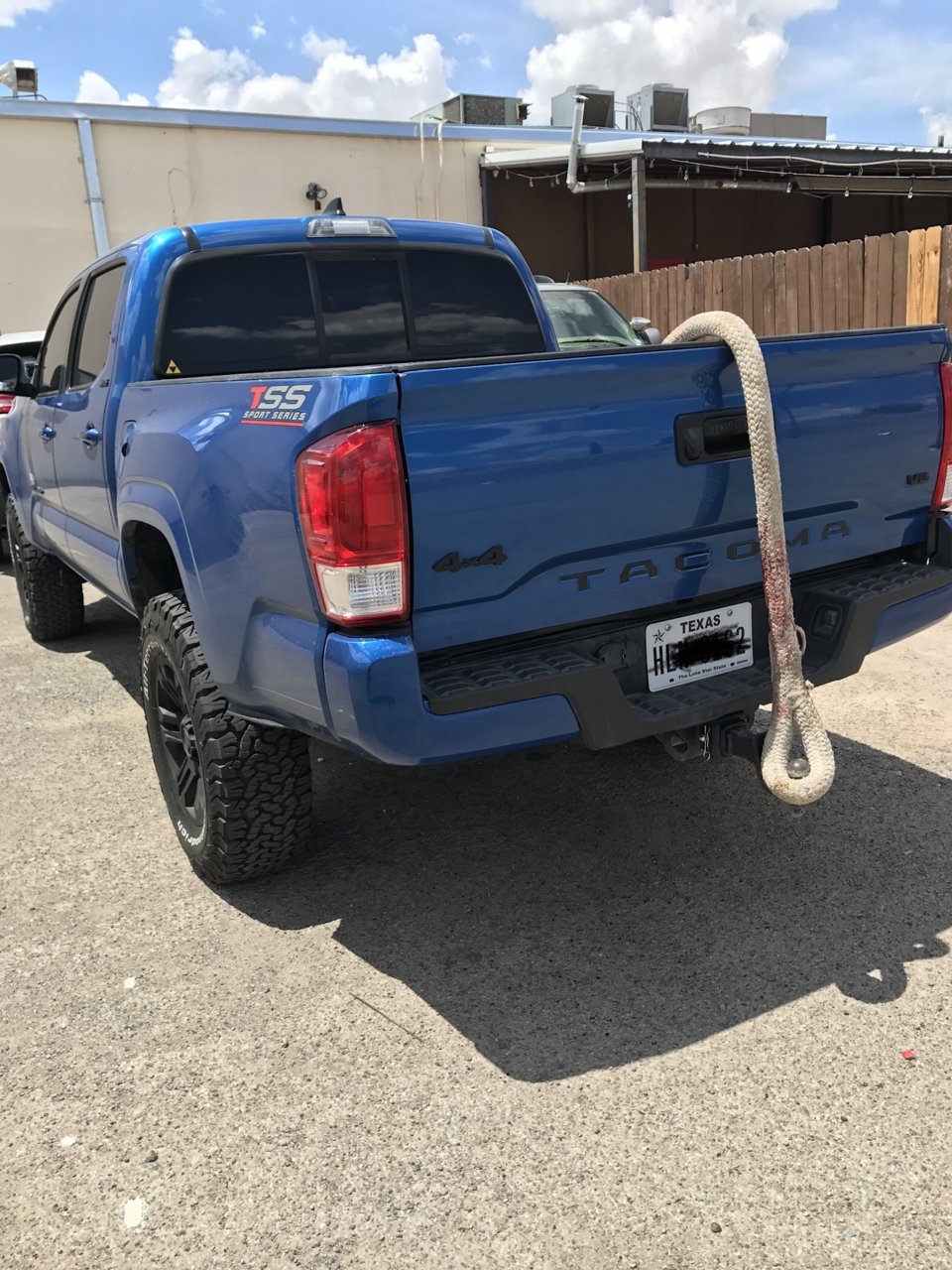

    Any experience with the bubba rope shackle?
    I have this huge kinetic recovery strap but there’s is no way to hook it to the front of the truck
  19. Apr 4, 2018 at 5:33 PM
    #59
    EatSleepTacos
    Mar 24, 2015
    #151688
    59,835
    Randy
    West Valley, AZ
    2017 4Runner
    One of my friends does and it's nice! Also I really hope you're not using that rope on the ball of the hitch. That's a no no
    Joe23 likes this.
